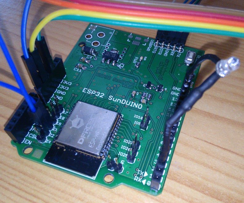

After soldering the board called ESP32 SunDuino, the board doesn't include non usual components, I had to find how to begin.

Step 5: Connecting to SunDuino
You connect the SunDuino ESP32 board to USB-UART converter with DTR, RST, TX, RX pins and power supply of course.
If the board is working you find out with easy example code - LED blinking. The LED will be blinking on 2th pin of SunDuino.
Interesting workaround of automatic run of bootloader is this circuit. The circuit uses only RST and DTR pins. The choice of N-channel MOSFET transistors is open, not strictly specified. I used e.g. 2N7002.
On the video you can see how to upload the code to ESP32 and then LED is blinking.
