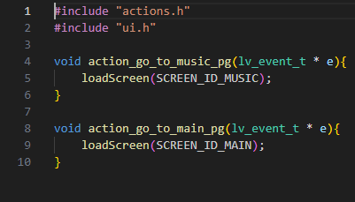

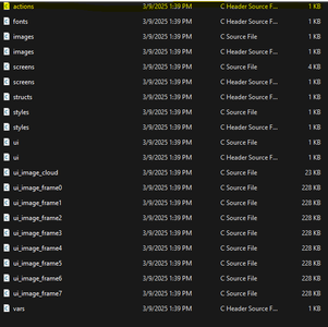

- Go to your ui folder. You should now see an actions.h file (Refer to Image 7)
- Open the actions.h file in your preferred text editor. VSCode, in my case. From the ui folder, also open the file screens.h.
- In the screens.h file, you should see the screen IDs. (Refer to Image 8)
- Create an actions.c file in the same ui folder and add the code lines shown in Image 9. It is also pasted below. (Refer to Image 9)
- You can get the event handler/action method name from the action header file. (Refer to Image 10)
(actions.c code)
#include "actions.h"
#include "ui.h"
void action_go_to_music_pg(lv_event_t * e){
loadScreen(SCREEN_ID_MUSIC);

- Open the actions.h and actions.c file again. The header file should have a lot more event functions now, and the .c file (the source file) should be the same as the previous step.
- Update actions.c file to now load the main screen (Refer to Image 5)
(Updated actions.c code)
#include "ui.h"
void action_go_to_main_pg(lv_event_t * e){
loadScreen(SCREEN_ID_MAIN);
(Changes have been bolded)
Copy and paste the ui folder in the libraries folder like before
Open the Arduino sketch again. I suggest you also keep the actions.h file to copy the events method signatures more easily
