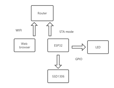

Step 2: Principle
2.1 The principle of ESP32 building a web server
After the ESP32 is connected to the wireless LAN through STA mode, ESP32 can obtain a local IP address. After opening the web server, Press the button of the webpage to send a different GET request, and the ESP32 Web server will respond after receiving the request by passing Html Strings to the client, these Html Strings will build the web page and present it to the client (browser).
  • Note that the ESP32 and the PC need to be in the same WIFI LAN.
2.2 OLED display LED status
ESP32 communicates with SSD1306 OLED through IIC protocol, which realizes master-slave communication with SSD1306 OLED, so as to display LED status through the screen.

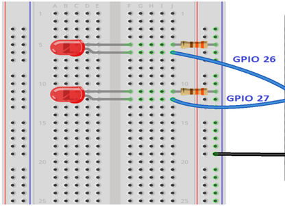

Step 3: Hardware Connection
  • GPIO26 and GPIO27 are connected to the positive pole of the LED and connected to the GND after passing through the 330Ω resistor.
  • ESP32 is connected to the computer by USB cable.
The LED lights and ESP32 wiring pins refer to below.
LED ----> MakePython ESP32
LED26+ ----> GPIO26
LED27+ ----> GPIO27
LED26-, LED27- ----> GND
Step 4: Software Workflow and Project Code
The workflow of the software is shown in the figure above.

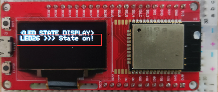

Test whether the web server is working normally, turn on and off the buttons corresponding to GPIO26 and GPIO27, observe the LED lights, and observe whether the SSD1306 OLED will display the status of the corresponding LED lights.
  • When you click the button to turn GPIO26 On, the LED26 light is on, and OLED display LED26>>> State on!
  • When you click the button to turn GPIO27 On, the LED27 light is on, and OLED display LED27>>> State on!
  • When you click the button to turn GPIO26 Off, the LED26 light is off, and OLED display LED26>>> State off!
  • When you click the button to turn GPIO27 Off, the LED27 light is off, and OLED display LED27>>> State off!
● After testing, the OLED will update the status of the corresponding LED after the switch button was pressed last time.
When you click the button to turn GPIO26 On, the ESP32 receives a request for the /26/on URL, when the ESP32 receives that request, it turns on the connection to GPIO26 and updates its state on the web page, for the SSD1306, The status of the LED will be displayed on the OLED, as shown in the red box in the screenshot below, and the same for GPIO27.
