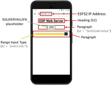

Creating the Web Page:
Now, let’s delve into creating the esp32 web server page.
The web page itself is straightforward, comprising a heading, a paragraph, and a range input element. The HTML content, along with included styles, is stored in the “index_html” variable.
To create a responsive web page, the following “meta” tag is included:
<meta name="viewport" content="width=device-width, initial-scale=1">
The page’s title is enclosed within the <title> tags:
<title>ESP Web Server</title>
Styles:
CSS styles are defined within the <style> tags to format the web page’s appearance.
html {font-family: Arial; display: inline-block; text-align: center;}
h2 {font-size: 2.3rem;}
p {font-size: 1.9rem;}
body {max-width: 400px; margin:0px auto; padding-bottom: 25px;}
.slider { -webkit-appearance: none; margin: 14px; width: 360px; height: 25px; background: #FFD65C;
outline: none; -webkit-transition: .2s; transition: opacity .2s;}
.slider::-webkit-slider-thumb {-webkit-appearance: none; appearance: none; width: 35px; height: 35px; background: #003249; cursor: pointer;}
.slider::-moz-range-thumb { width: 35px; height: 35px; background: #003249; cursor: pointer; }
The specified styles ensure that the HTML content is presented in a centered, block format, using Arial font. Additionally, the styling defines the appearance of the slider element.
HTML Body:
Within the <body> tags, the web page’s content is added.
<h2>ESP Web Server</h2>
<p><span id="textSliderValue">%SLIDERVALUE%</span></p>
<p><input type="range" onchange="updateSliderPWM(this)" id="pwmSlider" min="0" max="255" value="%SLIDERVALUE%" step="1" class="slider"></p>
This content comprises a heading, a paragraph displaying the current slider value, and a range input element. The %SLIDERVALUE% placeholder will be dynamically replaced by the actual slider value when the page is accessed.
JavaScript Addition:

Upon slider movement, the function retrieves the slider value, updates the displayed label, and sends an HTTP request to the ESP32.

Step 8: Web Server Demo:
To begin, launch a web browser and input the IP address of your ESP32. This action should bring up the web server interface, featuring the slider along with its current value.
Experiment with moving the slider, and take note of the ESP32’s built-in LED brightness. As you manipulate the slider, you will observe the LED’s brightness changing in response, both ascending and descending according to the slider’s movement.
