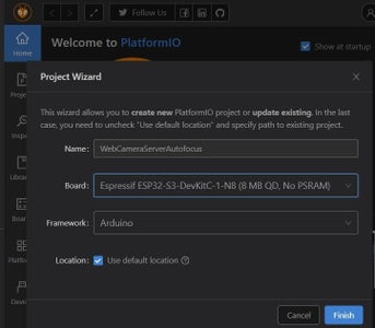

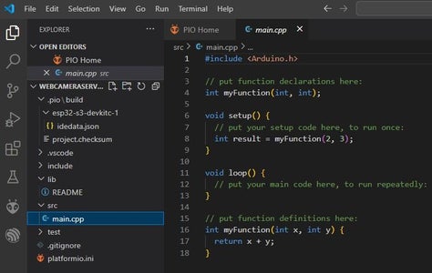

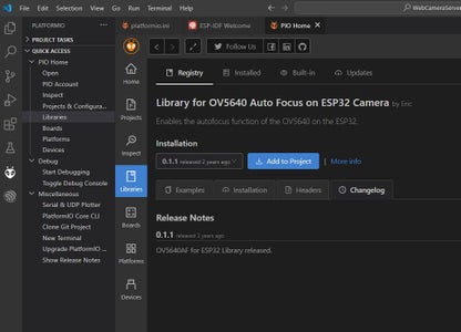

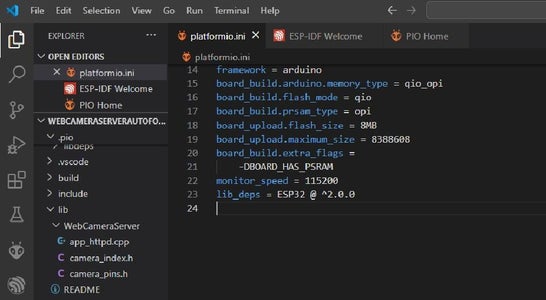

  • 3) Use Platformio to load and modify the "ESP32CameraWebserver" example to use an ESP32-S3-DevkitC-1-N8R8 and Adafruit OV5640 breakout board (with an autofocusing 72 degree camera) instead of the familiar AI-Thinker module that has an ESP32 with an OV2670 camera,and enabling the 8MB of PSram on our esp32-S3 board.

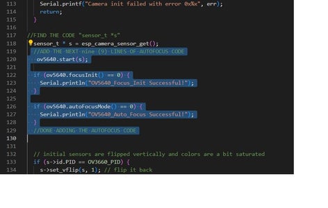

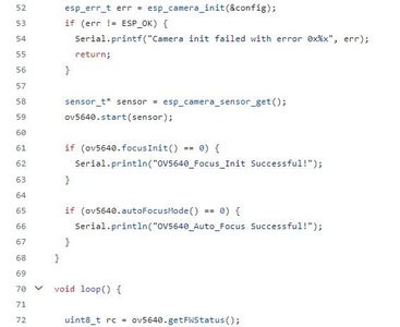

  • 4) Use Erik Nam's autofocus library for OV5640 cameras-with-autofocus to enable autofocus in our example
  • 5) Write up a tutorial on how to use Platformio

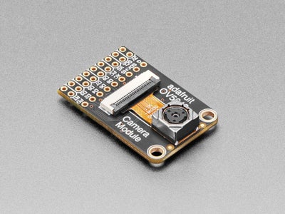

Adafruit came out with a breakout board for the OV5640 camera modules. The Adafruit OV5640 breakout board includes optional jumper settings for enabling both
  • a built-in internal clock (saves a pin on the ESP32 and provides stable 24MHz to the camera) and
  • enabling continuous autofocus. (SCORE!!!)
  • they even allow you to remove the camera and replace them with other OV5640 cameras with different features like wide angle lenses and autofocus cameras.

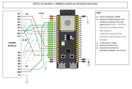

a) Enable autofocus and internal clock on the Adafruit OV5640 board,
b) Physically wire pins on the Adafruit OV5640 breakout board to an Esp32-S3-DevkitC-1-N8R8 (ESP32S3 board with 8MB of code and 8MB of external PSRAM),
c) create a pinout map for connecting our OV5640 breakout board to the ESP32-S3-DevkitC-1-n8r8 and porting it to our code instead of using the pinout maps for pre-existing esp32 camera modules such as an AI-Thinker board.
d) modify code in the pre-existing arduino esp32 "CameraWebServer" example project to enable us
  • connect to both the esp32-s3 and the adafruit esp32 breakout board (match pinouts, select board, enable PSRAM)
  • add Erik Nam's autofocus library to the project

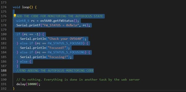

  • enable continuous autofocus

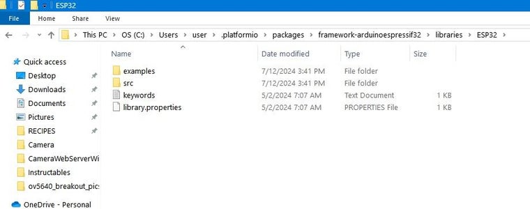

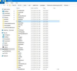

Github code to download: (download this and install in one of your coding directories, or make your own fork on github)
q) https://github.com/espressif/arduino-esp32
(includes the camera library and the camera webserver example we will modify to add autofocus and use the esp32-s3)
  • We want to open the example that is stored in the directory arduino-esp32-master\libraries\ESP32\examples\Camera\CameraWebServer
r) https://github.com/0015/ESP32-OV5640-AF/tree/main
(This is Eric Nam's library for enabling and using autofocus on autofocus enabled OV5640 cameras)

Read through the Adafruit OV5640 breakout documentation to get a good understanding of what we want our OV5640 to do, and what specific features of this breakout board we want to take advantage of.
For the Adafruit OV5640 breakout board, Adafruit has made a very good tutorial on how to use their board. Read the tutorial sections for

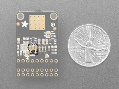

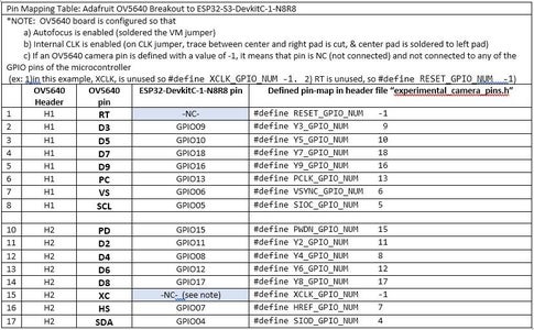

Looking at the section with the jumpers, we would like to enable the following features
a) USE INTERNAL CLOCK: Enabling the feature of the OV5640 breakout board will provide the camera with a stable 24MHz clock, and save a pin on the esp32. For the CLK pad, cut the trace from the "center pad" to the "external clock" pad, and put a solder blob to join the "center pad" to the "internal clock" pad
b) ENABLE AUTOFOCUS: Autofocus enabled cameras have a small Voice coil Motor (VM) to adjust the focus length of the camera. Enabling this feature provides power to the VM (Voice Motor) that is used in autofocusing cameras (enabling this feature has no effect on cameras that do not have autofocus).

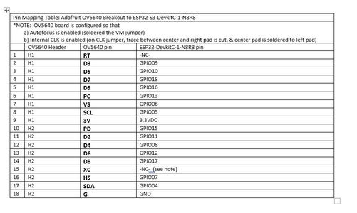

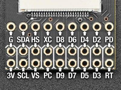

The different pins on the camera breakout board do different things. We do not need to detail what they do (please read the "Pinouts" section of the adafruit OV5640 tutorial. We just need to outline what pins we will connect to. Based on the "camera_pins.h" file used in our example (see https://github.com/espressif/arduino-esp32/blob/master/libraries/ESP32/examples/Camera/CameraWebServer/camera_pins.h)
We will name our pins, and show the way that each pin is named in the "camera_pins.h" file
Ex: the pin "XC" on the OV5640 breakout is named as "XCLK_GPIO_NUM" in the "camera_pins.h" file. So we will write
"1) XC (external clock) // #define XCLK_GPIO_NUM"
(Please note that different ESP32 camera boards use different pins to connect to the OV5640 camera, so the ESP32 IO pins used to connect to specific OV5640 pins differ for different ESP32 Camera boards, and the value of these ESP32 IO pins get defined differently for different boards. If a pin on the OV5640 is UNUSED, it is defined as "= -1")
The OV5640 has 18 pins total (including GND and 3.3V DC power).
We will ignore the two (2) pins
1) XC (external clock) // (#define XCLK_GPIO_NUM =-1)
2) RT (Reset) //(#define RESET_GPIO_NUM = -1)
We will use the following sixteen (16) pins on the OV5640 board
3) PD (Power Down) //(#define PWDN_GPIO_NUM)
4) SDA(I2C Serial Data) //(#define SIOD_GPIO_NUM)
5) SCL (I2C serial clock) //(#define SIOC_GPIO_NUM)
6) D9 (D9) //(#define Y9_GPIO_NUM)
7) D8 (D8) //(#define Y8_GPIO_NUM)
8) D7 (D7) //(#define Y7_GPIO_NUM)
9) D6 (D6) //(#define Y6_GPIO_NUM)
10) D5 (D5) //(#define Y5_GPIO_NUM)
11) D4 (D4) //(#define Y4_GPIO_NUM)
12) D3 (D3) //(#define Y3_GPIO_NUM)
13) D2 (D2) //(#define Y2_GPIO_NUM)
14) VS (Vertical Synch) //(#define VSYNC_GPIO_NUM)
15) HS (Horizontal Synch) //(#define HREF_GPIO_NUM)
16) PC (Pixel Clock) //(#define PCLK_GPIO_NUM)
17) G (Ground)
18) 3V (3.3V DC power)

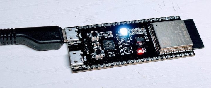

Step 2: Read the Documentation and Pinout for the ESP32DevkitC-1-N8R8
Please read the documentation for the ESP32-S3-Devkit1 here at https://docs.espressif.com/projects/esp-idf/en/stable/esp32s3/hw-reference/esp32s3/user-guide-devkitc-1.html. If you download the page as a PDF (see the attached PDF file), then read through pages 1-20 (I cannot attch the PDF file to this instructable, because it exceeds the size limit for allowable attachments.).
The ESP32-S3-DevkitC-1 is a type of development board from Espressif for enabling users to work with the ESP32-S3-WROOM microcontrollers. It provides WIFI interfacing, bluetooth wireless interfacing, and serial and USB interfaces as well as exposing most of the pins on the microcontroller. These things are awesome.
(NOTE!!!! just because a pin on the ESP32 is EXPOSED, that doesn't mean that the pin is useable in a specific project or USEABLE AT ALL... please make note of STRAPPING PINS, and pins used to access PSRAM).
The ESP32-S3-DevkitC-1-N8R8 is a version of the ESP32-S3-DevkitC-1 with additional program memory (N8 = 8MB of program memory instead of 520K), and 8MB of external ram (PSRAM) that the ESP32-S3-WROOM has to connect

Step 3: Prepping the Adafruit OV5640 Board (jumpers and Terminal Blocks)
In this step we will take our OV5640 breakout board and do the following
a) enable the internal 24MHz clock (saves a pin on our ESP32 and provides a reliable CLK to our camera)
b) enable autofocus

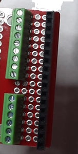

c) Solder 0.1" pitch terminal blocks to our OV5640 to ensure we have a reliable connection to our wires
Tools:
1) Soldering iron/solder/flux & soldering tools
2) exacto knife (to cut trace)
Parts:
3) 0.1" terminal blocks (enough to make two (2) rows of 9-pin headers)
4) Adafruit OV5640 board
Steps:

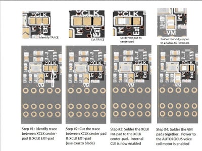

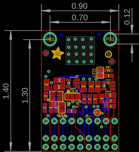

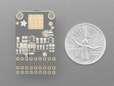

1) On the OV5640 breakout, find the XCLK jumper, and identify the small trace between the XCLK:center-pad & XCLK:Ext pad (the one on the right)
2) Cut the trace with an exacto blade (scrape the thin connection away. You can trust your eyes or use a digital multimeter to verify the trace has been correctly cut)
3) Solder together the XCLK:Center-pad and the XCLK:Int-pad (the one on the left). The internal 24MHz clock is now enabled
4) Find the VM jumper, and solder the two pads together. You are now able to provide power to the Voice Coil Motor of an OV5640 with Autofocus (does not affect OV5640 cameras without autofocus).
5) We define "Right-side-up" on the OV5640 breakout as the side with the camera on top. Find the row of pins that include SDA / HS/ XC / D8 / D6 / D4 / D2 / PD. We will call this header #1. Solder the terminal blocks to this row right-side up.
6) We define "Upside-down" on the OV5640 breakout as being the other side of the board that does NOT have the camera. Find the row with SCL / VS / PC / D9 / D7 / D5 / D3 / RT. This is header #2. Insert and solder the terminal blocks into this row on the underside of the board. Now header #1 is on the top side of the board, and Header #2 is on the bottom side of the board.
Now all wires can be inserted into screw terminals, and attached securely, and both internal clock and autofocus are enabled.
Step 4: Helper Board: Camera Mount
With terminal blocks installed, any wired connections are very secure but a downside is that the board will not lie flat. It is convenient to have a mounting board to hold the OV5640 in place onto our breadboard. One that uses the mounting holes on the OV5640 breakout, and which can be plugged physically into a breadboard as a physical mount while experimenting and breadboarding.
A standard breadboard has a pitch of 0.1" between pins. Each rows on a breadboard has five (5) pins connected together internally, then a 0.3" gap, then another row of five (5) pins connected internally.
This is a set of instructions for making a camera mount to hold the OV5640 breakout board and physically mount it on a breadboard. The pin headers are spaced so that the board can be inserted in one of four angles in the breadboard

Step 5: Helper Board: Terminal Block Array for ESP32-S3
This is another helper board to make wiring more secure (I've had some pretty nasty failures due to suddenly detached wires in a breadboard). It is a piece of breadboard-protoboard that has ben cut in half, and has had terminal blocks and arduino stackable pin headers attached. Now wires will be securely held, and pins can be tested at will.
Materials:
a) mini breadboard prototyping board 1.3" x 1.8" (cut in half to make two (2) 17-row boards)
b) Male header (Enough for a row of seventeen (17)). (trim down to 17-pins), or use a singlerow of nine (9) & a single row of six (6)
c) 0.1" pitch terminal blocks (enough for a row of nine(9), and a row of six (6))
Tools:
a) Hacksaw
b) Soldering iron / flux / solder / tools
c) flush cutter (to trim down rows of pin headers)
Steps:
1) Take the mini breadboard-prototyping-board (1.3" x 1.8", and cut it in half down the middle (so you have two (2) 0.65" x 1.8" boards.
2) Solder in the 17-pin header into the breadboard along one edge. This is the right side of the board.
3) Since the board will be mounted on the left side of the ESP32-S3-DevkitC-1-N8R8, we will make a row of six (6) terminal blocks on the bottom-left of the board (For GPIO09 (D3) / GPIO10(D5) / GPIO11(D2) / GPIO12(D6) / GPIO13 (PC) & GPIO14 (not connected to OV5640). Label each terminal block IO point with a fine point sharpie.
4) We will add on the top-left part of the board a row of 9-pin terminal blocks (For GPIO04(SD) / GPIO05(SC) / GPIO06(VS) / GPIO07(HS) / GPIO15(PD) / GPIO16(D9) / GPIO17(D8) / GPIO18(D7) / GPIO08(D4). Label each terminal block IO point with a fine tip sharpie.
5) Plug the terminal block array next to the correct pins on the ESP32-S3-DevkitC-1-N8R8
Step 6: Physically Wiring Our ESP32-S3-DevkitC-1-N8R8 to Our Adafruit OV5640 Breakout Board
In our demonstration circuit, the pins on our ESP32-S3-DevkitC-1-N8R8 are wired to the Adafruit OV5640 breakout board. We use the helper boards to mount the camera and make it easier to wire the OV5640 breakout to the OV5640-S3-DevkitC-1-N8R8.
BOM:
a) Breadboard (minimum of two rows of breadboards)
b) assorted wires
c) ESP32-S3-DevkitC-1-N8R8
d) Adafruit OV5640 camera breakout (with terminal blocks and with internal XCLK and Autofocus enabled)
e) Mounting board for the OV5640 breakout board (optional but useful)
f) Terminal block Array (optional but useful)
g) 3.3VDC power supply (in this case a breadboard power supply set up to provide 3.3VDC, with a 12VDC wall-wart)
h) Label and sharpie to mark the board and identify the project being used on the breadboard. (a good habit)
PIN CONNECTIONS:
OV5640 pinESP32-DevkitC-1-N8R8 pin
1) RT -NC-
2) D3 GPIO09
3) D5 GPIO10
4) D7 GPIO18
5) D9 GPIO16
6) PC GPIO13
7) VS GPIO06
8) SCL GPIO05
9) 3V 3.3VDC
10) PD GPIO15
11) D2 GPIO11
12) D4 GPIO08
13) D6 GPIO12
14) D8 GPIO17
15) XC -NC-
16) HS GPIO07
17) SDA GPIO04
18) G GND

Step #1) Open "Visual Studio Code" -> Go to "Platformio" -> Click "Create New Project"
Step #2) In the dialog box that pops up, select the following options
  • a) For Project Name: I wrote "CameraWebServerAutofocus"
  • b) For Board: Select "Espressif Esp32-S3-DevkitC-1-N8" (we add PSRAM later)
  • c) For Framework: Select Arduino
  • d) For Save Location: I used the default Platformio Project directory that I have set up on my computer.
In my case, my whole project "CameraWebServerAutofocus" is now saved in the directory
  • "C:\Users\user\Documents\PlatformIO\Projects\WebCameraServerAutofocus"
Step #3) The project has been created. The board our project uses is the Espressif Esp32-S3-DevkitC-1-N8, but we have also not yet intiated PSRAM. We have also not yet configured the Platformio monitor to use a baud rate of 115200 baud when monitoring the COM port. We will enable these features now.
a) Go to the Project Explorer section, find "platformio.ini" and open it.
b) Now add the following lines below after the settings already in the platformio.ini file to enable both flash memory and set the speed of the serial monitor
board_build.arduino.memory_type = qio_opi
board_build.flash_mode = qio    ; QIO is the type of flash memory used
board_build.prsam_type = opi    ; The PSRAM on the board uses Octal Psram
board_upload.flash_size = 8MB   ; Flash memory is defined as being 8 MB
board_upload.maximum_size = 8388608
board_build.extra_flags =
 -DBOARD_HAS_PSRAM     ; This tells the board that it has PSRAM (we don't need to define toal PSRAM size)
; add this to set the speed of the COM monitor port to 115200 baud
monitor_speed = 115200
Special thanks to user "Sivar2311" for his post on the Platformio Community Forum on enabling PSRAM and Flash memory from within the "Platformio.ini" file
;https://community.platformio.org/t/how-do-you-set-up-a-new-board-esp32-s3-n16r8/32306/25
I have attached my current (As of this current step) "platformio.ini" as a text file (because Instructables does not let us upload ".ini" files, just rename it if you use it). The "platformio.ini" file will change as we add our libraries and their dependencies.

Now we will select a library ("ESP32by Hristo Gochkov") and look at some of the code examples provided with the library and the platformio.ini settings that it will could add to our project. We will look at the "CameraWebServer" example file included with the "ESP32" library. Please not that the examples included in this library are the exact same example that are able to be browsed with the Arduino IDE (which is why they are listed as .ino files even though Platformio does not use arduino style ".ino" files and needs them renamed to ".cpp")
Goto "Libraries", select the tab: "built-in", and in the search-bar type "Esp32". Select the library "Esp32 by Hristo Gochkov"
The new windows that pops up says the name of the library selected and has four (4) tabs
a) Tab: "Examples"(*1): (allows users to
  • select examples related to the selected library
  • browse the files used in a selected example
b)Tab: "Installation": (Lists the necessary library dependencies in platformio.ini for the selected example)
c) Tab: "Headers": (Lists headers used in an example)
d) Tab: "Changelog" : (displays the changelog for the selected code example)
(Note *1): If an example is selected, and you want to include the files from the example in your code, it is not possible to do that through the Platformio browser. Instead, when selecting the library for use in the file, click on the "reveal" button to open a file-explorer window to the installation directory of the library, and then from threre to go into the directory storing your desired example and copy the files you want and paste them into your specified project directories in your project.
Step 10: Use the Platformio Library Manager to Include the Espressif Camera Library Example Files
Goal:
  • Find and copy the exmple code from the "CameraWebServer" example in the locally installed "Espressif - arduino Framework" code repository into our project. The "CameraWebServer.ino" file will be renamed to "CameraWebserver.cpp".
  • Update the Platformio.ini file to include our necessary library dependencies.
NOTES:
Our project will use the "WebCameraServer" example as its base, and add a few lines of extra code to enable autofocus.
Steps:
Step #1) remove the current "main.cpp" (the one created at default when our project was first created) from our project source directory
Step #2) create in our project ("CameraWebServerAutofocus") library-folder a sub-folder called "CameraWebServer"
Step #3) Using the Platformio library manager, select the TAB "built-in", and search for the library "ESP32 by Hristo Gochkov". Use the "reveal" button to have file-manager open to the --BASE-- directory where the "ESP32" library is stored. (In our case our --BASE-- directory was C:\Users\user\.platformio\packages\framework-arduinoespressif32\libraries)
Step #4) Navigate from the --BASE-- directory to the example folder to the folder holding the files for "CameraWebServer". (In our case, this was the directory C:\Users\user\.platformio\packages\framework-arduinoespressif32\libraries\ESP32\examples\Camera\CameraWebServer)
e) Use copy-paste to copy the four files "app_httpd.cpp", "CameraWebServer.ino", "camera_pins.h", "camera_index.h" into our project library subdirectory "CameraWebServer".
f) Select the file "CameraWebServer.ino" and move it into the project src directory. Given that Platformio does not recognize ".ino" files, rename "CameraWebServer.ino" to "CameraWebServer.cpp"
g) If you used the Platformio Library manager to look at the ESP32 example code for "CameraWebServer", then in the tab "installation", you can see the lib_deps for "CameraWebServer".
g) As a final step, open up the "platformio.ini" file for our project and copy into it the line
lib_deps =  ESP32 @ ^2.0.0
Step 11: Use the Platformio Library Manager to Download and Install the Autofocus Library
Goal:
  • Use the Platformio Library manager to search the Platformio online code repository for Eric Nam's "Autofocus" library.
  • Use the Library manager to install the library "Autofocus by Eric Nam" into our project and automatically update our project's platformio.ini to include the necessary lib_deps
NOTES:
The ability of the PlatformIO Library manager to let us browse through a large online code repository, and then seamlessly install or uninstall libraries (including updating our platformio.ini file) is great. We will use it to add the "Autofocus by Eric Nam" library into our project.
Steps:
Step #1) Goto the Platformio Library manager, select the TAB: "Registry", and type in the search-bar "Autofocus"
Step #2) Select the "Library for OV5640 Autofocus by Eric"
Step #3) Click on the "Install Library" button
Step #4) Select our project "CameraWebServerAutofocus", and install the Autofocus library into our project.
You can now use the Vistual Studio Code Explorer to look at our project, and see that our Autofocus library was added to our project in the "Build"->"Lib_deps" directory, and the platformio.ini file has been automatically updated with the lib_deps for the Autofocus library.
Step 12: Creating Our Pin-mapping Header File "Experimental_Camera_Pins.h"
Goal:
  • Create a header file that specifies how our GPIO pins on the ESP32-S3-DevkitC-1-N8R8 map to the OV5640 breakout board.
  • Modify the header file "camera_pins.h" to include a conditional #include of "Experimental_Camera_pins.h"
NOTES:
When a microcontroller board with a built-in camera (like an ESP32 AI-Thinker or an ESP32-S3-Freenove ) is produced, every single board of that type will consistently map the GPIO pins of the microcontroller to the pins of the OV5640 in the exact same way. The AI-Thinker board will have a different pin-map than the ESP32-S3-Freenove, but all AI-Thinkers use the same pin-map between the GPIO pins of the microcontroller and the pins of the camera. The header file 'camera_pins.h" has definitions of pin-maps for many different types of ESP32 camera boards, that is defined in a way that can be consistently used by the camera library. Simply define which board you are using, and if the board is already in "camera_pins.h" then up to sixteen (16) pins on the board will be defined in order to map to the camera.
This works out well when you have a board that is manufactured consistently, but when you are using a breakout board for a camera such as an Adafruit OV5640 breakout and prototyping with different types of pinouts then you have to write your own pin-map that is consistent with the camera library. Other camera module boards may be designed with specific design goals. In our case our board was wired in a way that was convenient to breadboard, and does not match the pin-map of any camera module on the market.
There are several ways to create the pin-map
a) you can define the variables in the same file as your main() function
b) you can alter "camera_pins.h" to include a pin-map for your breakout board (just be consistent with how you wired the parts together)
c) you can create an external header file that defines the pin-map (ex: "experimental_camera_pins.h") to use with experimental boards that only needs to be included when using camera breakout boards.
We will use option C, and define a new header file for mapping pins to breakout boards.
Steps:
Step#1) Open in your project "camera_pins.h" and find the last three (3)lines at the end of the file
#else
#error "Camera model not selected"
#endif
(this block of code means that no camera board was defined, so there is no pin-map defined)
Step #2) Add the following two lines to our own definition for Experimental_Camera_Pins.h into "camera_pins.h" before #else #error
//Adding our own definition for Experimental_Camera_Pins.h
#elif defined(EXPERIMENTAL_CAMERA_PINS)
#include "experimental_camera_pins.h"
#else
#endif
Now, if your code has "EXPERIMENTAL_CAMERA_PINS" defined, then we will use the pin-map in "experimental_camera_pins.h"
Step #3) In our library directory "Lib->CameraWebServer", create a new header file "experimental_camera_pins.h"
Add the following lines into "experimental_camera_pins.h" (the code below is the complete header file for "experimental_camera_pins.h")
//Pins defined by users using OV5640 breakout boards or other boards
//Change pin-map to match your project.
#if defined(EXPERIMENTAL_CAMERA_PINS)
       //Define the pin-map for the following sixteen (16) pins
#define RESET_GPIO_NUM   -1  //  -1 Only if not using reset
#define Y3_GPIO_NUM       9
#define Y5_GPIO_NUM      10
#define Y7_GPIO_NUM      18
#define Y9_GPIO_NUM      16
#define PCLK_GPIO_NUM    13
#define VSYNC_GPIO_NUM   6
#define SIOC_GPIO_NUM    5
#define PWDN_GPIO_NUM    15
#define Y2_GPIO_NUM      11
#define Y4_GPIO_NUM      8
#define Y6_GPIO_NUM      12
#define Y8_GPIO_NUM      17
#define XCLK_GPIO_NUM    -1  //-1 Only if using a breakout that provides an internal camera clock
#define HREF_GPIO_NUM    7
#define SIOD_GPIO_NUM    4
#endif

Now this block of code will define our pin-map using the definitions in the header file "experimental_camera_pins.h"
// Select camera model
//#define CAMERA_MODEL_WROVER_KIT // Has PSRAM
//#define CAMERA_MODEL_ESP_EYE // Has PSRAM
//#define CAMERA_MODEL_ESP32S3_EYE // Has PSRAM
//#define CAMERA_MODEL_M5STACK_PSRAM // Has PSRAM
//#define CAMERA_MODEL_M5STACK_V2_PSRAM // M5Camera version B Has PSRAM
//#define CAMERA_MODEL_M5STACK_WIDE // Has PSRAM
//#define CAMERA_MODEL_M5STACK_ESP32CAM // No PSRAM
//#define CAMERA_MODEL_M5STACK_UNITCAM // No PSRAM
//#define CAMERA_MODEL_AI_THINKER // Has PSRAM
//#define CAMERA_MODEL_TTGO_T_JOURNAL // No PSRAM
//#define CAMERA_MODEL_XIAO_ESP32S3 // Has PSRAM
// ** Espressif Internal Boards **
//#define CAMERA_MODEL_ESP32_CAM_BOARD
//#define CAMERA_MODEL_ESP32S2_CAM_BOARD
//#define CAMERA_MODEL_ESP32S3_CAM_LCD
//#define CAMERA_MODEL_DFRobot_FireBeetle2_ESP32S3 // Has PSRAM
//#define CAMERA_MODEL_DFRobot_Romeo_ESP32S3 // Has PSRAM
#define EXPERIMENTAL_CAMERA_PINS
#include "camera_pins.h"

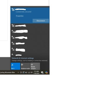

  • sometime the available network only operates in the 4GHz or 5GHz bands which the wifi radio-networking-hardware in the ESP32-S3 cannot use..
Here is a tutorial for setting up a wifi hotspot on windows

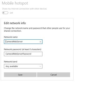

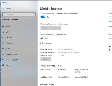

Step #1) Get the ssid (network name), and the password for the local wireless network. For this example, instead of using my local ssid and password, I set up a temporary local wifi hotspot "WebCameraServer", with the password "WebCameraServerPassword" on my laptop.
I went to my network settings->mobile hotspot. I right-mouse-clicked on it to go to hotspot settings.
  • changed hotspot network name to "CameraWebServer",
  • set hotspot password to "CameraWebServerPassword", and
  • set network hotspot Bandwidth to 2.4GHz.

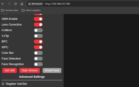

Step #6) Turn on the PlatformIO serial monitor to see the IP address (--IPADDR--) that the network DHCP server assigned to the microcontroller, or use the Wifi Hotspot dialog box to see the IP address and MAC number of the devices attached to the WIFI Hotspot. Record the currently assigned IP address (if the IP is not set as static, then it will likely change each time it connects to the network).
Step #7) Enter the IP address into a web browser and hit enter. Press the button marked "Start Streaming" to start getting images from the camera. Play with the screen resolution to see how the screen type affects both the resolution and the framerate of the camera. Play with other settings as well.
The attached video shows the camera (WITHOUT AUTOFOCUS) being tested from 1" away to 4" away from the camera at a screen resolution of UXGA(1200x1600)
https://youtu.be/xbaTaryeMDY
Step 14: Adding Autofocus Code to CameraWebServer.cpp, Then Build, Upload and Test
Goal:
  • Add the autofocus code to the "CameraWebServer.cpp"
  • build / upload / test the firmware
NOTES:
We will add the code to "CameraWebServer.cpp" to enable autofocus. The autofocus code is taken from Eric Nam's Autofocus example code.
Steps:
Step #1) Open "CameraWebServer.cpp" and add the line #include "ESP32_OV5640_AF.h"
#include "esp_camera.h"
//ADD AUTOFOCUS HEADER FILE
#include "ESP32_OV5640_AF.h"  //Autofocus library
#include <WiFi.h>
// WARNING!!! PSRAM IC required for UXGA resolution and high JPEG quality
//            Ensure ESP32 Wrover Module or other board with PSRAM is selected
//            Partial images will be transmitted if image exceeds buffer size
Step #2) Add the Autofocus object to the code by adding the line OV5640 ov5640 = OV5640()
void startCameraServer();
void setupLedFlash(int pin);
//ADD AUTOFOCUS OBJECT HERE
OV5640 ov5640 = OV5640();  //ADD the OV5640 autofocus object
void setup() {
  Serial.begin(115200);
Step #3) Find the line sensor_t *s = esp_camera_sensor_get(); and add the code below to pass the reference of the sensor_t object to the autofocus object, then call the three (3) OV5640 member functions
  • "OV5640.start()" ,
  • "OV5640.focusInit()",
  • "OV5640.AutoFocusMode()".
//FIND THE CODE "sensor_t *s"
  sensor_t * s = esp_camera_sensor_get();
  //ADD THE NEXT nine (9) LINES OF AUTOFOCUS CODE
   ov5640.start(s);
  if (ov5640.focusInit() == 0) {
    Serial.println("OV5640_Focus_Init Successful!");
  if (ov5640.autoFocusMode() == 0) {
    Serial.println("OV5640_Auto_Focus Successful!");
  //DONE ADDING THE AUTOFOCUS CODE
Step #4) In the main loop add the following code to monitor the state of the autofocus camera
//ADD THE CODE FOR MONITORING THE AUTOFOCUS STATE
  uint8_t rc = ov5640.getFWStatus();
  Serial.printf("FW_STATUS = 0x%x\n", rc);
  if (rc == -1) {
    Serial.println("Check your OV5640");
  } else if (rc == FW_STATUS_S_FOCUSED) {
    Serial.println("Focused!");
  } else if (rc == FW_STATUS_S_FOCUSING) {
    Serial.println("Focusing!");
  } else {
  //END ADDING THE AUTOFOCUS MONITORING CODE
