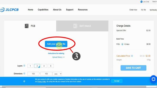

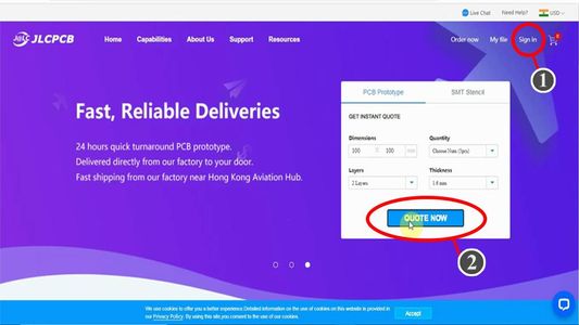

Step 6: Order the PCB
After downloading the Garber file you can easily order the PCB
1. Visit https://jlcpcb.com/RHS and Sign in / Sign up
2. Click on the QUOTE NOW button.
3 Click on the "Add your Gerber file" button. Then browse and select the Gerber file you have downloaded.

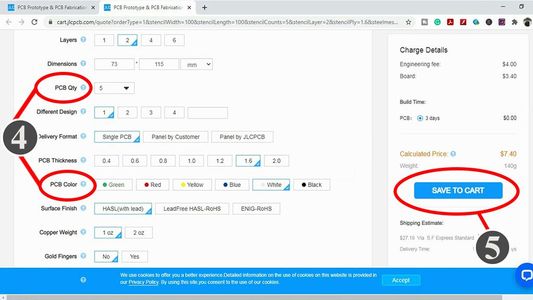

Step 7: Uploading the Gerber File and Set the Parameters
4. Set the required parameter like Quantity, PCB masking color, etc
5. After selecting all the Parameters for PCB click on SAVE TO CART button.
Step 8: Select Shipping Address and Payment Mode
6. Type the Shipping Address.
7. Select the Shipping Method suitable for you.
8. Submit the order and proceed with the payment. You can also track your order from the JLCPCB.com.

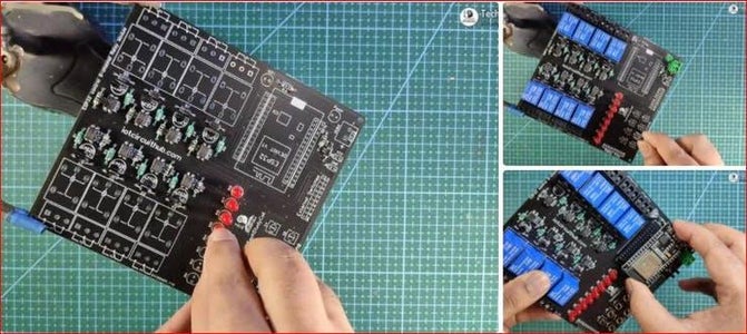

Step 9: Solder All the Components on PCB
After that, I have soldered all the components as per the circuit diagram.
Then connect the ESP32 board with PCB.

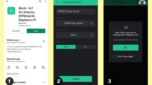

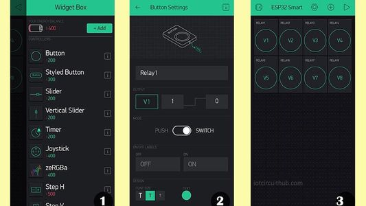

Step 10: Configure the Blynk App for This ESP32 Project
1. Install the Blynk App from the Google play store or App store. Then create an account and tap on the New Project.
2. Give the name to the project, select ESP32 Dev Board, Connection type will be WiFi. Then tap on Create.
3. Blynk will send an authentication token to the registered email id. Tap on OK.
Step 11: Add the Button Widgets in Blynk App
Then add 8 button widgets to control the 8 relays.
Here I have used virtual pins V1, V2, V3, V4, V5, V6, V7, V8 for 8 buttons. And mode will be Switch.
I have explained all the details in the tutorial video.

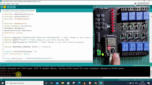

Step 12: Program ESP32 Using Arduino IDE
Download the code.
First, you have to install the required libraries. I have shared all the links in the code.
Then enter the WiFi name, WiFi password & Blynk AuthToken in the code.
  • #define AUTH "AUTH TOKEN" // You should get Auth Token in the Blynk App.
  • #define WIFI_SSID "WiFi Name" //Enter Wifi Name
  • #define WIFI_PASS "WiFi Password" //Enter wifi Password

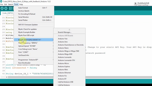

After that select the DOIT ESP32 DEVKIT V1 board and the PORT. Then click on the upload button.
While uploading if you see the "Connecting.....___" text, press the BOOT button of ESP32.
