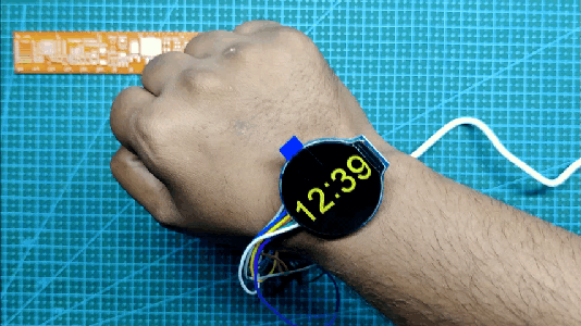

Here's a super interesting project that utilizes a Round LCD Display connected with an ESP32 board to make a smartwatch.
This Instructables is gonna be about setting up the Round LCD and basic smartwatch on a breadboard.

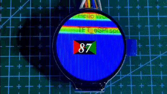

Step 7: Example #2 Scrolling 16Bit Sprite
Second Sketch will be this Scrolling Sprite Message which can be found in Example>TFT_eSPI> Sprite>Scrolling Sprite 16 Bit
#define IWIDTH  240
#define IHEIGHT 30
// Pause in milliseconds to set scroll speed
#define WAIT 0
#include <TFT_eSPI.h>                 // Include the graphics library (this includes the sprite functions)
TFT_eSPI    tft = TFT_eSPI();         // Create object "tft"
TFT_eSprite img = TFT_eSprite(&tft);  // Create Sprite object "img" with pointer to "tft" object
//                                    // the pointer is used by pushSprite() to push it onto the TFT
// Setup
void setup(void) {
  tft.init();
  tft.setRotation(0);
  tft.fillScreen(TFT_BLUE);
// Main loop
void loop() {
  while (1)
    // Create the sprite and clear background to black
    img.createSprite(IWIDTH, IHEIGHT);
    //img.fillSprite(TFT_BLACK); // Optional here as we fill the sprite later anyway
    for (int pos = IWIDTH; pos > 0; pos--)
      build_banner("Hello World", pos);
      img.pushSprite(0, 0);
      build_banner("TFT_eSPI sprite" , pos);
      img.pushSprite(0, 50);
      delay(WAIT);
    // Delete sprite to free up the memory
    img.deleteSprite();
    // Create a sprite of a different size
    numberBox(random(100), 60, 100);
// Build the scrolling sprite image from scratch, draw text at x = xpos
void build_banner(String msg, int xpos)
  int h = IHEIGHT;
  // We could just use fillSprite(color) but lets be a bit more creative...
  // Fill with rainbow stripes
  while (h--) img.drawFastHLine(0, h, IWIDTH, rainbow(h * 4));
  // Draw some graphics, the text will apear to scroll over these
  img.fillRect  (IWIDTH / 2 - 20, IHEIGHT / 2 - 10, 40, 20, TFT_YELLOW);
  img.fillCircle(IWIDTH / 2, IHEIGHT / 2, 10, TFT_ORANGE);
  // Now print text on top of the graphics
  img.setTextSize(1);           // Font size scaling is x1
  img.setTextFont(4);           // Font 4 selected
  img.setTextColor(TFT_BLACK);  // Black text, no background colour
  img.setTextWrap(false);       // Turn of wrap so we can print past end of sprite
  // Need to print twice so text appears to wrap around at left and right edges
  img.setCursor(xpos, 2);  // Print text at xpos
  img.print(msg);
  img.setCursor(xpos - IWIDTH, 2); // Print text at xpos - sprite width
  img.print(msg);
// Create sprite, plot graphics in it, plot to screen, then delete sprite
void numberBox(int num, int x, int y)
  // Create a sprite 80 pixels wide, 50 high (8kbytes of RAM needed)
  img.createSprite(80, 50);
  // Fill it with black
  // Draw a backgorund of 2 filled triangles
  img.fillTriangle(  0, 0,  0, 49, 40, 25, TFT_RED);
  img.fillTriangle( 79, 0, 79, 49, 40, 25, TFT_DARKGREEN);
  // Set the font parameters
  img.setFreeFont(&FreeSerifBoldItalic24pt7b);  // Select free font
  img.setTextColor(TFT_WHITE);  // White text, no background colour
  // Set text coordinate datum to middle centre
  img.setTextDatum(MC_DATUM);
  // Draw the number in middle of 80 x 50 sprite
  img.drawNumber(num, 40, 25);
  // Push sprite to TFT screen CGRAM at coordinate x,y (top left corner)
  img.pushSprite(x, y);
  // Delete sprite to free up the RAM
  img.deleteSprite();

Step 9: Digital Clock Sketch
This will be the final sketch that will be used in version 2 of this smartwatch project with a few tweaks, this sketch can be found in the Example>TFT_eSPI> 320x240>TFT_Clock_Digital
I did some medications in the original sketch so it won't display the seconds time and only displays hours and minutes.
Here's the edited sketch-
#include <TFT_eSPI.h> // Hardware-specific library
#include <SPI.h>
#define TFT_GREY 0x5AEB
TFT_eSPI tft = TFT_eSPI();       // Invoke custom library
uint32_t targetTime = 0;                    // for next 1 second timeout
static uint8_t conv2d(const char* p); // Forward declaration needed for IDE 1.6.x
uint8_t hh = conv2d(__TIME__), mm = conv2d(__TIME__ + 3), ss = conv2d(__TIME__ + 6); // Get H, M, S from compile time
byte omm = 99, oss = 99;
byte xcolon = 0, xsecs = 0;
unsigned int colour = 0;
void setup(void) {
  //Serial.begin(115200);
  tft.init();
  tft.setRotation(1);
  tft.fillScreen(TFT_BLACK);
  tft.setTextSize(1);
  tft.setTextColor(TFT_YELLOW, TFT_BLACK);
  targetTime = millis() + 1000;
void loop() {
  if (targetTime < millis()) {
    // Set next update for 1 second later
    // Adjust the time values by adding 1 second
    ss++;              // Advance second
    if (ss == 60) {    // Check for roll-over
      ss = 0;          // Reset seconds to zero
      omm = mm;        // Save last minute time for display update
      mm++;            // Advance minute
      if (mm > 59) {   // Check for roll-over
        mm = 0;
        hh++;          // Advance hour
        if (hh > 23) { // Check for 24hr roll-over (could roll-over on 13)
          hh = 0;      // 0 for 24 hour clock, set to 1 for 12 hour clock
    // Update digital time
    int xpos = 0;
    int ypos = 85; // Top left corner ot clock text, about half way down
    int ysecs = ypos + 24;
    if (omm != mm) { // Redraw hours and minutes time every minute
      omm = mm;
      // Draw hours and minutes
      if (hh < 10) xpos += tft.drawChar('0', xpos, ypos, 8); // Add hours leading zero for 24 hr clock
      xpos += tft.drawNumber(hh, xpos, ypos, 8);             // Draw hours
      xcolon = xpos; // Save colon coord for later to flash on/off later
      xpos += tft.drawChar(':', xpos, ypos - 8, 8);
      if (mm < 10) xpos += tft.drawChar('0', xpos, ypos, 8); // Add minutes leading zero
      xpos += tft.drawNumber(mm, xpos, ypos, 8);             // Draw minutes
      xsecs = xpos; // Sae seconds 'x' position for later display updates
    if (oss != ss) { // Redraw seconds time every second
      oss = ss;
      xpos = xsecs;
      if (ss % 2) { // Flash the colons on/off
        tft.setTextColor(0x39C4, TFT_BLACK);        // Set colour to grey to dim colon
        tft.drawChar(':', xcolon, ypos - 8, 8);     // Hour:minute colon
        //xpos += tft.drawChar(':', xsecs, ysecs, 6); // Seconds colon
        tft.setTextColor(TFT_YELLOW, TFT_BLACK);    // Set colour back to yellow
      else {
       // xpos += tft.drawChar(':', xsecs, ysecs, 3); // Seconds colon
      //Draw seconds
      if (ss < 10) xpos += tft.drawChar('0', xpos, ysecs, 6); // Add leading zero
     // tft.drawNumber(ss, xpos, ysecs, 6);                     // Draw seconds
// Function to extract numbers from compile time string
static uint8_t conv2d(const char* p) {
  uint8_t v = 0;
  if ('0' <= *p && *p <= '9')
    v = *p - '0';
  return 10 * v + *++p - '0';
Step 10: Version 2
