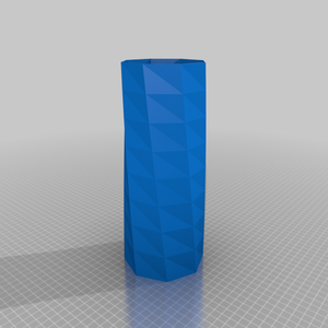

Step 2: Case Production
While the PCB is being made, you can start making the case for the lamp. Use our case design or one of the ready-made designs on the Thingiverse website or other sources, or create your own if you have 3D design skills.
Please note that our PCB design includes a Reset button, which must be accessed on the bottom of the case via a hole. If you use your own custom case design, be sure to include this hole or drill it when the board is ready!

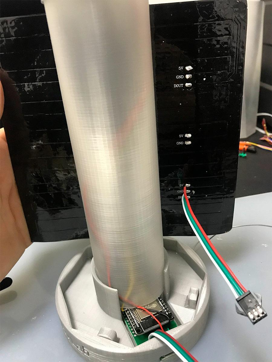

Step 4: Assembling the Device
So, you have a ready-made printed circuit board, a case for the lamp, a flashed microcontroller, and all the necessary components and tools. It's great! Let's assemble the lamp so we can finally turn it on and start using it!
  1. Prepare the touch button - unsolder the diode (if we don’t want it to glow) and put a jumper on the A pad.
  2. Solder three wires to the touch button.
  3. Unsolder all wires from the matrix except for the DIN connector.
  4. Solder the DOUT connector soldered from the matrix to the inner side of the board.
  5. Solder the reset clock button to the back of the board.
  6. Solder the Micro-USB input to the inner side of the board.
  7. Solder ESP32 to the inside of the board.
  8. Connect through the soldered micro-USB power supply and check that the matrix works.
  9. Pass the wires of the touch button through the hole in the tube and solder to the board, the signal wire directly to pin D19.
  10. Install the assembled controller in the seat in the lower part of the case.
  11. Install the inner tube.
  12. Put on and fix the matrix using zip ties. The matrix strips should be placed horizontally.
  13. Lay the wires.
  14. Put the lid on the inner tube without pressing tightly. If the lamp switches modes on its own after assembly, the lid should be slightly raised.
  15. Close everything with an external case and turn on the power.
