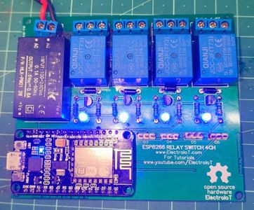

Introduction: ESP8266 4-Relay IoT Control With Arduino Cloud & Push Buttons
In this project, we will use an ESP8266 NodeMCU to control four relays using both Arduino IoT Cloud and manual push buttons. This allows remote switching via the cloud while maintaining local control. The project is ideal for home automation applications, allowing you to control lights, fans, and other appliances via the internet.

Circuit Diagram
Connections
Relays
RelayESP8266 Pin
Relay 1
D1 (GPIO 5)
Relay 2
D2 (GPIO 4)
Relay 3
D5 (GPIO 14)
Relay 4
D6 (GPIO 12)
Push Buttons
SwitchESP8266 Pin
Switch 1
SD3 (GPIO 10)
Switch 2
D3 (GPIO 0)
Switch 3
D7 (GPIO 13)
Switch 4
RX (GPIO 3)
WiFi LED
WiFi Status LED → D0 (GPIO 16)

Step 4: How It Works
Cloud Dashboard: The Arduino IoT Cloud lets you toggle each relay remotely.
Manual Push Buttons: Pressing a button toggles its corresponding relay.
WiFi LED Indicator: If WiFi is disconnected, the LED turns ON; otherwise, it stays OFF.
State Synchronization: The relays remain updated whether controlled remotely or manually.
