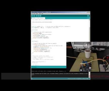

If all the steps before endend successfully You are ready for your first ESP8266 Program written in Arduino IDE:
Blink Turns on an LED on for one second, then off for one second, repeatedly. Most Arduinos have an on-board LED you can control. On the Uno and Leonardo, it is attached to digital pin 13. If you're unsure what pin the on-board LED is connected to on your Arduino model, check the documentation at http://arduino.cc This example code is in the public domain. modified 8 May 2014 by Scott Fitzgerald *
/ the setup function runs once when you press reset or power the board
void setup() {
  // initialize digital pin 13 as an output.
  pinMode(15, OUTPUT);
// the loop function runs over and over again forever
void loop() {
  digitalWrite(15, HIGH);   // turn the LED on (HIGH is the voltage level)
  delay(1000);              // wait for a second
  digitalWrite(15, LOW);    // turn the LED off by making the voltage LOW
