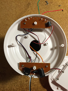

- Disassemble the Aurora Master by removing all 5 screws on the bottom, including the battery cover. Remove any batteries and use only the AC Power supply included with the Aurora Master. Since you won’t use batteries, you can safely cut the two leads to the battery holder and tape them off. (optional!)
- There are two circuit boards. One for Power and the other for Control. Remove the screws from the Power board. (bottom board in photo above).

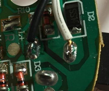

- Solder two wires about 6” long to the 5v power connector as shown in the photo below. These wires should have a breadboard pin or connector on the other end, just to make it easier to plug into a breadboard.
Black wire goes to the ground of the power connector
White wire goes to the +5V of the power connector - Cut a small groove into the plastic case beside the power connector so you can route the wires out of the case w/o crushing them.
- Replace the power circuit board and its screws.
Be SURE the BLACK and WHITE wires are NOT touching each other. These are directly connected to the 5V supply and would short it out!

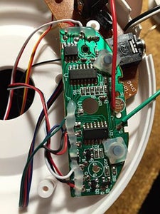

Step 3: Continue With Control Board Mod...

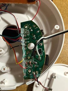

- Now remove the screws from the Control board. There are 3 plastic buttons that will fall out. You can discard them unless you plan to use the built-in audio feature.

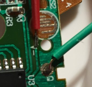

- Remove the rubber cover of the CENTER button. You will see a tiny grid circuit pad. You will need to solder two wires to these traces. Since they are very small, you have to be very careful not to bridge the gap with solder!
I decided to solder the ground wire (GREEN) to a nearby solder pad.
And the RED wire slightly away from the grid pad.
Use an Exacto knife to delicately scrape the top of the circuit board points where you are going to solder in order remove any coating for easier soldering. I had to use a very fine solder point (0.8mm) and magnifying glass, due to the small size. Don’t overheat! - Once soldered, gently push the wires thru the center button hole to the outside of the case and replace the Control circuit board. I used hot melt glue in the hole to hold the wires.
- Replace the bottom and battery cover.
TEST
You can verify the wiring before continuing by plugging in the 5V power and momentarily connect between the RED and GREEN wires. The Aurora should turn on. Each time you touch the wires together it should cycle to the next mode just like before the modification.
You can test the Power leads (BLACK & WHITE) using a voltmeter. The White lead should be +5v and Black ground.

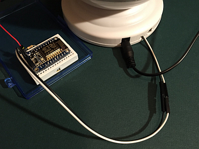

Step 5: Next Is the ESP8266 Wiring:

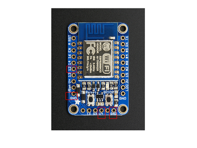

- See the diagram of the wiring for the transistor and resistor.
- And the leads for the NPN transistor
- The third photo shows the pinout of the HUZZAH ESP8266 with the connection points marked.
The Power leads (WHITE to V+, BLACK to GND)
The Control lead (RED to GPIO pin 12)The other control lead (GREEN) does NOT have to be connected, as the Power ground is sufficient.

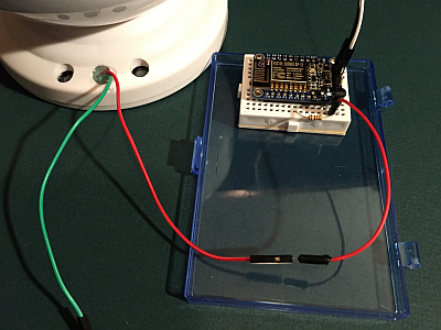

Step 6: Finishing Up the Hardware

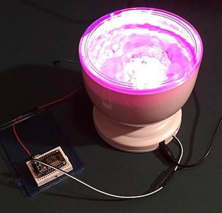

Once the wires are all connected, it should look like the photos.
1. Plug the Aurora Master power supply in and watch for the ESP8266 Red LED to blink 4 times indicating it connected to your WiFi network.
2. Use a browser and Go to http://your_ip_addr/gpio/step and see the onboard LED blink once and the Aurora turn on.
3. Repeat the above URL multiple times to step thru the patterns and finally turn off.
