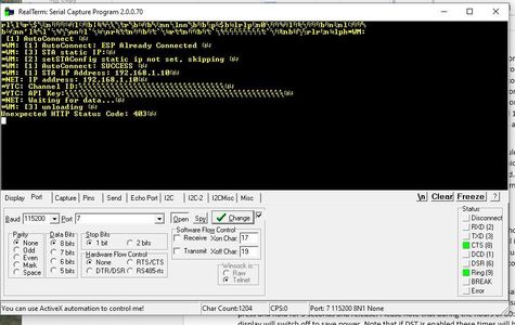

Once programmed and the board is rebooted it should display 8. on all displays then a row of dashes followed by --HELP-- after a short while. This indicates that the ESP8266 is working and needs connecting to the internet.
Please note that the source code is set for UTC timezone. As the NTP servers do not support local time zones you will need to edit this line of code "long utcOffsetInSeconds = 0;" to your timezone before compiling the source code. There are 3600 seconds per hour so for example in CET timezone you would enter "long utcOffsetInSeconds = 3600;" and for Western US time you would enter "long utcOffsetInSeconds = -180000;"
Precompiled binaries are available for UK and Europe on my blog site which can be flashed with the esp8266flasher.exe tool. There are two versions for each timezone; one that saves power by turning off the display at night and one that does not and the display is always on.
If you struggle to compile the code let me know and I can compile a version for you. Just let me know what your timezone is.
Lastly there is a serial diagnostics function on this project for troubleshooting. Error messages and status information is sent to the serial port for analysis if required.
