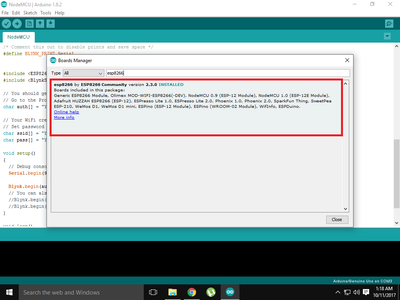

First open your arduino IDE. Then go to Preferences and then add the following
link to Additional Boards Manager URLs :
http://arduino.esp8266.com/stable/package_esp8266c...
Then go to Boards Manager and install ESP8266 package.

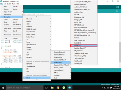

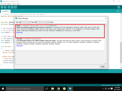

Then go to Library Manager and install Blynk.
Then go to examples and select NodeMCU from Blynk.

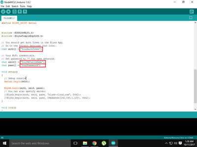

Give your SSID and password.
You will also have to give your AuthToken which you will get in the following step.
And after that you will have to upload the sketch to your ESP8266.
