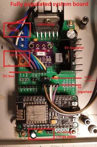

OK, you have chosen your options and rounded up the components. Time to build it. I designed a system board PCB and this supports all the various build options. I have a limited number of these for sale [2022-09-01 update, sorry these are all sold], but I will make the Gerber files available to you so you can order your own. If you build the L298+bare bones option, you could hook all the elements up with dupont wires and avoid using the system board. For any of the more complete builds you really need a system board.
System board. This accepts a 12V power feed. Has an 5v regulator, space for the INA219 current monitor and LD18200 H bridge, some discretes and of course the nodeMCU. It also has various jumper options and provides a hookup for the I2C bus and jogwheel.
DSKY + emergency stop and mode buttons. This runs entirely over the I2C bus. The 1602LCD needs an I2C backpack module. You can buy the 1602 with backback as a complete unit on ebay. Several backpack versions are avaiable and the software allows you to set the configuration for the one you have. The keypad is a 4 x 4 telephone matrix keypad. Conveniently an I2C expansion board module is available which fits the keypad exactly and allows us to scan the key matrix over I2C. The emergency stop and mode buttons are wired as pulldowns onto this expansion pack also, which neatly integrates them. Note that the 1602LCD units typically are 5v units. This means we need to run the I2C bus at 5v. Luckily the I2C backpack, I2C expander for the keypad and the INA219 are all 5v tolerant. ThenodeMCUis not, it needs to run at 3v3 and so the I2C bus clamping diodes are essential. 2022-04-01 in fact the nodeMCU pins when used as I2C open-drain/inputs are 5v tolerant, so the clamping diodes are optional.
Side ramble: The system board provides a jumper option to run the I2C bus at 3v3 but you will find the 1602LCD won't display anything. This is because the LCD bias voltage needs to be 4V lower than Vcc, which is actually a negative voltage if you run the LCD at 3v3. You could unsolder one end of the contrast pot and connect this to a -ve voltage bias. In fact I provide for this on the system board. There's a charge pump that generates -3v on a pin next to the I2C bus pins. It does work.... but... the LCD brightness is then poor because the LED backlight is on 3v3 rather than 5V. Save yourself the fuss and run the I2C bus at 5V.
Jogwheel. Also known as a rotary encoder. You need the vanilla 5 pin type. 2 pins are wired to the pushbutton function. The other 3 are wired to the jogwheel itself. These devices detect which way you are rotating them by encoding a pulse on 2 pins vs ground in various phases. They are dreadfully noisy electrically, and the software uses some clever state-engine logic to clean up the signal. IMHO this is the best interface.

Hardware BUGS (update 2022-03-28). See errata schematic. If you build the LMD18200 version on my custom designed circuit board, you will find the system gives a brief DC pulse on the track during boot. This is because the drive pins for the LMD happen to boot high and then correctly go low 0.5 sec later in the boot sequence. To eliminate this, you need to remove the wire link JP6 and replace it with a 15k resistor mounted vertically. Then on the underside of the board, fit a 47uF cap between the LMD pin connecting to this resistor and the 3v3 rail. (the +ve side of the cap to the 3v3 rail). What this does is hold that pin high for about 0.8 sec during power up, before allowing it to go low (JP6 was just a wire link to gnd) and thus enabling the LMD output about 0.8s after power is applied by which time the boot sequence has correctly set the drive pins.
JogWheel BUG 2022-03-28 update. There are two types of rotary encoders available on ebay, the one I used (a free component not mounted on a board and with a splined spindle) will always have its switches open-circuit when on a detent. The second type comes mounted on a board and has a notched spindle, with markings such as HW040. This type alternates between both switches open and closed on alternate detents. I have updated the software on gitHub to support both. But both types have a hardware limitation due to the behaviour of GPIO15 on the ESP12.
Type-1. With type 1, the system will boot from power up (POR), you can programme it via USB and you can reset it via the pushbutton, PROVIDED the switch is not part-rotated between detents. If it is part-rotated then boot will fail. You can fix this by rotating to the next detent. That's fine if you are programming it, but once the unit is built, its annoying that boot occasionally fails (and the unit puts DC on the track) if the jogwheel was knocked to a mid detent position. To fix it so that it always will boot on POR, you need to solder a 47uF cap to the R5 feed to JP5, the other side of the cap is soldered to ground. What this does is modify the R5 (1k) pullup so that it pulses low on POR, and it holds this line low long enough that boot completes. The reason for all this is D8 (GPIO15) must be low during boot. If the switch is mid detent then R5 will pull D8 high and boot will fail. This capacitor fix will make POR reliable for type-1 switches. It does not fix USB programming or the reset button so my advice is to disconnect JP5 if you wish to programme the device.
Type-2. With these rotary encoders, boot definitely will fail on 50% of the detents. To fix: solder a 47uF cap to the R5 feed to JP5, the other side of the cap is soldered to ground. What this does is modify the R5 (1k) pullup so that it pulses low on POR, and it holds this line low long enough that boot completes. Note that USB programming will not work if the rotary encoder is in-circuit, so unplug JP5 (i.e. disconnect the rotary encoder) for programming. The reset button on the board will only work on 50% of the detent positions.
Wiring up type-2 encoders. These come marked with +, Gnd, CK, DT and SW. To wire these up, first swap the polarity. Connect + on the encoder to system GND. Connect Gnd on the encoder to system 3v3. This causes the on-board resistors to act as pull downs on the jogwheel. Connect SW to D0 on the ESP, and CK to D7 and CT to D8. SW when pressed will now pull D0 to system GND.
Proper fix for type-1 and type-2 encoders. Is shown in the PCB errata schematic pdf. It involves a transistor and is more complex, but it will allow the encoder to be in-circuit for USB programming, reset-pushbutton and POR.
