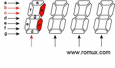

In my circuit, only two shift registers control 4 7-segment displays, using a handy technique called multiplexing. Multiplexing involves switching on and off each of the 4 displays extremely fast, so that all off them appear to be on to the human eye (see persistence of vision).
The GIF above shows the process of multiplexing in slow motion. Notice now that instead of 28 pins, we only have 7 (a to g) + 4 (cathode of each display = ) 11 pins to control!
Now, shift register A controls pins a to g, while shift register B controls the common cathode pin of each 7seg display. In this way, all outputs are controlled via only 3 pins of the ESP using 2 shift registers.

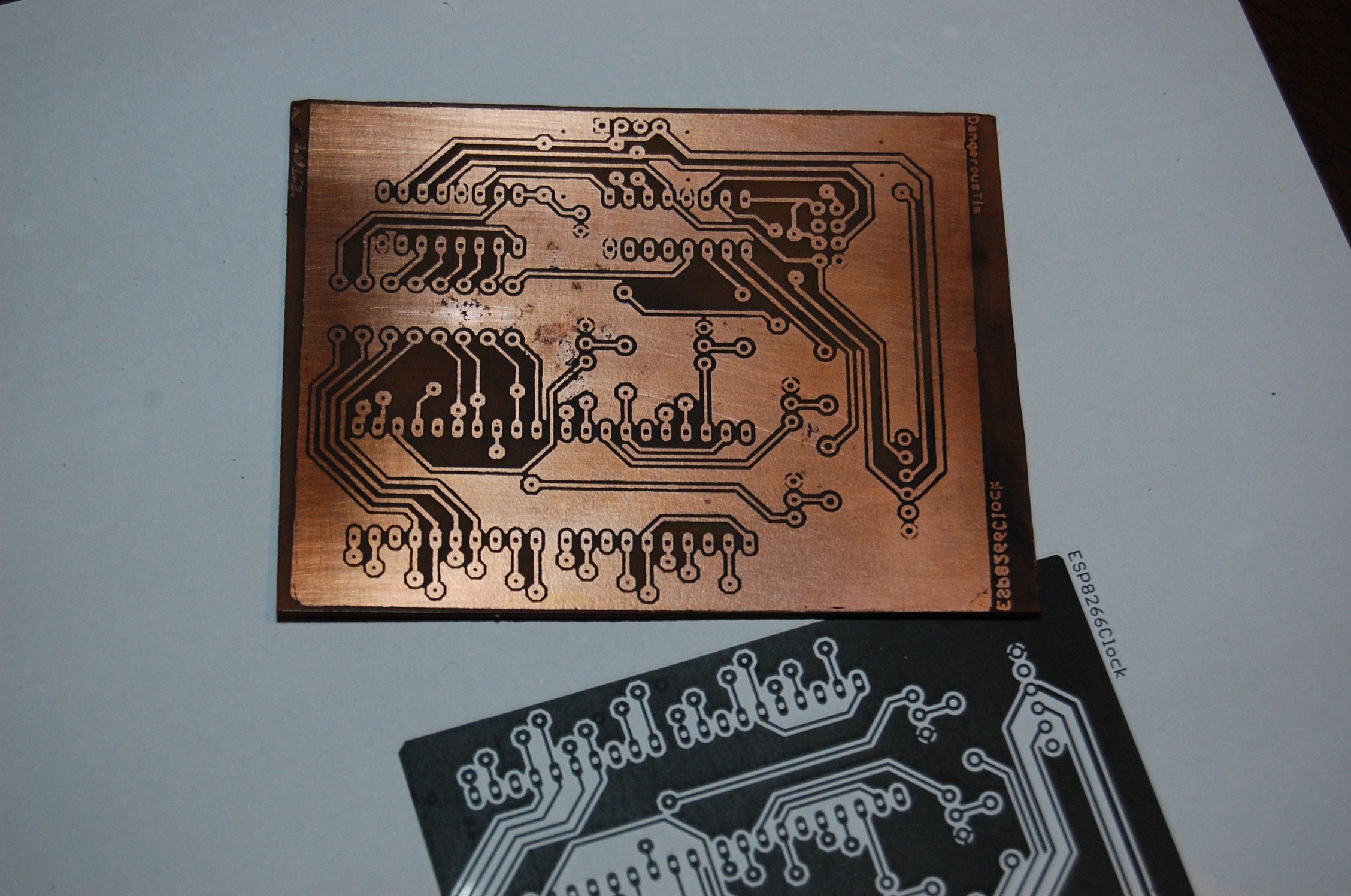

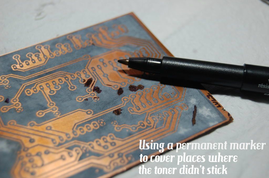

This PCB was designed on eagle for a single sided PCB, although it the design can be easily tweaked for a double-sided one. I won't go through the PCB fabricating process here, but here are some methods you could try out if not familiar with this process.
Methods for transferring circuit design onto a copper PCB:
- Toner Transfer, using iron (check out this other tutorial too) -I used this method
- Toner transfer, using laminator
- 'Cold' toner transfer
- UV/Light fabrication (using pre-sensitized PCBs)

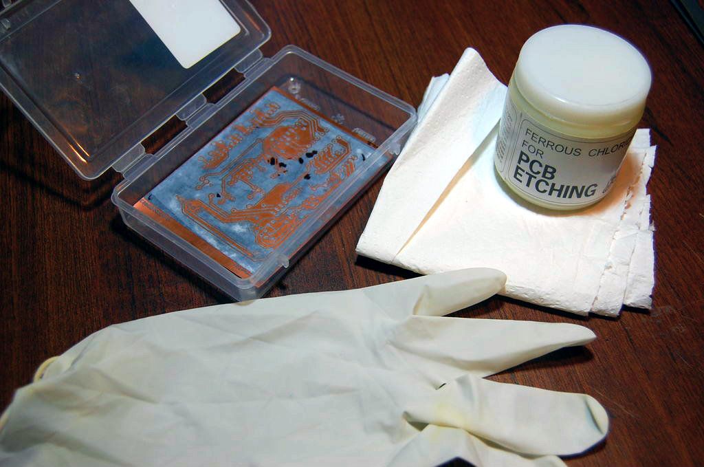

Methods for Etching PCB:
- Normal Ferric Chloride etchant (try a quick method) - I used this method
- Homemade etchant

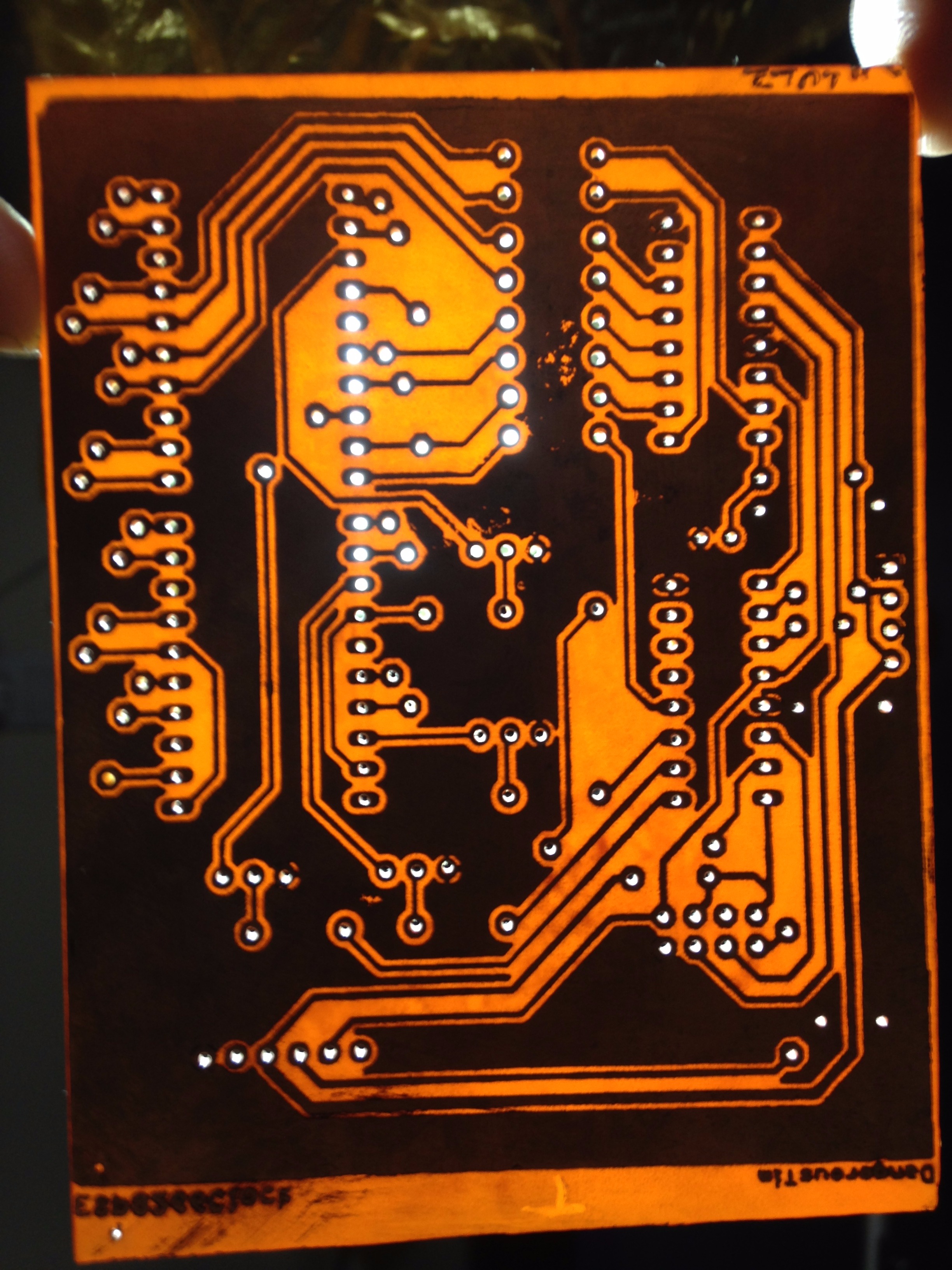

Making the Clock PCB
1. Toner Transfer
NOTE: Do not print the mirrored version of the eagle board!!!
2. Etching the PCB
Materials:

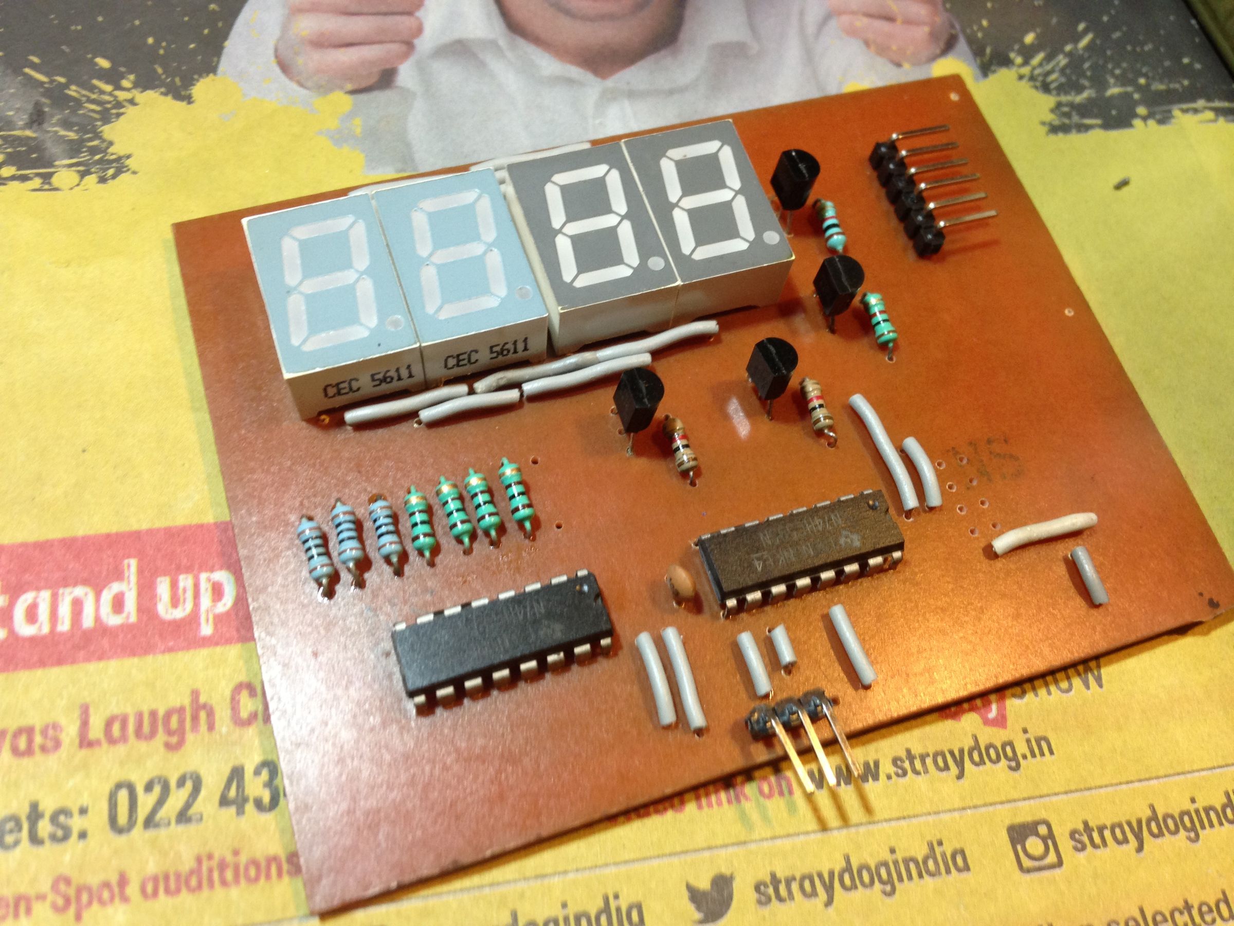

Step 5: Populate the PCB

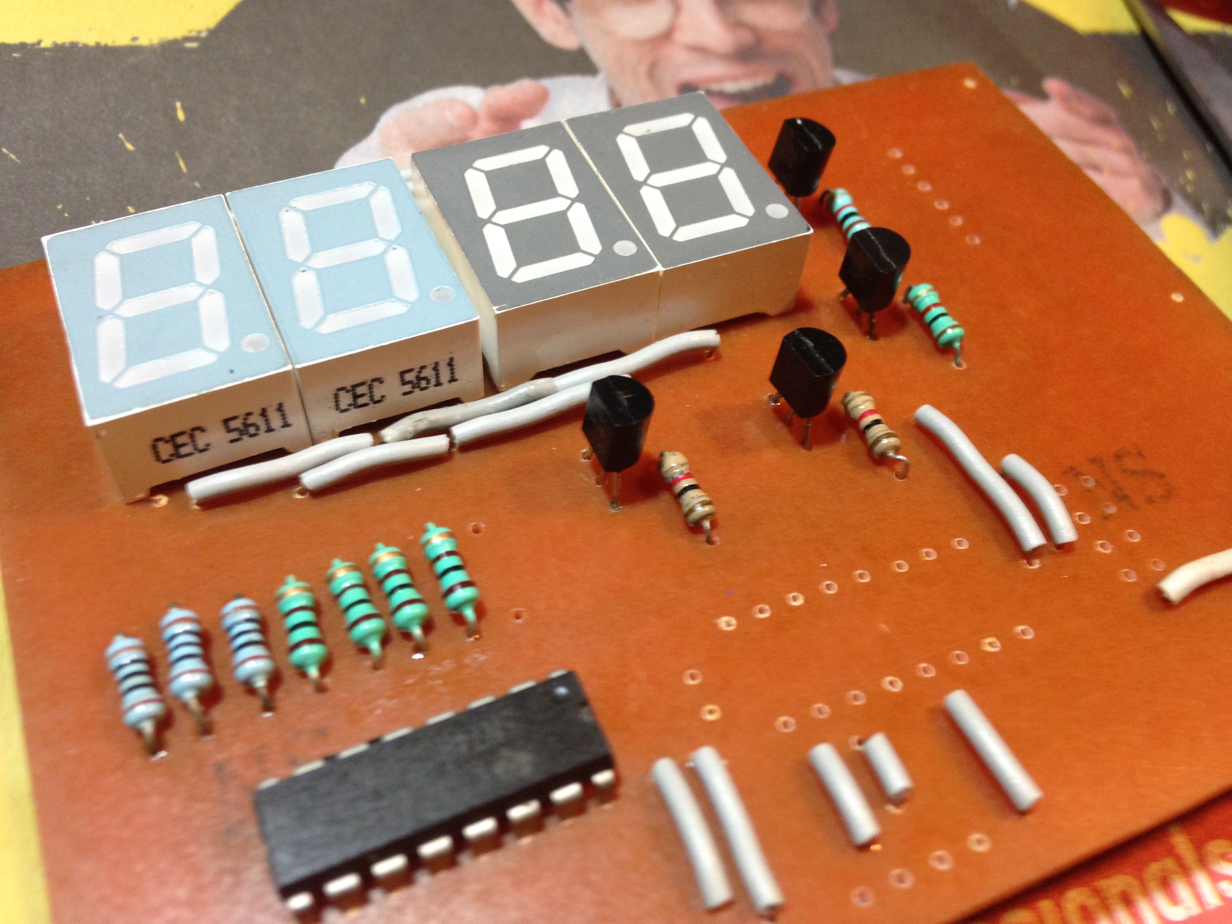

Yes, the PCB turned out to be a fine piece of art, but now you've got to stop admiring and start ruining it by soldering.

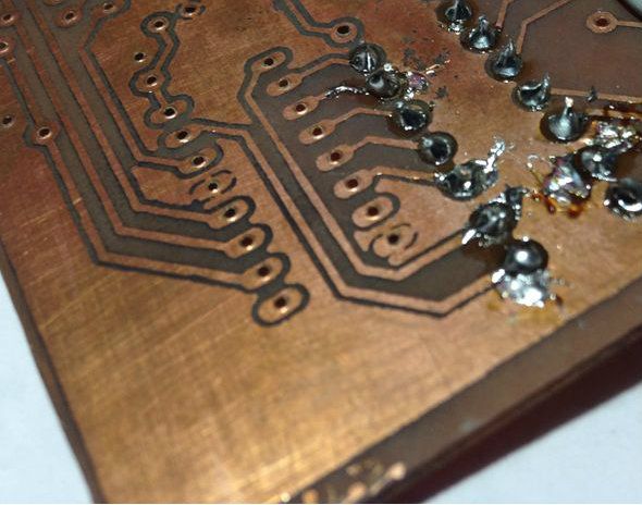

1. Start with the 7seg displays, but remember to solder in the jumper wire that hides beneath them before!
2. Next, the resistors...
I know I did a messy job, but oh well the connections work. Use a multimeter!

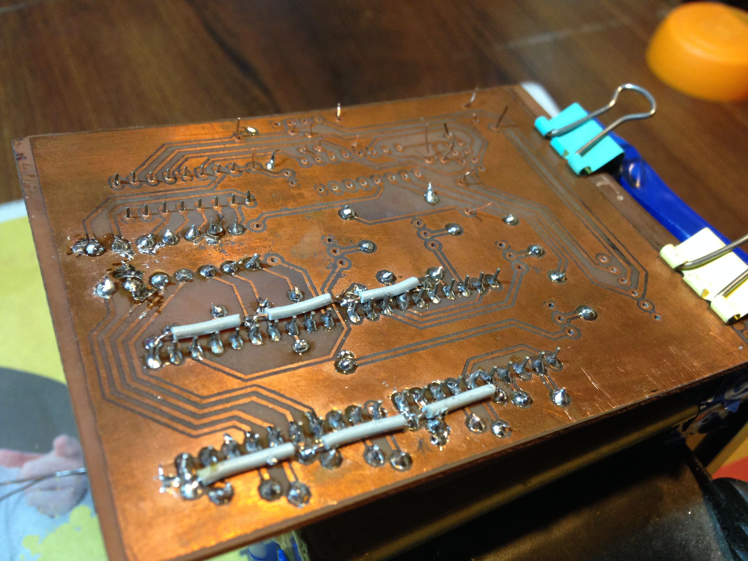

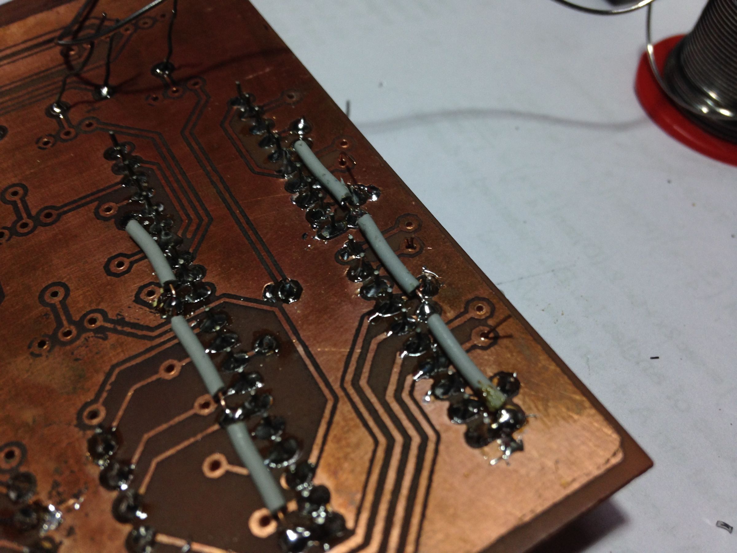

3. Now solder in the jumper wires close to the displays...
NOTE: I soldered the jumpers closest to the displays on the copper side, due to space constraints.

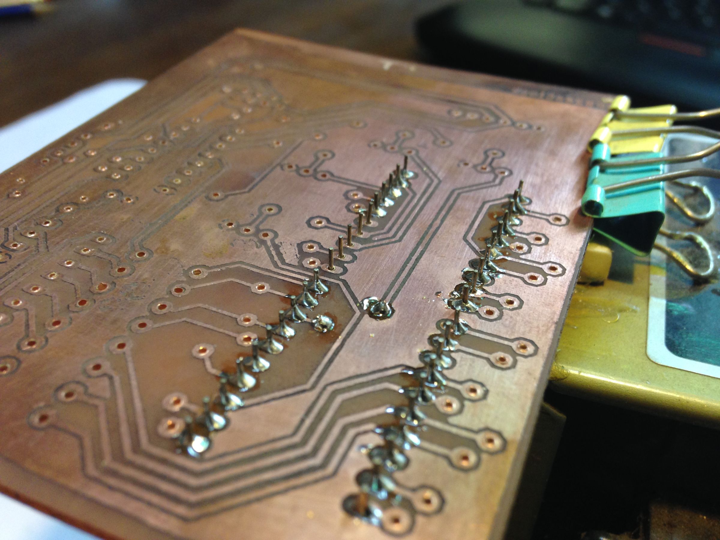

Step 6: Soldering in the Rest of the Components...

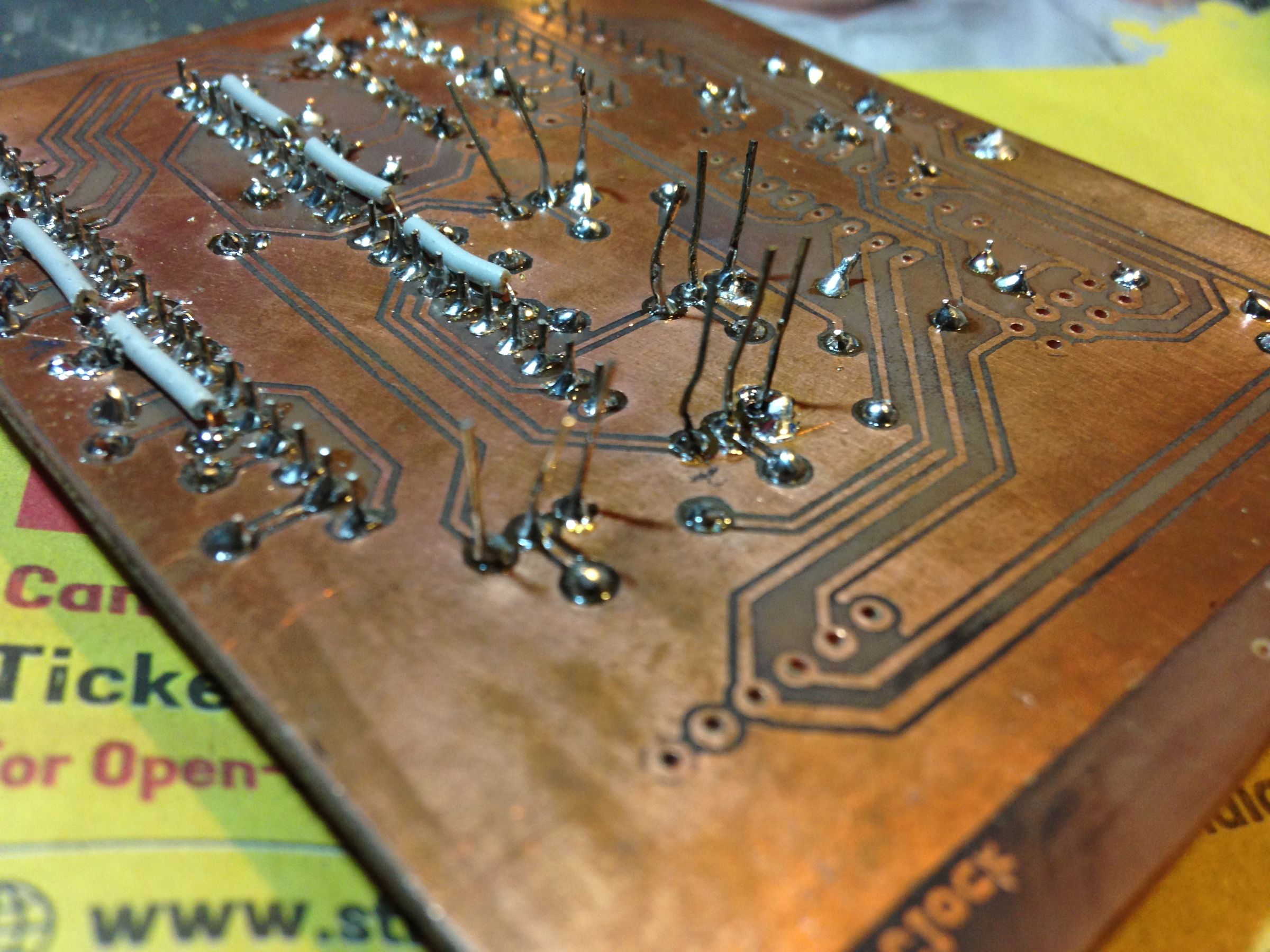

4. Place the rest of the jumper wires and solder...
5. Solder transistors. Be careful, they are a little sensitive to heat!
The above image shows the jumpers and transistors soldered. Observe the correct placement of the transistor! Note that the IC hasn't been soldered yet...
6. Soldering the ICs...
Add the male headers too, as shown above.
Now all that's left to solder is the ESP itself!

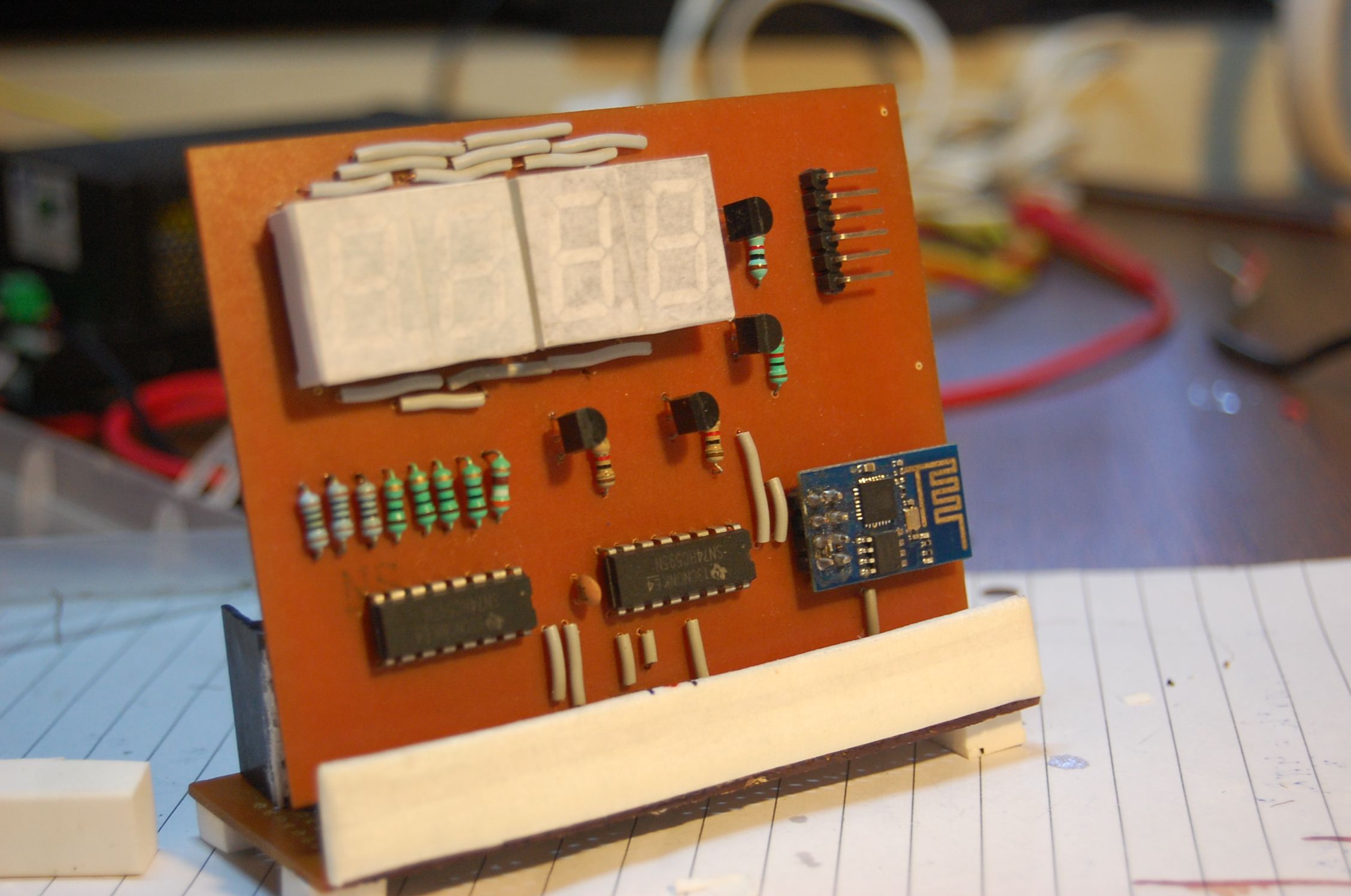

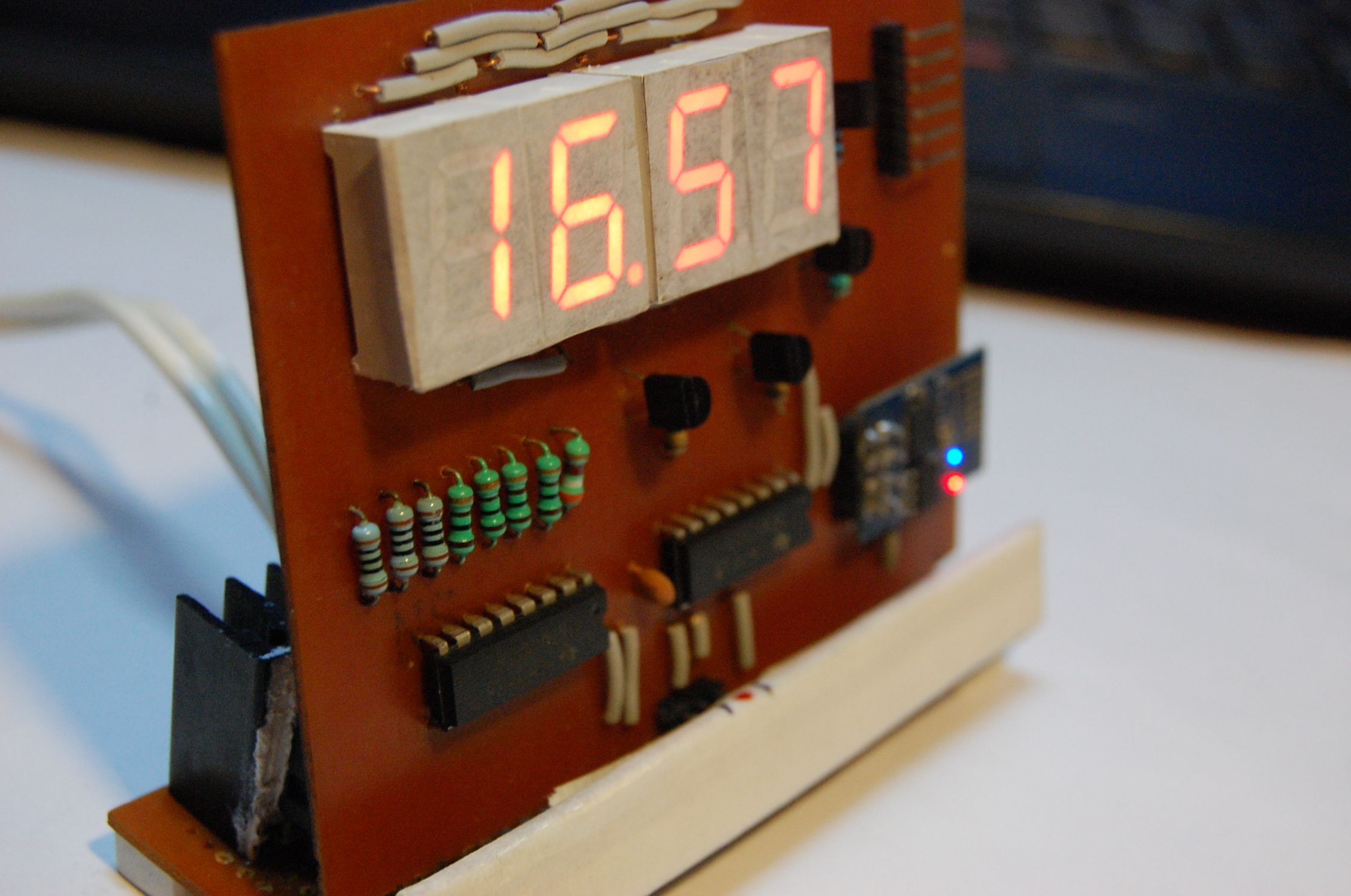

Step 9: Finishing the Clock, and Improving the Display
If you've thoroughly check everything and have faced no problems, congratulations, you have created a working clock! Be sure to switch on your wifi network, otherwise the clock will show the time as 00:00.
As you can see in the 1st picture above, the clock shows the time OK, but it isn't that easy to read, especially from a distance (depends on the quality of your 7seg displays). TO fix this problem, I used tracing paper to cover the displays. The result is, much much better contrast. Refer to the pictures above.

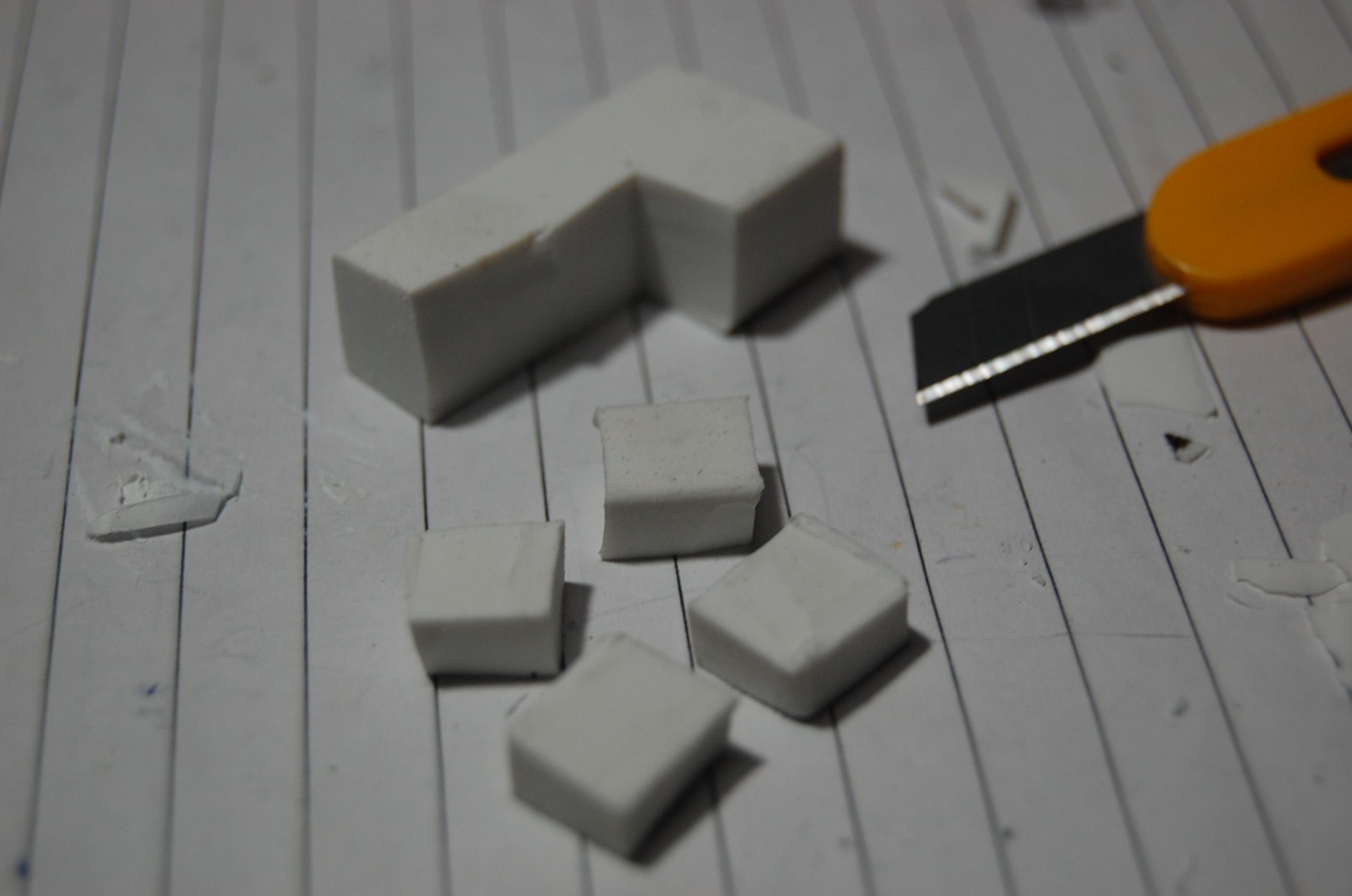

For aesthetics I added an ice-cream stick covered in white tape on the front like this (its glued on to the 3 pin header):

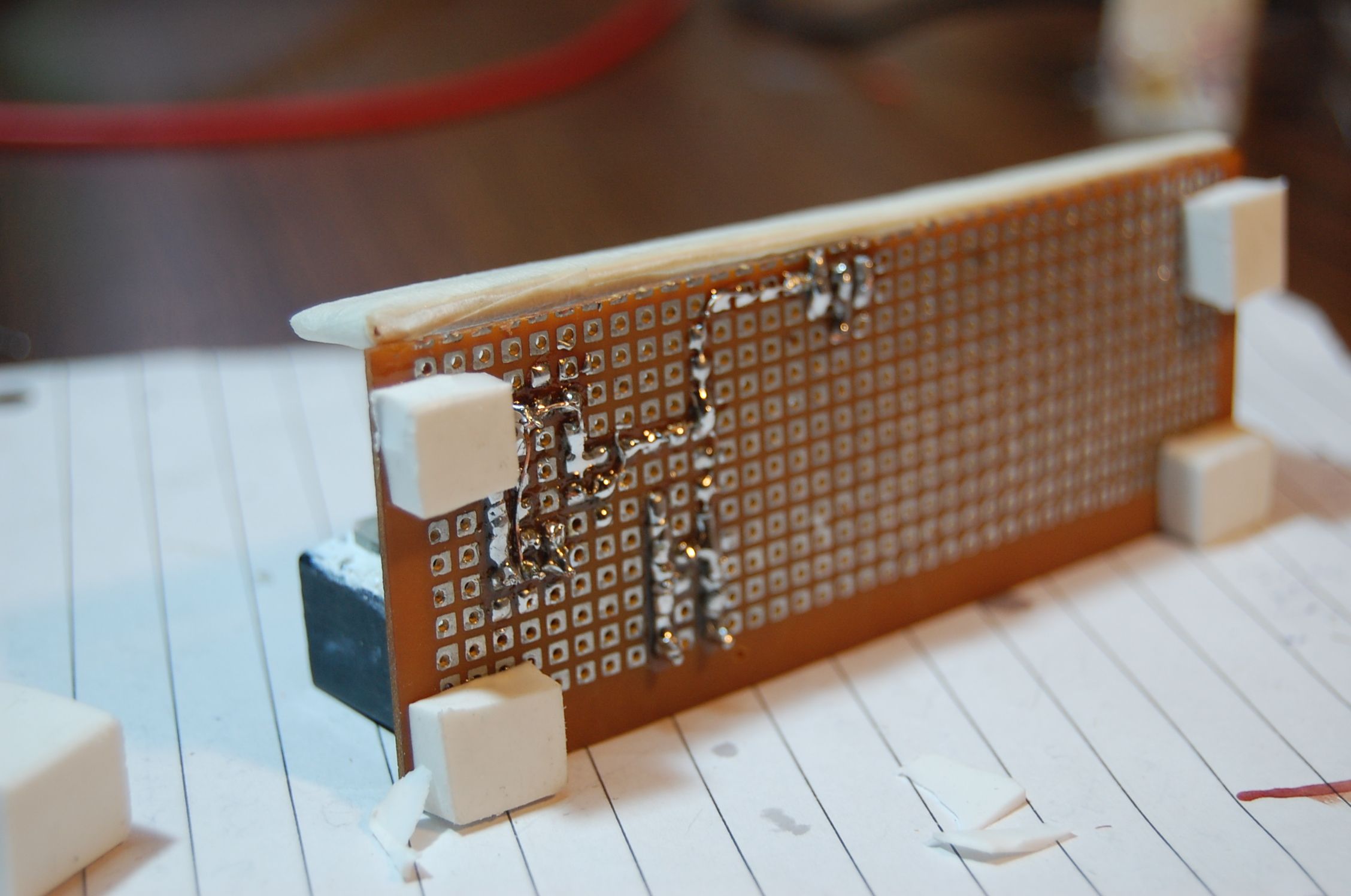

The LM317 power supply board, apart from bringing down the voltage, also acts as a stand for the clock:
For stability I added 4 pieces of rubber on the base PCB:

After troubleshooting and checking all circuits, its time to power the entire circuit! Simply insert the clock board to the power supply board, paying attention to correct polarity.
Voila, a working clock!
