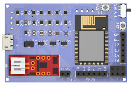

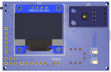

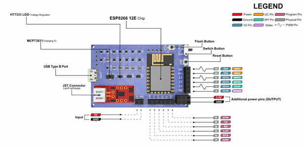

This device is basically a development board based on ESP8266 chip and battery. You have 6 free I/O pins, you have free I2C pins, and you can attach as many sensors, relays, LEDs and other components as you want, and program it as you wish. This device has an integrated OLED display and a place for any I2C sensor. The main difference between this board and others you can find on AliExpress is in 2 things:
1.) LDO voltage regulator - most boards such as Wemos, NodeMCU and others have an AMS117 voltage regulator that has an extremely high drop-out voltage of 1.3V, which makes them unusable for battery power, except for programming, gaming, learning, if you just want to see that what you made works, this board has a HT7333 LDO voltage regulator which has an extremely low drop-out voltage somewhere around 150mV, you can also check the specification of the regulator on the internet. In this way, the device can receive from 3.3V-6V and always give the micro-controller 3.3v and power other components such as OLED display, Sensor without any problems. You can also connect a solar panel.
2.) LipoFuelGauge- In order to be able to accurately measure the state of the battery, you cannot do it through resistors and ADC Pins, because the voltage of lithium-ion batteries does not drop linearly, while this chip has a special algorithm that calculates the state of the battery. Today, all smartphones, cameras, smart watches and other battery-powered devices have an integrated LipoFuelGauge system. This board still has 2 resistors connected to the ADC pin, if someone wants to use that option, but it's only for playing, for example if you use this board as a smart wireless thermostat for central heating like Nest, Netatmo and others, then this device will be a cheaper but reliable alternative. The LipoFuelGauge is ordered separately and soldered to the board. It costs about $1-2 on AliExpress. You have the option to order the production of this board through PCBWay, and you also have another option where you can buy from my website the entire package of files that contains:

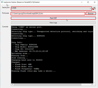

Step 4: How to Program the Board
You have several options when it comes to programming the ESP8266 board. You can use Arduino IDE, PlatformIO etc. However, if you're going to use the Home Assistant integration board, go to:
needforelectronic.com
On my website, in the Let's Build section, you have detailed step-by-step instructions on how to program the board for integration with Home Assistant, and you can download those files (yaml and code) from my website as part of a package that contains gerber files and stl files for 3D printing
Use this guide only if you want integration with Home Assistant, if you don't, you can program it like any ESP board via Arduino IDE, PlatformIO or another development environment
