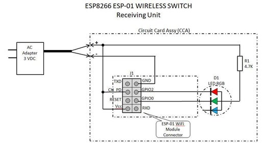

How the Reset Circuit Works: Refer to the sending unit wiring diagram. Let’s assume the switch S1 is in the Normally Closed (N.C.) position. In this position capacitor C1 is charged to a positive voltage through resistor R1 and that positive voltage is seen at the RESET pin of the ESP-01 Wi-Fi module as a logic 1 (high) signal. Resistor R2 across capacitor C1 is of such a high value (1 Meg-ohm) compared to R1 (10 K-ohm) that it has a negligible effect on the charge. With the switch in this position capacitor C2 is essentially an open circuit causing any charge in C2 to discharge to 0 (zero) volts through resistor R3. When switch S1 is toggled to the Normally Open (N.O.) position a positive current is applied to capacitor C2 through R1. As C2 begins to charge, the voltage across C2 slowly increases from 0 volts to 3 volts in about 0.5 seconds (RC time constant = 0.22 seconds). This 0 to 3 volt rise is seen at the RESET pin of the ESP-01 Wi-Fi module and is interpreted as a reset signal which causes the module to wake up. Meanwhile, since capacitor C1 is no longer connected to a current source it slowly discharges to zero volts through resistor R2. When switch S1 changes state again, the whole process is repeated by again sending a reset signal to the module.
Use OF A Field Effect Transistor (FET): Field effect transistor (FET) Q1 is used to reflect the voltage state of the switch’s Normally Open (N.O.) circuit which is fed to the Rx input pin of the ESP-01 module. The module’s software reads the Rx input to determine the position the switch. A field effect transistor was used because unlike a regular transistor, its input (gate) draws no current and doesn’t affect the RC circuit. Additionally the Source/Drain circuit tied to the module Rx pin will have no power applied when the module is in its deep sleep mode and thus doesn’t drain power from the battery. The Rx pin was used instead of GPIO0 or GPIO2 to read the switch state because both those pins have to be at a logic 1 state during the reset sequence so that the module initializes correctly.
Overall Operation Described: The ESP8266 ESP-01 Wi-Fi module used in the receiving unit was programmed to operate as an “Access Point” (i.e. server) using User Datagram Protocol (UDP) and the Wi-Fi module used in the sending unit was programmed to operate as a “Client” also using UDP. Note that this Wi-Fi system is standalone and does not require connection to the internet or access to your home computer network or router/server. When the door position switch changes state the sending unit (Client) wakes up, establishes communication with the receiving unit, and sends the state of the switch to the receiving unit. Upon receipt of the switch state the receiving unit will either turn on the red LED (door open) or the green LED (door closed) and send an acknowledge message back to the sending unit letting it know the message was received. Upon receipt of the acknowledge message the sending unit will remain awake for 1 more second and then go to sleep. If an acknowledge message wasn’t received in 1 second, the sending unit will retry sending the switch state again. If after 10 seconds an acknowledge message is still not received the sending unit will give up and go to sleep to conserve battery life.

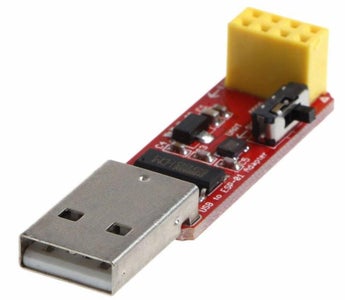

  1. Computer – Used for programming the ESP8266 ESP-01 modules
  2. ESP-01 Programmer Adapter UART (See Figure 6) - Used for programming the ESP8266 ESP-01 modules

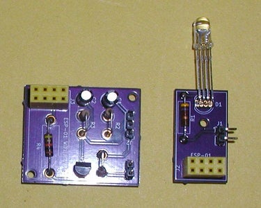

Step 1: The Circuit Boards
Although the circuits are fairly simple and could be assembled and wired using a prototyping circuit board, the low cost of having a professional circuit board manufactured was too good to pass up. I had them built by a company called OSHPARK (https://oshpark.com). At the time of this writing OSHPARK will manufacture the boards for only $5.00 per square inch (includes shipping). And since each board is fairly small, the price I paid for both boards was only $10.35. For this price, OSHPARK will provide you 3 boards of each type. To order the circuit boards from OSHPARK, perform the following:

Step 2: Populating the Circuit Boards
Once the circuit boards are received from the manufacturer install the components listed in the parts list using the provided figure as a guide. Ensure you install the correct value resistors in their designated locations. Also, capacitors C1 and C2 are polarized so ensure they are oriented correctly. If your experience with soldering circuit board components is limited, it is suggested you refer to one of the many YouTube videos such as "How to Solder on Circuit Boards" before you begin to solder. It is necessary that you use a fine tip soldering iron.
If using a prototyping circuit board arrange and install the components listed in the parts list using the figure and the schematic diagrams as a guide. Solder the components in place. Then using appropriate gauge wire, connect the components using the schematic diagrams as a guide.

Perform the following steps to upload the WirelessSwitch_Client software to one of the ESP-01 modules. Refer to the figures for guidance.
  1. Ensure your PC is powered up and ready.
  2. Install one of the ESP8266 ESP-01 modules onto the ESP01 Programmer Adapter UART
  3. Plug the ESP01 Programmer Adapter module into your PC’s USB port.
  4. Double click on the ‘WirelessSwitch_Client.ino’ file to launch the file and bring up the Arduino integrated development environment (IDE). The Arduino IDE window is displayed with the WirelessSwitch_Client source code listing.
  5. Select the ‘Tools/Board’ pull-down menu to select the Generic ESP8266 Module.
  6. Select the ‘Tools/Port’ pull-down menu to select/verify the COM port selection (i.e. COM1, COM2, etc.).
  7. Select “→” (upload) to start the compile and upload process. The program will compile and automatically upload to the ESP-01 module. When the upload is complete the message “Done Uploading” will be displayed in the bottom left of the IDE window. The following text will be displayed in the bottom of the IDE message window: “Leaving…" & “Hard resetting via RTS pin…”
  8. Unplug the ESP8266 ESP-01 module from the ESP01 Programmer Adapter and identify it as the “Client”.
Perform the following steps to upload the WirelessSwitch_Server software to one of the ESP-01 modules. Refer to the figures for guidance.
  2. Install the other ESP8266 ESP-01 module onto the ESP01 Programmer Adapter UART.
  4. Double click on the ‘WirelessSwitch_Server.ino’ file to launch the file and bring up the Arduino integrated development environment (IDE). The Arduino IDE window is displayed with the ESP8266_WirelessSwitch_Server source code listing.
  8. Unplug the ESP01 Programmer Adapter from your USB port, then remove the ESP8266 ESP-01 module from the ESP01 Programmer Adapter and identify it as the “Server”.
