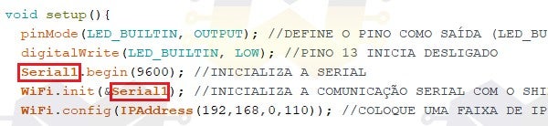

This expansion board keeps the Arduino serial busy, connecting RX from ESP8266 to TX from Arduino and TX from ESP8266 to Arduino RX.
The Arduino's D0 (RX) and D1 (TX) pins correspond to native serial / USB communication, so these pins stay busy whenever we send code to the board or use the serial monitor. Therefore, if the P1 and P2 contacts of the shield are in the ON position, the ESP8266 will be using Arduino D0 and D1 and it will not be possible to send codes or use the serial as it will be busy. In addition, to send AT commands to the shield, it is necessary that the ESP8266 RX is connected to the Arduino RX and that the ESP8266 TX is connected to the Arduino TX. This will only occur if we invert the connections as shown in the image below:
See I've bent the D0 and D1 contacts of the shield, and connected the Arduino D0 to the D1 of the shield and D1 of the Arduino to the D0 of the shield. When using the connection in this way (Arduino being used as a connection bridge), I was able to send AT commands to the ESP8266 and confirmed what I already imagined.
The shield's standard form of operation requires that a code (webserver or firmware, for example) be loaded into the shield and another code is loaded into the Arduino to send, receive, and interpret the data coming through the native serial. More details on this form of communication will be seen in the next steps.
Anyway, this feature of the shield does not interfere in its operation, since we usually emulate a serial on other Arduino digital pins so that we can have the native serial available. In addition, if it is necessary to send AT commands to the shield, we can connect it to the Arduino through four cables or use a serial USB converter.

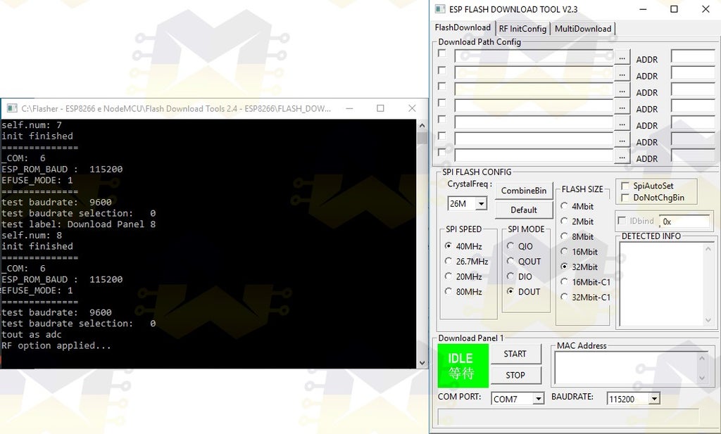

Now go to the FLASH_DOWNLOAD_TOOLS_v2.4_150924 folder and run ESP_DOWNLOAD_TOOL_V2.4.exe:
On the shield, place the P3 and P4 contacts of the DIP Switch in the ON position and then press the ESP-RST button on the card so that the shield enters firmware upgrade mode:
With the program open, uncheck the 'SpiAutoSet' option, select the COM port, select the 'BAUDRATE' 115200, uncheck any checkbox marked in 'Download Path Config', configure the other options as shown below and click 'START':
If communication with ESP8266 WiFi Shield is OK, you will see information in 'DETECTED INFO', 'MAC Address' and 'SYNC':
NOTE: If the program returns 'FAIL', check if you have selected the correct COM port, check if the P3 and P4 keys of the DIP switch are ON, click the ESP-RST button, click STOP and again click START.
In 'Download Path Config' you should select the file 'Ai-Thinker_ESP8266_DOUT_32Mbit_v1.5.4.1-a AT Firmware.bin' downloaded. Click on the '...' of the first field and in the window that opens navigate to the folder where you placed the firmware and select the file 'Ai-Thinker_ESP8266_DOUT_32Mbit_v1.5.4.1-a AT Firmware.bin'. In the 'ADDR' field fill in the offset 0x00000 and check the checkbox to finish. When finished, you will have the settings as shown below:
Now click START to start the process:
NOTE: If you are using the Arduino serial USB converter as an intermediate between the shield and the computer, click on the shield's ESP-RST button before clicking START. If you are using a conventional serial USB converter this procedure is not necessary.
Wait for the firmware upgrade process to complete (it will take approximately seven minutes for the process to complete):
After completing the firmware upgrade process, close the ESP_DOWNLOAD_TOOL_V2.4 windows, return the P3 and P4 contacts of the DIP Switch to the OFF position and press the ESP-RST button on the shield so that it can exit the firmware upgrade mode.

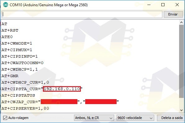

Now open the Arduino IDE so you can send AT commands to the board to verify that the firmware has been updated correctly and that the board is responding to the commands.
With the IDE open go to the 'Tools' menu and then in the 'Port' option select the COM port. Note in the image below that I selected the COM7 port (your port will probably be different):
You do NOT need to select the board in the IDE as this is irrelevant to sending AT commands.

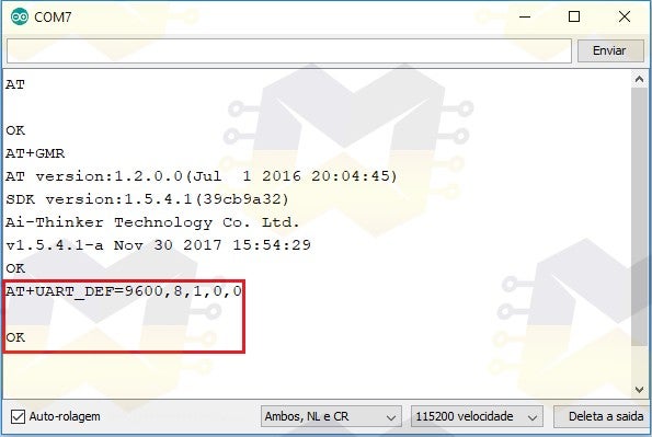

Open the 'Serial Monitor' and in the footer check if the speed is set to 115200 and if 'Both, NL and CR' is selected:
Now type the command 'AT' (without quotes) and give 'ENTER' or click 'Send'. If the connection is working you will have to return the 'OK' message:
NOTE: If sending the command DOES NOT receive any feedback or receives a random character string, change the speed from 115200 of the serial monitor to 9600 and send the command again.
In the 'Serial Monitor' type the command 'AT + GMR' (without quotes) and give 'ENTER' or click 'Send'. If you receive feedback as shown below, then your ESP8266 WiFi Shield has been updated successfully:
If you want to change the communication baudrate with the 9600 shield, enter the command 'AT + UART_DEF = 9600,8,1,0,0' (without quotation) and give 'ENTER' or click 'Send'. If you receive the information as shown below, then the communication speed has changed:
NOTE: When changing the shield baudrate, you should also change the speed from 115200 to 9600 in the Monitor Serial footer. Then send the 'AT' command again (without quotation marks) and press 'ENTER' or click 'Send'. If you receive the 'OK' as a return then the communication is working.
If you want to use the shield to assign WiFi to the Arduino, the ideal communication speed is 9600 baud.

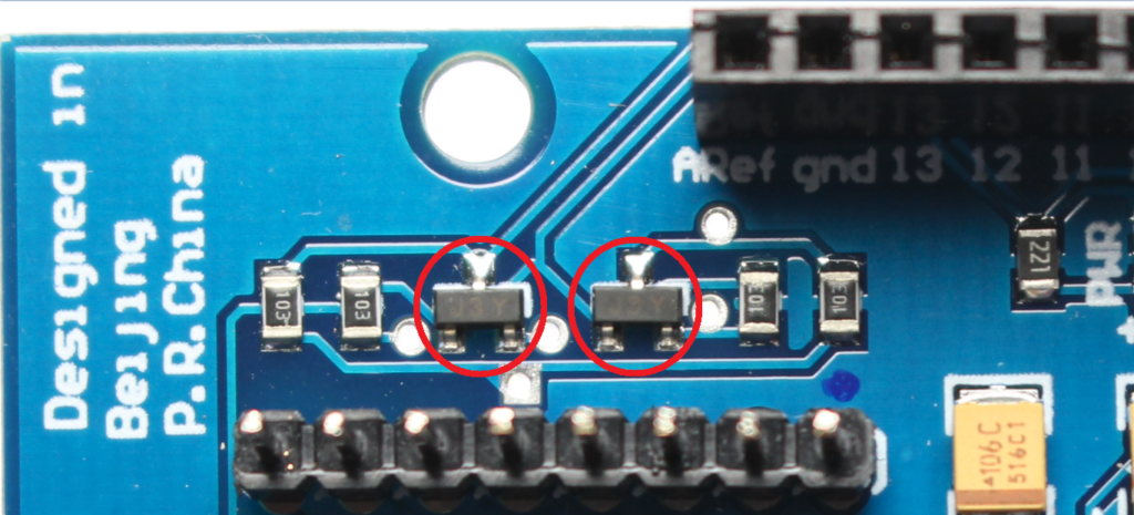

If this board (Moer) is coupled to the Arduino (with the DIP switch contacts OFF or ON) and the user tries to load a code on the Arduino, an error message will appear in the IDE as the load will fail. This is due to a component error used in shield construction.
The shield that has correct construction and operation, has welded two Channel N MOSFETs and are identified as J1Y. One of the J1Y transistors is connected to the ESP8266 RX and the other is connected to the ESP8266 TX. In the image below you can see the two transistors highlighted:
This J1Y transistor is a BSS138 whose purpose is to enable 5V logic level circuits to communicate with 3.3V logic level circuits and vice versa. Since the ESP8266 has a logic level of 3.3V and the Arduino has a logical level of 5V, it is necessary to use a logic level converter to ensure the perfect operation of the ESP8266.
In the shield Moer, there are soldered on the board two transistors identified as J3Y. In the image below you can see the two transistors highlighted:
The J3Y transistor is an S8050 NPN and this type of transistor is commonly used in amplifier circuits. For some reason at the time of the construction of the shield Moer, they used the transistor J3Y instead of the converter of logic level J1Y.
In this way, the ESP8266's RX and TX pins will not work as they should and therefore the shield will not have any serial communication with the Arduino. As the shield communicates with the Arduino through the native serial (pins D0 and D1), with it coupled to the Arduino code loading (in the Arduino) will never be completed successfully, because in some cases there will always be approximately 2.8V in the RX and Arduino TX or constant 0V, all because of the wrong transistors.
After all this information, it is clear that the only solution for the shield Moer, is the replacement of J3Y transistors by J1Y transistors. For this procedure you will need in addition to the Moer shield of patience, and:

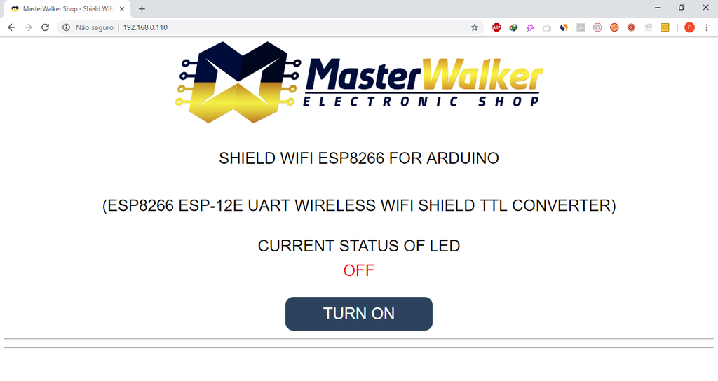

Step 5: Web Server With ESP8266 ESP-12E UART Wireless WIFI Shield TTL Converter for Arduino
As a primary requirement to continue this step, you should have performed step 2.

If you are using Arduino Leonardo, go to lines 19 and 20 of the code, and change the word Serial to Serial1, as shown in the image below:

Immediately open the Arduino IDE serial monitor:
With the serial monitor open you can follow the AT commands that are being sent to the shield to run the webserver. If no information is displayed when opening the serial monitor, press the RESET button on your Arduino and wait.
Note that on the serial monitor the command "AT + CIPSTA_CUR" shows the IP address to connect to the webserver and the command "AT + CWJAP_CUR" shows the name and the password of the wireless network in which the shield is connected:
Copy the IP address shown on the serial monitor, open your internet browser, paste the IP address and press ENTER to access. A webpage similar to the one below will be loaded:
The web page has a button that will be responsible for turning on / off the LED connected to pin 13 of the Arduino. Press the button to turn on / off the LED and see that the current status is updated on the page.
You can also access the web page through a smartphone or tablet, for example.
