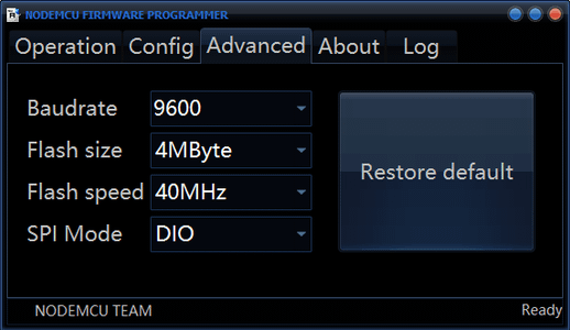

Flashing is needed if you want to change the way the ESP8266 operates. It is impossible to brick the ESP8266 through flashing. If a flashed software does not perform as expected -or performs not at all-: reflash! Keep the flash program parameters at default; except baud rate: first try default, if that does not work try other rates.
Most MCU's have 4M flash size, 40MHz flash speed and use DIO as SPI Mode and 512k+512k memory.

Step 5: Using the Flash Tools
One step I almost forgot: how to use the flashtools.
Either of the two tools I mentioned above need the following to work:
1. start execution with administrator rights
2. start execution from the folder where you installed the program
3. parameters to be allocated:
A. Crystalfreq: default (26MHz)
B. SPI speed: default (40MHz)
C. SPI mode: default (QIO or DIO)
D. Flash size: default (4Mbit)
E. Comport: the one where your serial adapter is connected to (verify in Device Manager)
F. speed: default, or adjust to 115200, or any other speed where the ESP8266 responds to
