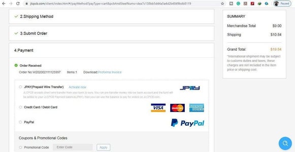

Step 7: Select Shipping Address and Payment Mode
6. Type the Shipping Address.
7. Select the Shipping Method suitable for you.
8. Submit the order and proceed with the payment. You can also track your order from JLCPCB.com.
My PCBs took 2 days to get manufactured and arrived within a week using the DHL delivery option.

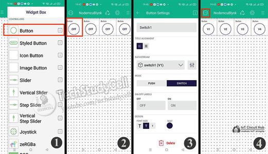

Step 11: Add Widgets in Blynk IoT App
  1. Add 4 Button widgets from Widget Box.
  2. Go to Button widget settings.
  3. Enter the name, select Datastream, Mode will be Switch. Then exit.
  4. After configuring all the Buttons tap on exit.

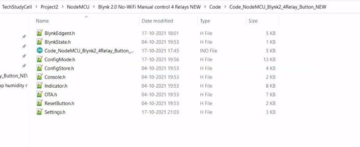

Step 12: Program the NodeMCU ESP8266 for This Blynk Project
First, download the code from the following link.
Click Here to Download Code
  1. You have to keep all the 9 files in the same folder.
  2. Open the .ino file in Arduino IDE.
  3. In the code, you have to update the BLYNK_TEMPLATE_ID and BLYNK_DEVICE_NAME.
  4. For this project, you have to install the Blynk 1.0.1 library.
  5. Now select the NodeMCU 1.0 board and proper PORT.
  6. Then upload the code to NodeMCU Board.
