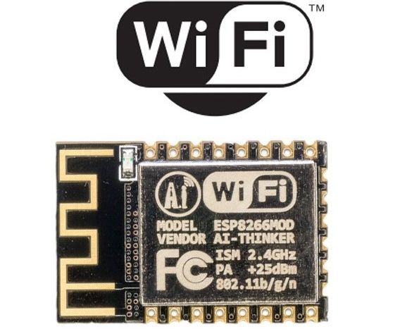

You will need an ESP8266 NodeMCU, ESP8266
WeMos, or ESP8266MOD module on an adapter board and a USB-UART dongle like the one described here.
Additionally, you will also need a couple of I2C devices to test. I had a real-time clock module DS1307 and a 0.96-inch OLED SSD1306 which I will use for the test and demonstration.
A set of hook up wires.
