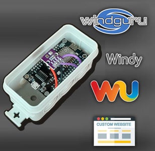

I make a micro weather station with few and extremely cheap materials (less than 10 euros).
As a base I use a Nodemcu ESP8266 board, which is programmed like an Arduino and a small board with two high quality sensors (AHT+BMP280). The intention is to collect some meteorological parameters such as temperature, humidity and atmospheric pressure, and to be able to view them through any device connected to the Internet such as a mobile phone or a PC.
I use the Ardubridge.com platform as a gateway to send the data to Windguru, Windy.com and WeatherUnderground, as well as generating my own custom site on the same platform.
The source code to use is really small, I only have to make the connection with a website, then the platform sends the data to the other websites on behalf of my station. My custom page in Ardubridge looks like this: see micro weather station.

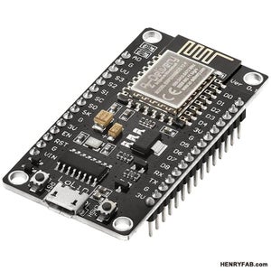

  1. NodeMCU esp8266 V3 board (aliexpress, amazon)

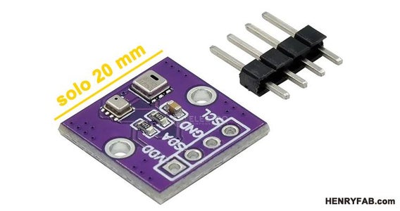

  2. AHT20+BMP280 sensor (aliexpress, amazon)

Explanation of the electrical diagram: The NodeMcu board can be powered by the VIN (+) and G (-) pins with 5v DC or with a simple micro USB cable and a mobile phone charger, which applies the same 5v voltage. From the 3V (+) and G (-) pins, we get a 3.3v power supply for the AHT20+BMP280 board. I usually use red and black cables for positive and negative DC power. Through the D1 (SCL) and D2 (SDA) pins we connect to the pins of the same name on the sensor board. For the data communication cables I usually use purple cable, in this case the communication is via I2C protocol.

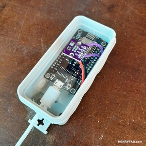

Step 2: Assembly
We machine a hole in the lower area of ​​the register box to later pass the USB cable through. We can do this operation with a drill and a bit, or with a small file.
Don't worry if the hole is too big and you intend to put your station outside, this hole will stay in the lower area and water will not get in. We insert the main board inside the small register box, in our selected box, from the manufacturer Famatel, I must say that it fits like a glove. See the following photograph.

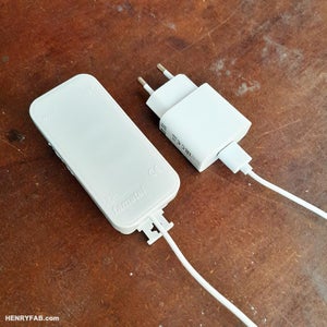

Then, to avoid problems with short circuits and unwanted connections, we insert a small transparent acetate sheet between the main board and the sensor board. We connect the USB cable at one end to the NodeMCU board, at the other end to a typical mobile phone charger.

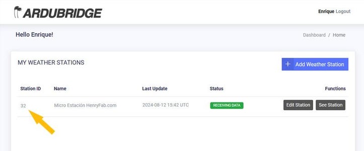

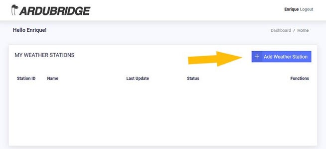

* Before uploading the code to our board, we must register in Ardubridge, register a new station in the panel and obtain the station id and station password. We will start by registering in the FREE SIGNUP area with our name, email and password, remember to verify the email by clicking on the email received.
* Once the email has been verified, we log in to the page. In the panel, we register the new station with Add Weather Station as in the following image. In the station registration form we will be asked for the API or station password, we must invent one so that only we can send data on behalf of our station.
* Once the station is registered, we will see that a new row is generated on the main page of the panel with the main information of our new station. One of the main data is the status, to verify if everything is synchronizing well, initially the status will appear as PENDING DATA in red, when we start sending data, it will change to RECEIVING DATA in green. On the left side we will see the station id that has been assigned to us, which together with the station pass, we will use in the next step to load the programming and start sending meteorological data.

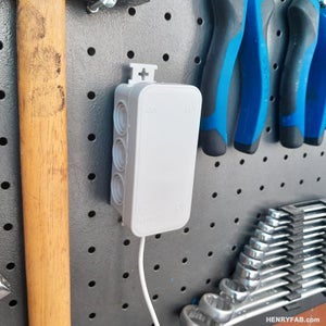

Afterwards, you just have to leave our mini station connected via USB to a mobile phone charger.

With the steps above completed, our station status will soon be in RECEIVING DATA mode with a green background. On the right we will see SEE STATION to see our custom page with the data we are already sending.
