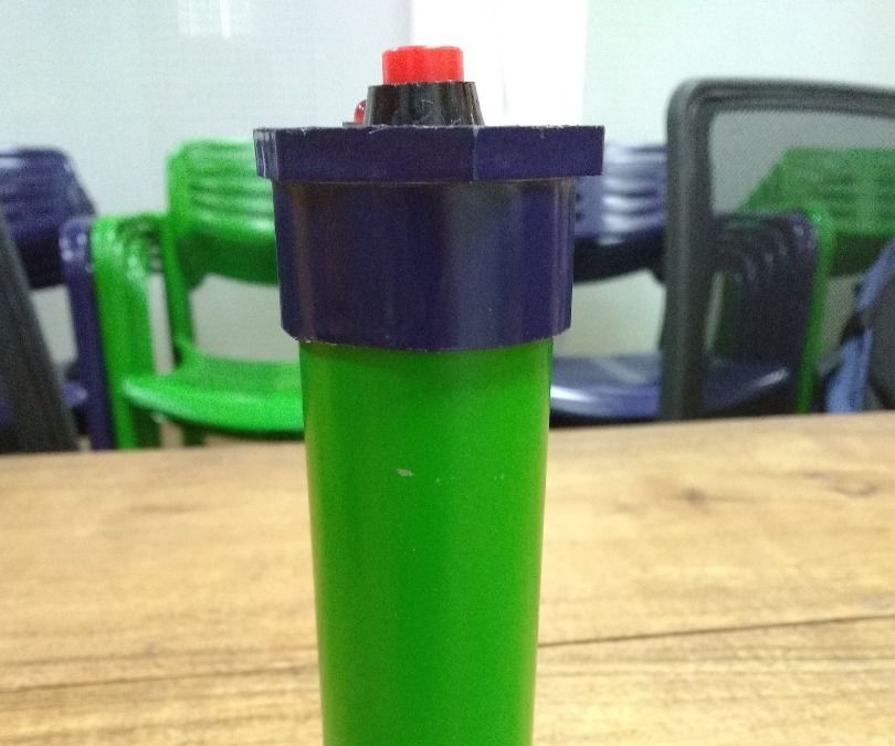

Step 1: Enclosure
We purchased an empty Camera dome and fitted everything inside it.
A hole was made using a dremel to expose the DHT11 sensor to the external environment.
The connections were made using a general purpose PCB with holes, and we spent a lot of time figuring out how to fit everything inside the dome.
Another hole was made in the bottom of the case to accomodate a 9v DC barrel jack. This was then glued in place.
