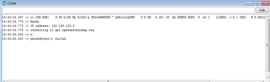

const char *weatherHost = "api.openweathermap.org";
void getWeatherData()
Serial.print("connecting to "); Serial.println(weatherHost);
if (client.connect(weatherHost, 80)) {
client.println(String("GET /data/2.5/weather?id=") + cityID + "&units=metric&appid=" + weatherKey + weatherLang + "\r\n" +
"Host: " + weatherHost + "\r\nUser-Agent: ArduinoWiFi/1.1\r\n" +
"Connection: close\r\n\r\n");
} else {
Serial.println("connection failed");
return;
String line;
int repeatCounter = 0;
while (!client.available() && repeatCounter < 10) {
delay(500);
Serial.println("w.");
repeatCounter++;
while (client.connected() && client.available()) {
char c = client.read();
if (c == '[' || c == ']') c = ' ';
line += c;
client.stop();
DynamicJsonBuffer jsonBuf;
JsonObject &root = jsonBuf.parseObject(line);
if (!root.success())
Serial.println("parseObject() failed");
return;
//weatherMain = root["weather"]["main"].as();
weatherDescription = root["weather"]["description"].as();
weatherDescription.toLowerCase();
Serial.println(weatherDescription);
