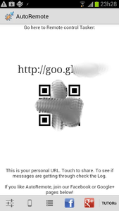

Step 4: Setting Up AutoRemote
Download AutoRemote to your device, then open it up and follow along with the pictures. When you copy the key, make sure you do not copy the = or the &, only what's in between them. When you paste it into the code, make sure you paste over the <> brackets.
