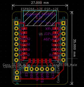

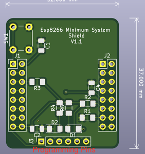

When designing the minimum circuit PCB in the step 2 for Part 1 of this tutorial, you may have observed that we exposed some pins for programming. We have there the following pins:
- GPIO0 - Flash pin
- RST - reset pin
- TX - Transmission line
- RX - receiver line
- GND - ground pin
- VCC - power pin. Remember ESP8266 is a 3.3 V device
Looking at the schematic for the programming, we will need to have a pair of transistors to handle the state of the pins according to the signals from DTR and RTS pins of the FTDI.
