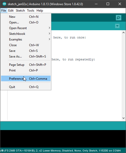

Step 1: Configuring ESP8266 NodeMCU
For this project, we are using ESP8266 NodeMCU microcontroller because it is a very small and cheap WiFi capable microcontroller that is now commonly used for any IoT projects. In this step, we will just configure the ESP8266 NodeMCU so that there won't be any miscommunications throughout the project.
You can skip this step if you have configured your ARDUINO IDE to connect ESP8266 NodeMCU.
Now first off, to test the ESP8266, we have to make sure your ESP8266 NodeMCU can connect to the Arduino IDE. You can download it here and after installation open Arduino IDE.
Select Preferences under the File Tab and copy this link into Additional Boards Manager URLs: http://arduino.esp8266.com/stable/package_esp8266com_index.json
Then open Board Manager under the tools tab, from there use the search bar to search ESP8266 by the ESP8266 Community, install that package and restart your Arduino IDE.
In this project we will be using NodeMCU 1.0 (ESP-12E Module), you can choose this under the Tools tab close to where Board Manager is located.
In the pictures above, we have given step by step direction.

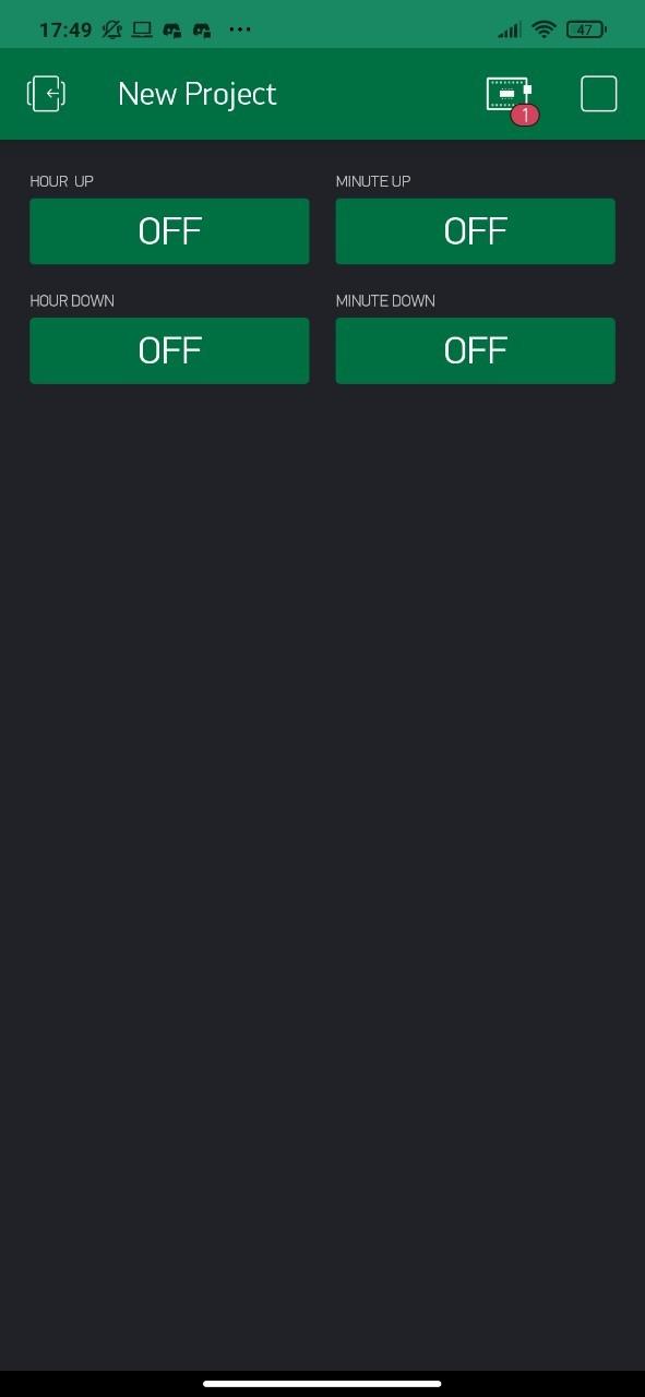

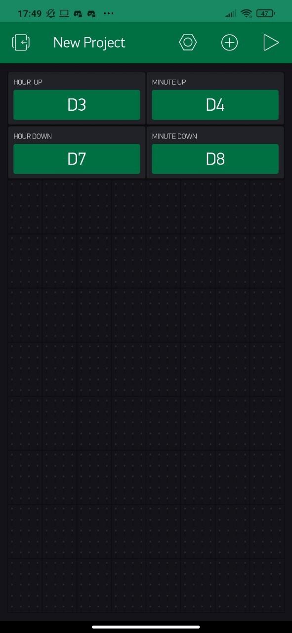

Step 5: Using the Blynk App
What we will be using to control all of the components together is with Blynk, it is an IoT platform that was designed specifically for IoT applications.
How it works is through the Blynk App where we need to design with many kinds of widgets that suits your needs, through the app it connects to a Blynk server which will be responsible for running the communications from our smartphones to our hardware.
We can run a private local Blynk server as it is open-source and easily handled by small computers such as a Raspberry Pi. All that we need to use Blynk are two things, hardware and a device.
Make sure to download the Blynk App on your Android, IOS, or any other device.
After downloading, you need to create a new account. After that, create a new project. An authentication token will be sent to your email. This token needs to be saved. It should be put in the code. It's used so that the NodeMCU can connect to specifically the Blynk app that we're building.
The Blynk application is really simple, just need 4 unused pins on the NodeMCU, use it as push buttons, and that's it.
