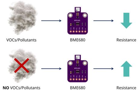

The BME680 features a MOX (Metal-oxide) sensor that detects VOCs in the air. This sensor provides a qualitative indication of the total VOCs/contaminants in the environment, though it does not identify specific gases.
MOX sensors have a metal-oxide surface, a sensing chip to measure conductivity changes, and a heater. They detect VOCs by adsorbing oxygen molecules on the sensitive layer. The BME680 reacts to most indoor air pollutants (excluding CO2).
When the sensor encounters reducing gases, the oxygen molecules react, increasing surface conductivity. The BME680 outputs resistance values as raw signals, which vary with VOC concentration:
  • Higher VOC concentration → Lower resistance
  • Lower VOC concentration → Higher resistance
The sensor’s surface reactions (and thus resistance) are also influenced by temperature and humidity.

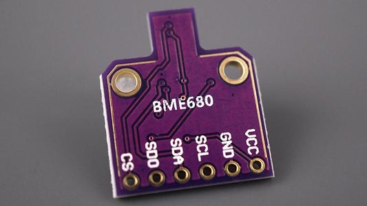

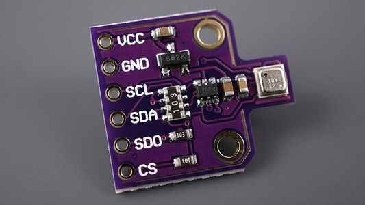

Step 2: BME680 Pinout
Here’s the BME680 Pinout:
VCC: Powers the sensor
GND: Common GND
SCL: SCL pin for I2C communication / SCK pin for SPI communication
SDA: SDA pin for I2C communication / SDI (MISO) pin for SPI communication
SDO: SDO (MOSI) pin for SPI communication
CS: Chip select pin for SPI communication

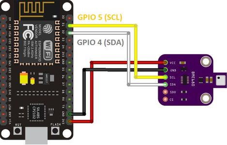

ESP8266 with BME680 using I2C
To connect the BME680 to the ESP8266 using the default I2C pins, follow the schematic diagram below.

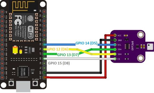

ESP8266 with BME680 using SPI
If you prefer to use the SPI communication protocol, follow the corresponding schematic diagram to connect the BME680 to the ESP8266 using the default SPI pins.
