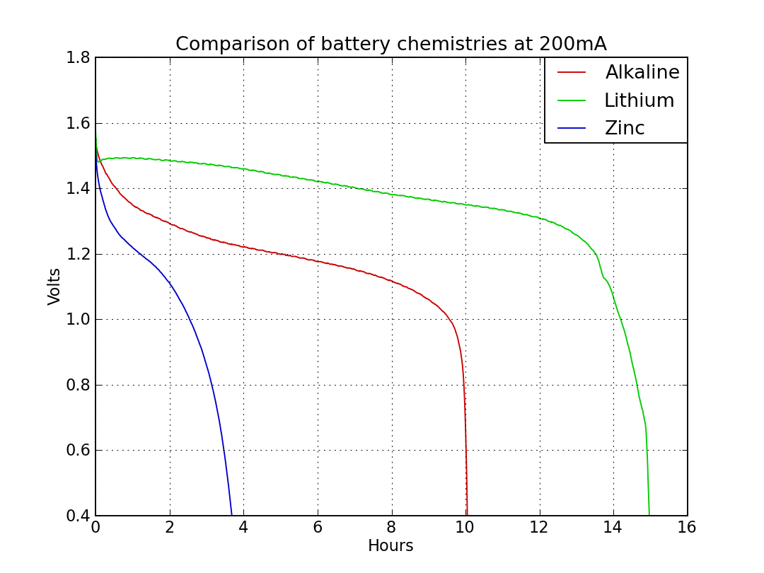

I mentioned the possible battery technology that can be used to power up ESP module. Now, let us analyze one by one. First, consider non-rechargeable AA & AAA size battery because they are most commonly available and inexpensive one. Zinc-carbon and Alkaline type AA and AAA size battery (or cell) have an output voltage 1.5 volts. So, at least two battery with a series connection (to make 3 volts) is required to power up an ESP module because according to data sheet at least 2.5 volts is required to power up an ESP module.
Now, let calculate the run time of two batteries connected in series. If we connect two battery in series the ESP will live until each battery voltage drained to 1.25 volts. From the discharge curve below it is clear that for a zinc-carbon battery about 25% capacity can be used before the voltage reduced to 1.25 volts. So, it can not be a good solution. If we use two Alkaline battery we can use at best 30% which is approximately same as Zinc-carbon battery.
If we use Lithium battery we will get an interesting result. We can get at least 70% energy from a Lithium battery before going cut-off level.
So, in a single sentence, I can say that we should not use two Zinc-carbon or Alkaline cells in series to power up an ESP module if we don't like to keep 75% energy unused in the battery before throwing it. But, we can use a Lithium battery to power up an ESP module. Lithium batteries are most common in button or coin form. A typical Lithium coin cell has the output voltage of 3 volts which is perfect for powering up an ESP module. But before taking the final decision we should consider another important parameter of the battery, maximum discharge capacity or maximum current supply capacity in a simpler term. Most of the coin cell cannot provide more than 20mA! The average current taken by an ESP module is 80mA. So, a standalone coin cell is not enough to provide sufficient current to power up an ESP module. A parallel capacitor can give a good result but required some experimentation to know the exact response.

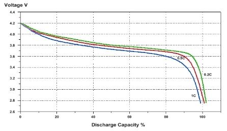

Now investigate the rechargeable group. The most common rechargeable battery used today is Lithium-Ion battery. Lithium-ion batteries are available in different size and dimension. The output voltage of a Lithium cell is 3.7 volts and capacity depends on the size of the cell.
From the above discharge curve of a Li-ion battery, it is clear that though the nominal voltage of a Li-ion battery is 3.7 volts, a fully charged Li-ion battery voltage starts from 4.2 volts which is more than the tolerable limit of an ESP module. So, Li-ion battery should not directly connect to ESP module.

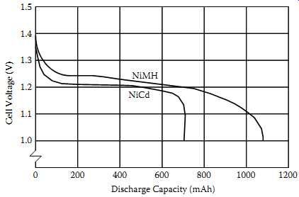

The output voltage of both Nickel-metal hydride & Nickel-cadmium cell is 1.2 volts. So, if we connect three cell in series than total output voltage will be 3.6 volts which is within the tolerable limit of an ESP module. The open circuit voltage of a fully charged Ni-Cd can be 1.3 volts. So, connecting three we get 3.9 volts which I think will not create any problem in ESP module.
So, three Ni-Cd or Ni-MH cell in series can be connected directly to power up an ESP module.
Now the second question comes. How much energy can we get from the battery? From the above discharge curve, we find that both cells provide their maximum energy before reducing the voltage to 1.1 volts. So, when three cells are connected in series the total voltage is 3.3 volts at the end of the life cycle of the battery and this voltage level is far greater than the minimum level of the ESP module. So using Ni-Cd or Ni-MH battery we can use most of the energy (above 80%) before going to recharge the battery.
Ni-MH battery has greater capacity comparing to Ni-Cd. Other characteristics of Ni-Cd and Ni-MH is almost same. So, three Ni-Cd or Ni-MH cells in series can be a good choice for powering up an ESP module.
From our above discussion, it is clear that we can not use Li-ion cell directly to the ESP module. We should not use two Alkaline or Zinc-Carbon cells in series because we will get only 25-30% usable energy from the battery. So, now the important question is that if I used 3 Alkaline or Zinc-Carbon cell in series what will happen? Let analyze the fact.
