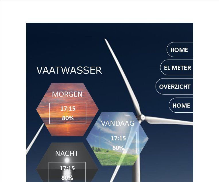

Our electricity suplier is a local wind farm. Of course we are just connected to the regular grid, but in a way I never thought it to be fare I could just switch on the dishwasher on windless days. So I integrated a live feed for predicted wind energy supply from the national grid manager (Elia, Belgium). With this information I can decide when I can switch on the dishwasher. At this time I am waiting for the components to build a smart wifi power plug to switch the dishwasher at the best calculated time in function of the available wind energy.

The first page on the browser is the actual electricity consumption. On the next page you can check out the daily use per hour. The third page gives the wind energy forcast and actual production, displayed in a Google chart.
And finaly the magic happens : I check out the acutal electricity consumption on the browser. If we don't use too much at the time, I check out the wind forcast. And when there is enought wind I switch on the dishwasher with my right index finger.

Step 4: In the Browser
In your browser you can connect to 4 pages :
- actual consumpion of electricity
- selection page on which date you want more detailed info
- daily consumption, per hour
- windforcast
actual consumption (meter.php + meterstand.php)
the meterstand.php program calls 2 SQL commands in the ElectMeterMeter table in the SenisHome database on the Raspberry Pi.
- the latest entry in the table, which is the acctual consumption
- the total number of spins of the wheel, multiplied by 375 (375 spins = 1 kWh)
The meter.php acctualy runs an ajax command to refresh. The main advantage of this method is you don't realy refresh the page, but only the data. So the meter.php page gets it's data from meterstand.php and updates every 5 seconds.
note : the data is updated every 5 seconds, but this does not mean there is new data ! In my case, 1 kWh = 375 spins. The sensor only fires a message to the database after a full turn. So on high consumption, there is new data in less than 5 seconds, however on low consumption it can take several minutes before an update.
With the 2 buttons on the bottom you can go the windforcast page or the daily consumption
Selection page + daily consumption(datepicker.php + dagverbruik.php)
First you get the selection page, where you pick a date for the more detailed info you want to see.
From there you are redirected to a Google Chart, with the consumption per hour.
Windforcast (WindFor.php):
This is the windforcast + actual production. It is a 3 day forcast, in a simple Google Chart. The lightblue line is the forcasted production, the darkblue is the actual/hystoric production.
(open the files in a notepad program)
