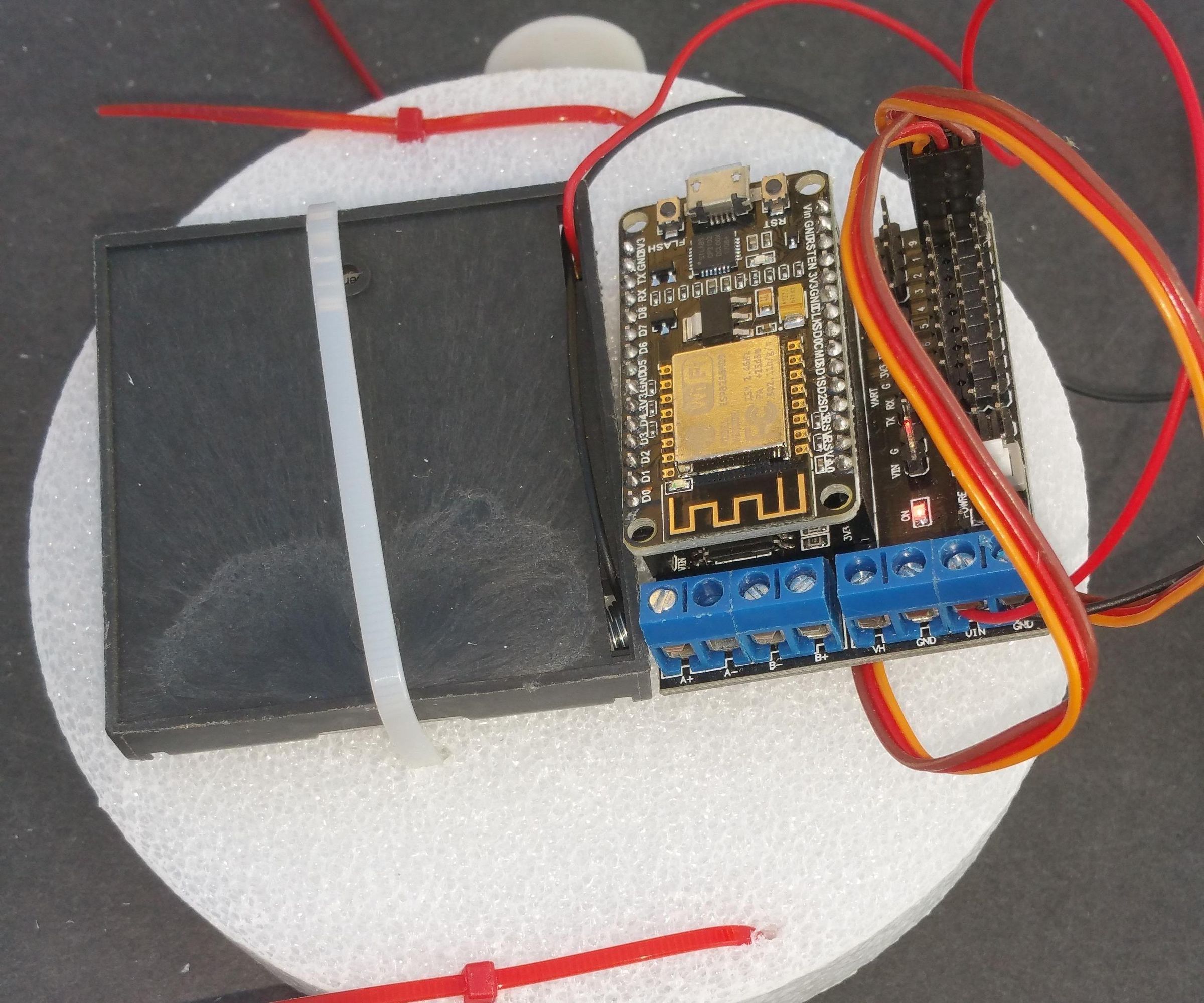

Step 2: Solder Wires to Motors ... Then Connect to Motor Driver Board
I used 4 wire male-female jumpers which I cut in half. This way, after you connect wires to motors and driver board, all you need to do is connect male end with female end for final connection. This also makes routing wires a bit easier, but is not necessary, you can use 4 wires (2 for each motor) to connect motors to board.
You will need to solder wires to the motor so that you can connect motors to the driver board.
I used hot glue to keep wires in place as a form of stress relief.
Step 3: Put Together Your Car...
If you bought the car kit, then assemble according to the poorly translated directions...but it's not to hard, pretty self explanatory.
Step 4: Put Together Your Car ... Continued ..
If you are going DIY, it will go a bit faster, provided that you use zip ties / hot glue / duck or packing tape to assemble yours as I did mine.
Connect motors/wheel assembly to chassis and route wires to motor driver.
Step 5: Make All the Connections
Now, you need to connect motors and power wires to driver board. You also might have to plug in ESP8266 to driver board. Once everything is connected and secured, use micro USB cord to plug into your computer.
Connect power from battery pack to ground (black) and Vin (red).
Connection wires from one motor to a+ and a-, connect other motor wires to b+ and b-.
Connect Vin to Vm with a jumper.
