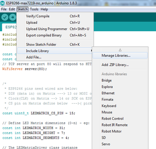

Step 3: Add the LED Matrix Library
The LED Matrix Library:
I was unable to compile the library I used on the Arduino so I had to switch to a different one. I picked the "LEDMatrixDriver"
To install this LEDMatrixDriver library:
  • In the top menu bar click "Sketch"
  • Then click "Include Library"
  • Then click "Manage Libraries..."
  • You will be given a list of libraries. Use search and find the LEDMatrixDriver
  • Click "Install"
