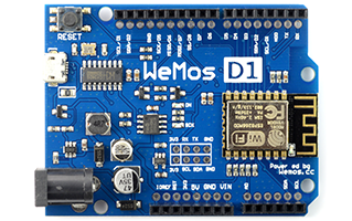

- Wemos D1 R2

Step 3: Software ESP8266
The electronic part is assembled on the ESP8255 WEMOS D1 R2 prototype board.
The controller software allows you to control each element of the heater via the Internet and to work in automatic mode. The thermostat function is also implemented.
Remember to include all necessary libraries for the code to compile.
If someone wants to experiment with the software, they can do it online via the OTA system.
