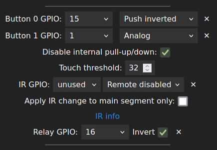

Step 4: Button Feature
The middle prototyping area is used to connect one button and and one potentiometer. Buttons are described in the macros section of the documentation.
The button switches the 3.3V to the D8 pin on the bord (GPIO 15 on the ESP8266). It has to be configure as an inverted push button because the D1-mini as an internal pull-down on this pin. See D1-mini's schematics. I don't use the default button location (GPIO0 - D3) because it will be used by IR remote in few steps.
Navigate to the LED setting page for your WLED device or by adding /settings/leds to its' address - for example, https://my-led-device.local/settings/leds to configure the button.
Behavior of the button is configured in the "settings -> Time and Macros" menu. Select preset 0 on short - long - double push to keep default (built-in) actions :
  1. short-press: toggle on/off
  2. long-press: select random color
  3. double-press ?? I don't know (when local graphic user interface is set-up, it displays network information on double click)

Step 5: Potentiometer Feature
An intuitive way of driving brightness is to use a potentiometer. It is called analog button in the documentation.
The circuit simply consist of a voltage divider : 3.3V on one end, GND on the other end an finally A0 pin for the middle point of the potentiometer. Follow the documentation to use that analog button for global brightness. But "be aware that wled is configured to turn off when the potentiometer is adjusted to either extreme - both maximum and minimum adjustments". So that's why you can see resistances at each end of the potentiometer on my diagram. I've mounted theses resistances on female socket to easily adjust their values. The documentation takes as example a 10kΩ potentiometer with 750Ω and 500Ω resistances. Because of what I got in stock, I used 50kΩ potentiometer with 2.7kΩ resistances. My diagram shows documentation value and mine in parenthesis.
Navigate to the LED setting page for your WLED device or by adding /settings/leds to its' address - for example, https://my-led-device.local/settings/leds to configure the analog button as Button 1. As you can see I've configured the GPIO to 1 wich is the TX pin but the documentation says "On ESP8266, you can only have a single analog button on pin A0, the pin set in the settings UI is ignored.".
Then configure the button 1 for global brightness in the "settings -> Time and Macros" menu (https://my-led-device.local/settings/time) : the Short and Long columns set to 0, the Double column in Button Actions to 250.

Navigate to the LED setting page for your WLED device or by adding /settings/leds to its' address - for example, https://my-led-device.local/settings/leds to configure the relay feature. As said in the documentation : "Many relays are powered when the signal is LOW" so do my relay board and therefore configured as "inverted". GPIO16 (D0) on my case or GPIO5 (D1) for the non modified board.
