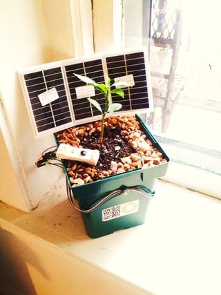

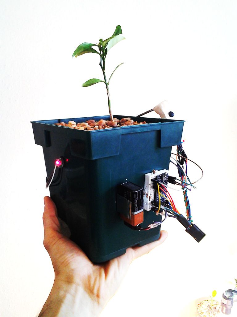

    this looks fun. i have done something similar. i really like the webpage interface. is that from the easyiot software?

    Akin Yildiz
    Akin Yildiz
    Reply 6 years ago on Introduction
    have you seen the plant doctor family ? the reason i chose ESP is that so I don't have to have a base, like raspi to capture data. NRF24L01 is bluetooth right? forgive my simple questions, i'm a true beginner. I am trying to put my system into plant pots and make it run on battery. it needs to be usb-rechargable as well. size/mobility is an issue. for model making my current setup is the smallest in size... i need a lot of help making my system more advanced/stable - especially better battery time. wouldn't you say using a wifi system be more universal/mobile. I can take my plant to anywhere with wifi and it will start uploading data.?!
    0
    EasyIoT
    EasyIoT
    Nice. NRF24L01 is not bluetooth. If you are using ESP on battery, then put it in sleep mode or it will consume too much battery. See my webpage for Arduino low power tips. Some of my sensors will work 10 years on 2 AA alkaline batteries. You can join forum and ask questions.
