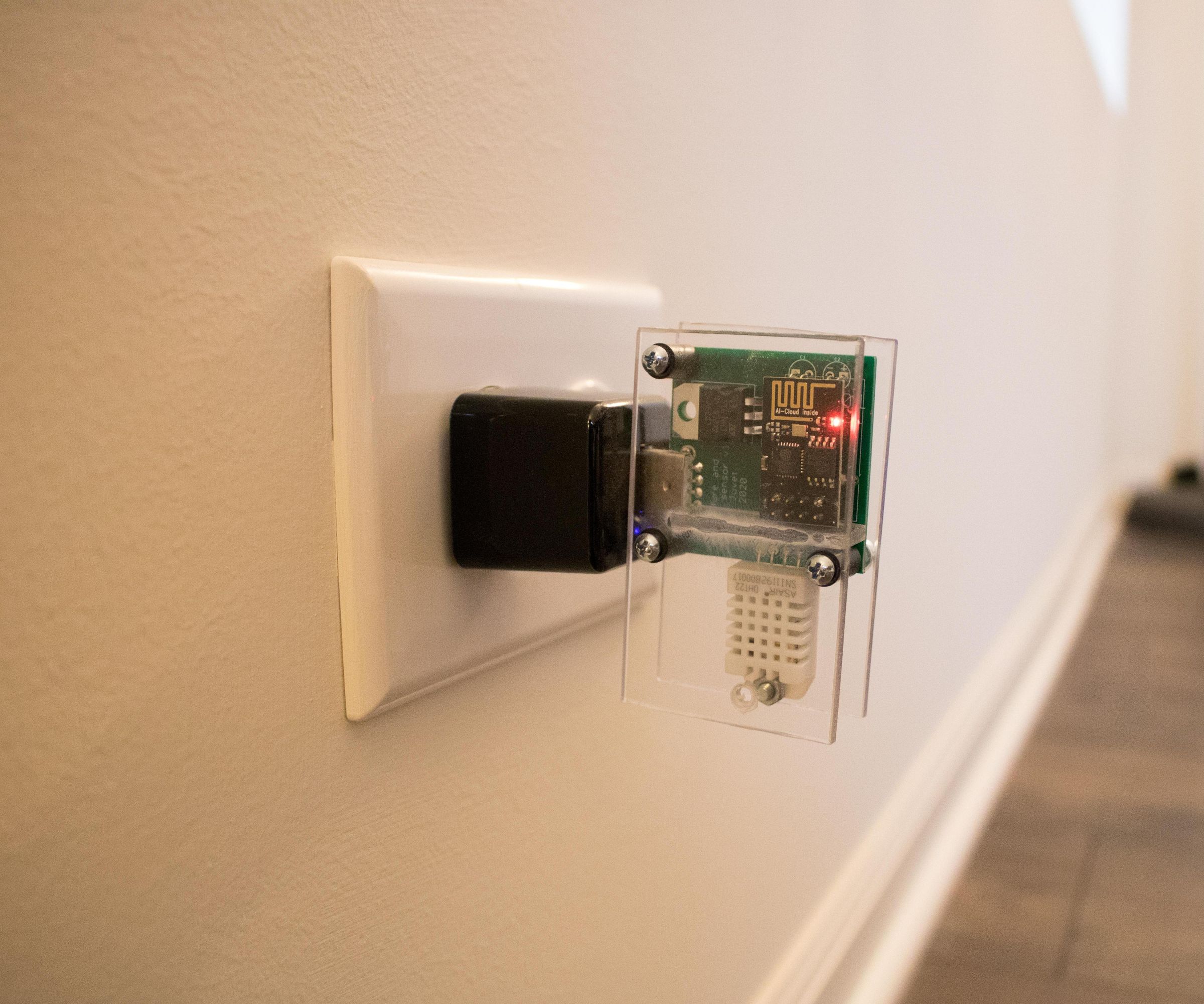

Introduction: ESP8266 Wifi Switch
In this tutorial I'm going to show you how I made a wifi switch from scratch (or almost) using the well known ESP8266.
The idea is the following: I want to be able to turn on/off several lights or devices connected to the power supply from my phone. I don't want the switch to rely on a battery. The switch will need to connect to 1 of 2 preprogrammed wifi. I want to be able to make groups of switch, and turn them all on/off by the push of 1 button. I want to be able to turn it on/off at a specific day and time using a timer. And I don't want to pay more than a total of $30 per switch, since I want to make a dozen of them.
The components won't be put on a breadboard, but rather soldered on a PCB, in order to make the switch as small as possible, and to be able to handle the high power.
The interface between the switch and the phone will be managed by the Blynk app.
The end result is shown above: you simply connect the male plug to the wall socket, your device that you want to control to the female plug, and voilà! You can control it with your phone.
Since this is one of my first projects of this kind, I made a few mistakes that I realized afterwards. I'll note the improvements that can be made in this tutorial, along with the version 2 of the PCB. Please note that I haven't printed the version 2, so I have no idea if it actually works.
I'd like to point that I'm new to this field, so I might not use the correct terms: be gentle!
