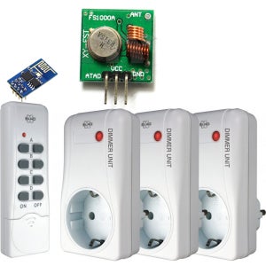

Obviously that is a big overhaul and one of the first things I wanted to check is how well my 433 Mhz switches could be integrated with an ESP8266.
As such code might be beneficial to others, I thought I'd publish it here.
The 433 Mhz library I use is the enhanced RemoteSwitch library. (link dead. try here) I find that a bit more pleasant than the RCSwitch library because for many (not for all) remote switch sockets you do not need to sniff any code. Just knowing what type of Switch you have is enough.
The example below switches 4 sockets. I have explained the use of those switches with the RemoteSwitch library in another instructable. Obviously I switch many more in my house, but I wanted to keep things simple. I am using an ESP8266-01, the simplest of the ESP8266 modules. I use GPIO2 to connect to the signal pin of a 433 MHz transmitter and feed everything with 3.3 Volt. As the ESP8266 is working on 3.3Volt, the transmitter is also working on 3.3Volt. I didnt notice any problem with that, but it is better to use a decent antenna that is easy to make, rather than just a 1/4 wavelength rod. Under no circumstance put 5 volt on any of your ESP8266 pins. If for whatever reason you need or want to feed the transmitter with a higher voltage, then I presume it is ok to still connect the GPIO2 pin to the data pin of the transmitter, as I presume that doesnt carry a voltage (but better do not risk it), but the transmitter may not recognize the ESP8266 output as HIGH. Adding a levelconverter may be necessary then, but to be clear: It works well with 3.3 Volt for the transmitter
