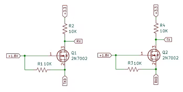

Step 2: Problems in Interfacing:

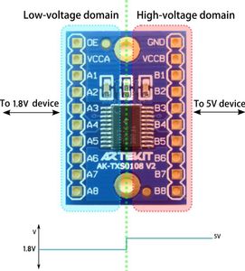

As you know RYS8830 is a low power GNSS module and works on a voltage logic of 1.8v (max). here the problem is in voltage logic matching, because we can communicate on the high logic data line this will damage the module. Our ESP8266 NodeMCU works on 3.3volts, to solve this problem we have to design a logic level convertor. And using the linear regulator we can power up the both sides of logic level convertor with different voltages.
A logic level convertor is a device which is used to match the logic data convey on data power lines. Here I have shown the basic principle with the help of diagram. Either we can design the logic level convertor using 2 similar field effect transistor or there are CMOS IC available in market which will do the same. I have one lane around me here which supports up to 8 channel and the basic operational diagram is given below. you can see the datasheet of my logic level convertor (TXS0108E) from here.

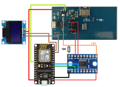

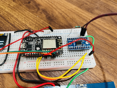

Step 3: Circuit Description and Interfacing:

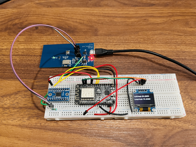

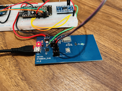

This EVB board already have 1.8v linear regulator, we can use the same to power up one side of logic convertor. Additionally, I removed some jumpers from the board to set the communication protocol to UART. All the info about the EVB board is shared in the datasheet provided by official vendor(RYS8830_EVB). A small OLED screen to display the co-ordinates interfaced via I2C bus to ESP8266.
The connection of RYS8830_EVB to NODEMCU:

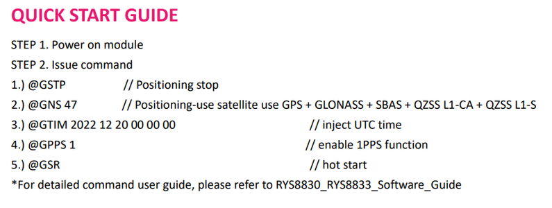

ss.print("@GSTP\r\n");//positioning stop
delay(500);
ss.print("@GNS 47\r\n");// Positioning-use satellite use GPS + GLONASS + SBAS + QZSS L1-CA + QZSS L1-S
delay(500);
//ss.print("@GPPS 1\r\n");// enable 1PPS function
// delay(500);
ss.print("@GSR\r\n");// hot start

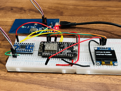

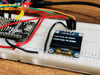

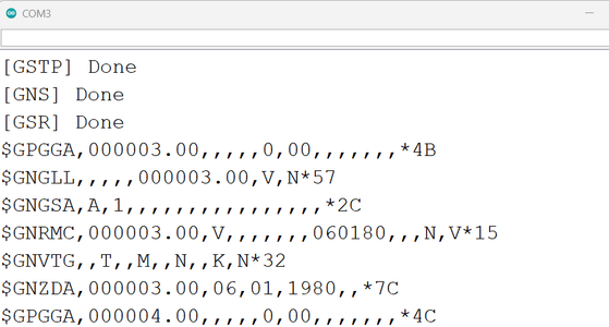

Step 6: Working and Testing of GNSS:
The code is designed to display the co-ordinates readings out of GPGGA and GPRMC. The co-ordinates can be searched online to get the proper location. The GNSS sensor interface only works with the same connections as mentioned in the above given code. Corresponding readings can also be seen on the serial monitor as well.
