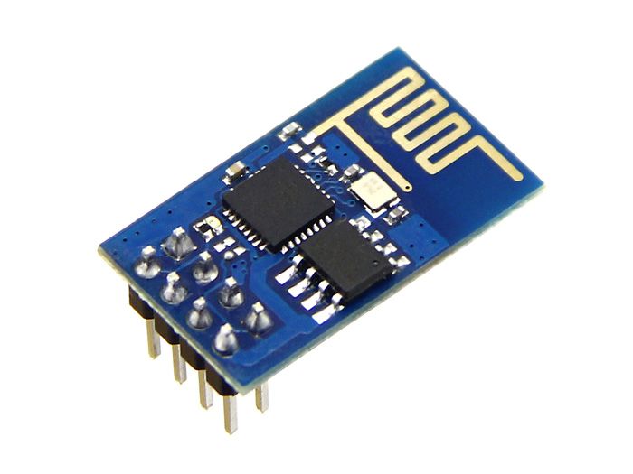

Although the ESP8266 -07 and -12 only have one ADC pin, it doesn't mean that you are limited to only one analog sensor per module. You can use many!
However, in order to use multiple sensors you will need to 'multiplex' the sensors. Multiplexing simply means that you will turn a sensor on, read the sensor, then turn the sensor off then move to the next sensor.

For this project I am using three analog sensors. A photoresistor, a thermistor and a sliding rheostat.
These are what I had in the parts box. Feel free to substitute.
I used:
ESP8266-12, a -07 will also work. Three available GPIOs are needed for this project.
ESP Flashed with NodeMCU, required for this demo.
2 10K resistors
1 680R resistor
3.3v voltage regulator (if necessary)
1 Photoresistor (LDR)
1 10K Thermistor
1 10K Slider
3 Diodes (I'm using 1N4007s)
The values of the resistors used are dependent on the analog sensors. Notice I am using no resistor with the slider.
There is considerable trial and error in setting this up, trim pots come in very handy.
The Diodes are the key to isolating the sensor circuits not being read. Diodes restrict current to one direction. Without diodes the sensors still work, however they interact with each other. For instance, shining a light on the LDR will raise the value at its GPIO, however it will also reduce the value of the other sensors. Diodes isolate the circuits.
