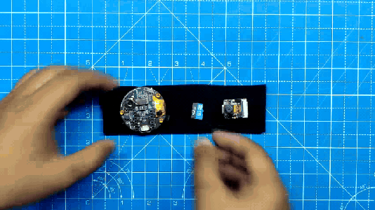

These were the materials used in this project:
  • XIAO ROUND DISPLAY
  • XIAO ESP32 S3 Sense Board
  • 3D-printed parts
  • SD Card
  • Small LiPo Cell, 3.7V, 50mAh

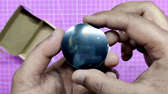

Step 1: XIAO ROUND DISPLAY

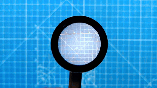

For this project, we're using the Seeed Studio Round Display for XIAO.
Seeed Studio Round Display for XIAO is an extension board with capacitive touch screen and is compatible with all XIAO development boards. It features a fully covered touch screen on one side, designed as a radiant disc with a radius of 39 mm.
With a 1.28-inch circular touch screen that has a resolution of 240 x 240 pixels and 65K colors, this board presents an exhibition of clear and colorful images. It can be applied to design a programmable watch, wearable indicator, etc.
The high integration and rich peripherals on the other side of the XIAO extension board are impressive, with an onboard RTC, TF card slot, battery charging chip, and JST 1.25 battery interface, all within a compact 39 x 39mm size. That is, you can have reliable timekeeping, a way to extend memory up to 32GB FAT, a charging method by the lithium battery.
The pins for Seeed Studio XIAO are all led out and no soldering is needed, which offers a convenient development experience. With its mini size, the XIAO extension board is ideal for wearable and small-volume projects. It is a versatile and powerful extension board that can be used for a wide range of projects, from displaying sensor data to creating interactive interfaces.

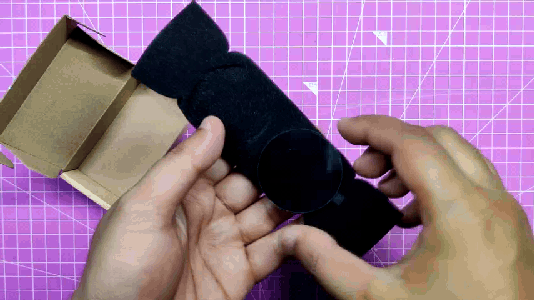

Step 2: XIAO ESP32 S3 Sense Board
The Seeed Studio XIAO Series is a tiny development board with a thumb-sized size and a comparable hardware design.
We're using the XIAO ESP32 S3 Sense board that integrates a camera sensor, digital microphone, and SD card support. Combining embedded ML computing power and photography capability, this development board can be a great tool to get started with intelligent voice and vision AI.
Here, the ESP32S3 32-bit, dual-core Xtensa processor chip operating up to 240 MHz is being used in the XIAO.
Furthermore, there is a detachable OV2640 camera sensor for 1600x1200 resolution, which is compatible with the OV5640 camera sensor and includes an additional digital microphone.
The onboard lithium battery charge management setup enables four power consumption models, including deep sleep mode, with power consumption as low as 14 μA.

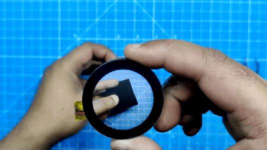

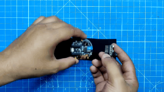

Step 3: Modification

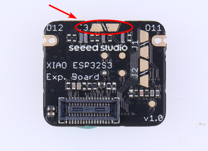

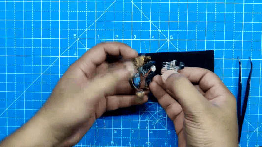

The XIAO EPS32S3 Sense is designed with three pull-up resistors (R4~R6) connected to the SD card slot, and the round display also has pull-up resistors;
The issue here is that the SD card cannot be read when both are used at the same time. To rectify this issue, we need to cut off J3 on the XIAO ESP32S3 Sense expansion board.
After disconnecting J3, the SD card slot on the XIAO ESP32S3 Sense will not work properly, so you need to insert a microSD card into the SD card slot on the Round Display.

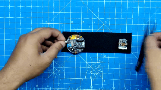

Step 5: Power Source
The power source for this project is a super small 3.7V 50mAh LiPo Cell, which powers both the XIAO Round display and the XIAO ESP32 Sense.
We were able to create a more compact design by employing a tiny LiPo cell.
However, because the LiPo cell we are using has a capacity of 50 mAh, the backup we get is only enough for 10–15 minutes of work, but this can be increased by adding a 100 mAh or 200 mAh cell.
  • For use with XIAO, we have added a small JST connector with the LiPo cell's positive and negative terminals provided on PCM.
  • The JST connector allowed us to connect the LiPo cell directly to the round screen's battery port.
  • We then put back the XIAO board, and the electronics assembly was completed.

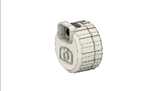

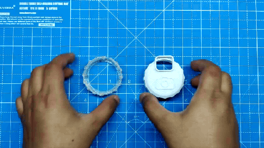

Step 6: Enclosure Design

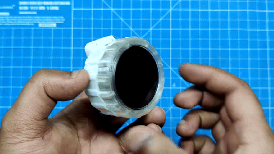

For the enclosure, we created a model of a round display attached to XIAO in Fusion 360 and then constructed an enclosure around it.
The idea was to create a cylindrical-shaped enclosure that was divided into two parts: one to hold the screen in place and the other to serve as a cover.
we added grip all around both parts to make the parts easy to hold.
On the front cover, we modeled a camera icon for aesthetic purposes to make the design look attractive.
After completing the model, we exported each part as a mesh file and 3D printed the back part using transparent PLA and the front cover with white Marbel PLA.

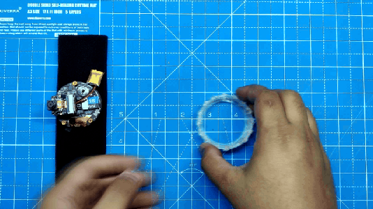

Step 7: Assembly Process

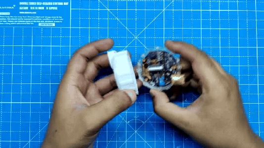

  • We begin the main assembly by installing the XIAO Round Display and XIAO ESP32 Sense Board inside the Back Enclosure Part. The round display fits perfectly in its place.
  • Next, we connected the front enclosure to the back enclosure part, and they both fit perfectly together thanks to the tolerance we gave between them, allowing both parts to press fit together.
The assembly is now complete.

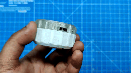

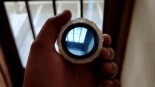

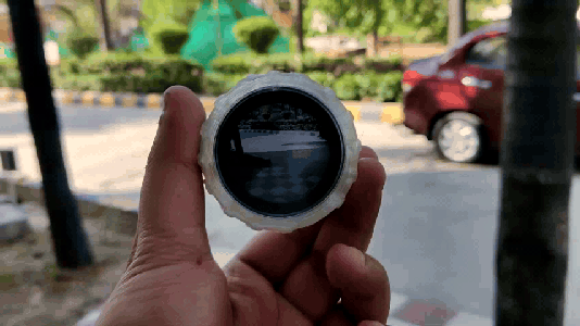

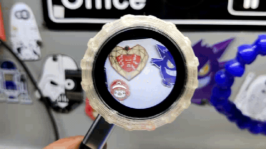

Step 8: Result

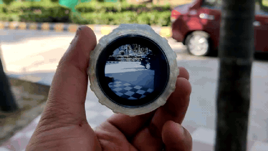

Here's the result of this small build: a working point-and-shoot camera being driven by an ESP32 microcontroller. How cool is that?!.
To turn on the camera, flip on the SMD Slide switch on the Round Display.
By tapping the screen, we are able to save images to the SD card.
Overall, the project was a success. I am pretty happy with the results.
