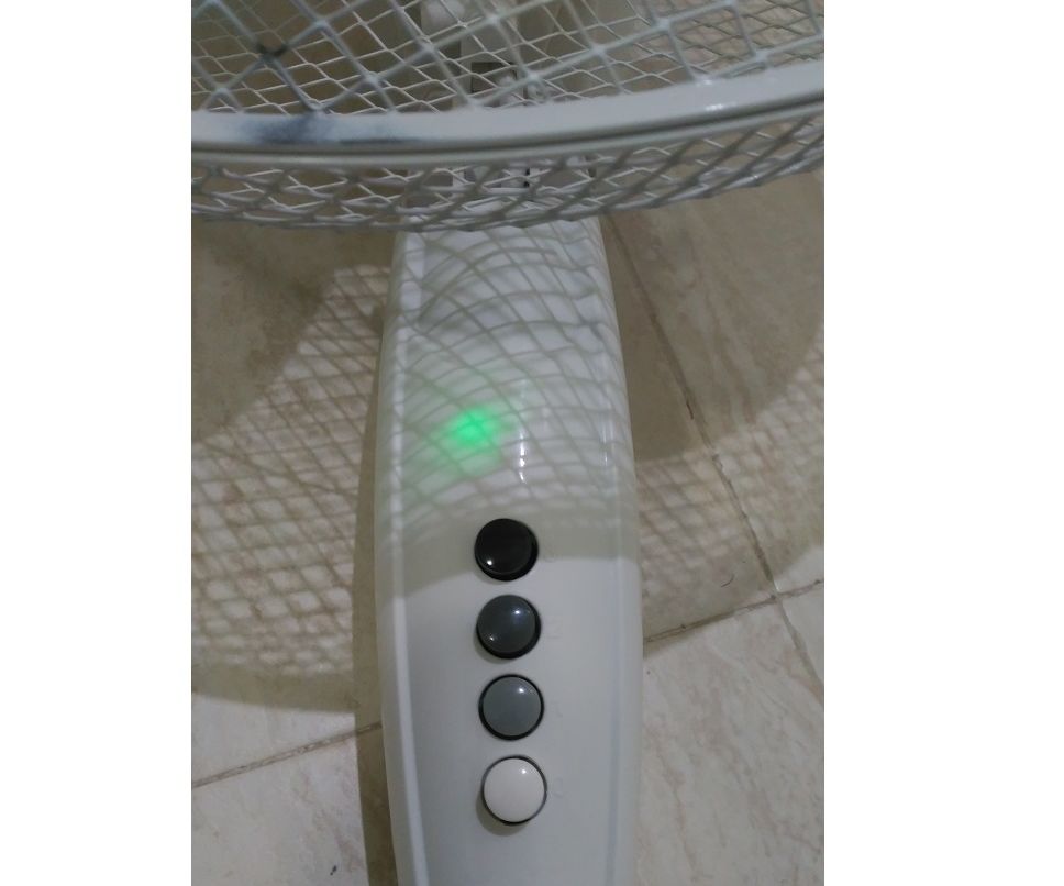

Step 5: Manual Button
For a manual override button, I removed the original switching gear and pulled off the plastic buttons. I then glued the three speed buttons in place on the casing and replaced the off button with a new 3D printed one. The ´holder´ has a small microswitch inserted that the button presses against. The microswitch is in turn connected to the GND and another GPIO of the ESP8266 to act as a simple input to switch on/off/change speed.
Step 6: Control
The ESP8266 has an ESPHome sketch uploaded to it that allows control via Home Assistant and the manual button. See the Github page below for details of that part of the project.
