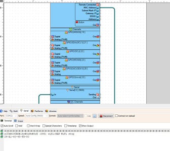

  1. Start Visuino as shown in the first picture Click on the "Tools" button on the Arduino component (Picture 1) in Visuino When the dialog appears, select "M5 Stack ATOM Lite" or "M5 Stack ATOM MatrixOr any other ESP board that you use.

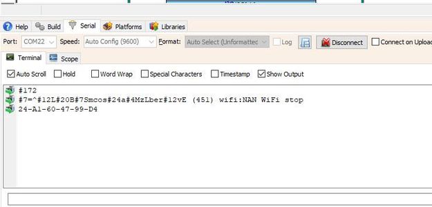

  1. Connect pin MAC Address to Serial Pin [0] as on (Picture 2)
  2. In Visuino, at the bottom click on the "Build" Tab, make sure the correct port is selected, then click on the "Compile/Build and Upload" button.
  3. Then click on the "Serial" Tab and click on the button "Connect"
  4. You should see the MAC Address as on (Picture 3) or (Picture 4), In case you do not see it, click the "Reset" button on the ESP Board
  5. Copy the MAC Addresses to your Notepad as you will need them later

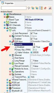

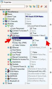

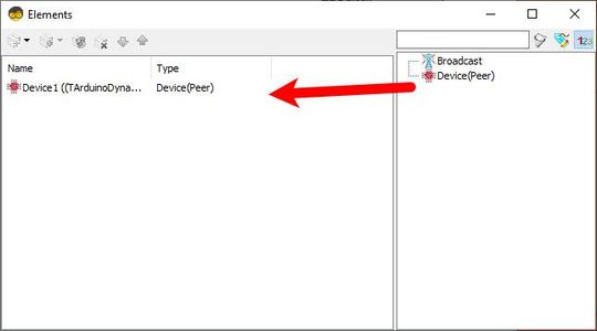

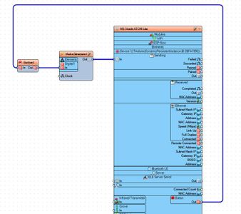

  1. Select the "M5 Stack ATOM Lite" board and in the Properties window extend Modules>WiFi>ESP-NOW>Elements and click on the 3 dots Button

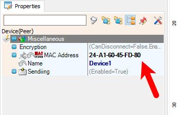

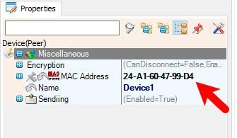

  2. In the Elements window Drag "Device(Peer)" to the Left side and in the Properties window paste the MAC Address of the other Board in our case M5 Stack ATOM Matrix
  3. Close the Elements Window

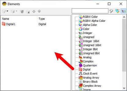

  3. Double click on the "MakeStructure1" and in the Elements window Drag "Digital" to the Left side
  4. Close the Elements Window
  1. Connect "M5 Stack ATOM Lite" > "Button" Pin [Out] to "Button1" Pin [In]
  2. Connect "Button1" Pin [Out] to "MakeStructure1" > "Digital1" Pin [In]
  3. Connect "MakeStructure1" Pin [Out] to "M5 Stack ATOM Lite" Pin [Sending]

  1. Select the "M5 Stack ATOM Matrix" board and in the Properties window extend Modules>WiFi>ESP-NOW>Elements and click on the 3 dots Button
  2. In the Elements window Drag "Device(Peer)" to the Left side and in the Properties window paste the MAC Address of the other Board in our case M5 Stack ATOM Lite

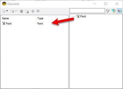

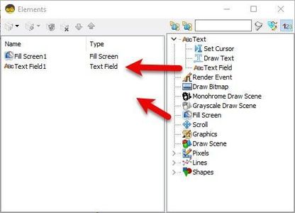

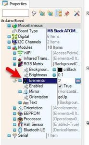

  1. Select "M5 Stack ATOM Matrix" board and in the properties window expand "Modules">"RGB Matrix">"Elements" and click on the 3 dots button
  2. In the "Elements" window drag "Fill Screen" to the left side

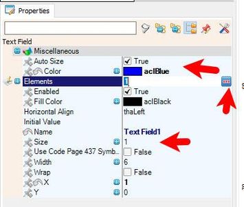

  3. In the "Elements" window drag "Text Field" to the left side, and in the properties window set "Color" to aclBlue and "X" to 1, select "Elements" and click on the 3 dots button, In the "Elements" window drag "Font" to the left side and in the properties window set "Font" to Adafruit\Picopixel
  4. Close both "Elements" window

  2. Double click on the "SplitStructure1" and in the Elements window Drag "Digital" to the Left side

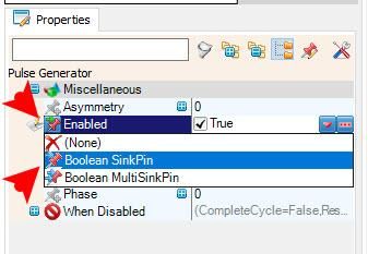

  7. Select "PulseGenerator1" and in the properties window select "Enabled", click on the pin Icon and select "Boolean SinkPin"

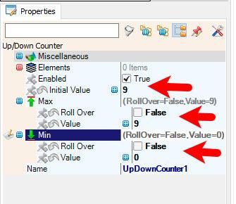

  8. Add "Up/Down Counter" component
  9. Select "UpDownCounter1" and in the properties window set "Initial Value" to 9, "Max" > "Roll Over" to False and "Max" > "Value" to 9, "Min" > "Roll Over" to False and "Min" > "Value" to 0

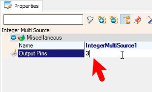

  10. Add "Integer Multi Source" component
  11. Select "IntegerMultiSource1" and in the properties window set "Output Pins" to 3

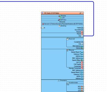

  1. Connect "M5 Stack ATOM Matrix" > "Sending" Pin [Out] to "SplitStructure1" Pin [In]
  2. Connect "SplitStructure1" > "Digital1" Pin [Out] to "MultiSource1" Pin [In]
  3. Connect "MultiSource1" Pin [0] to "UpDownCounter1" Pin [Reset]
  4. Connect "MultiSource1" Pin [1] to "TFlipFlop1" Pin [Set]
  5. Connect "TFlipFlop1" pin [Out] to "PulseGenerator1" Pin [Enabled]
  6. Connect "PulseGenerator1" Pin [Out] to "UpDownCounter1" Pin [Down]
  7. Connect "UpDownCounter1" Pin [Min Reached] to "TFlipFlop1" pin [Reset]
  8. Connect "UpDownCounter1" Pin [Out] to "IntegerMultiSource1" Pin [In]
  9. Connect "IntegerMultiSource1" Pin [0] M5 Stack ATOM Matrix > "Fill Screen1" Pin [Clock]
  10. Connect "IntegerMultiSource1" Pin [1] M5 Stack ATOM Matrix > "Text Field1" Pin [In]
  11. Connect "IntegerMultiSource1" Pin [2] M5 Stack ATOM Matrix > "Text Field1" Pin [Clock]
