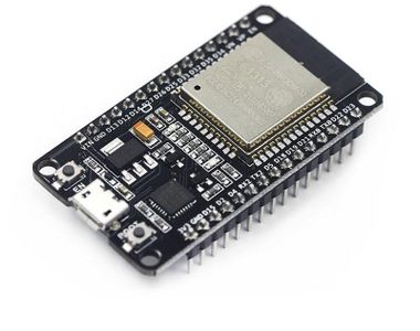

  • 2X ESP32 or ESP8266 (It can be any ESP board)

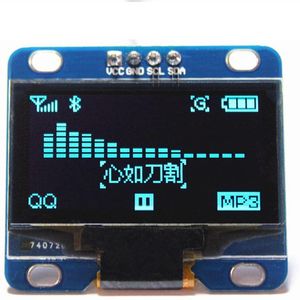

  • OLED Display

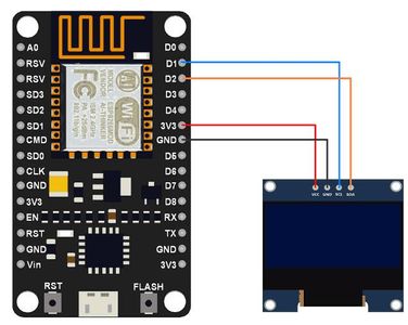

Step 3: The Circuit

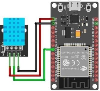

ESP32:
  • Connect DHT11 VCC pin to the 5V output on the ESP32 and connect GND to ground.
  • Connect DHT11 PIN S (Signal) to ESP32 Pin GPIO 5

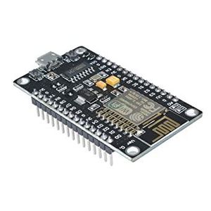

NodeMCU:
  • Connections are fairly simple. Start by connecting VCC pin to the 3.3V output on the NodeMCU and connect GND to ground.
  • Connect the OLED SCL pin to the I2C clock D1 pin on your NodeMCU and connect the OLED SDA pin to the I2C data D2 pin on your NodeMCU.

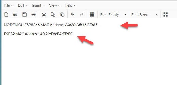

Step 4: Getting the MAC Address
The Visuino: https://www.visuino.eu also needs to be installed. Download Free version or register for a Free Trial.
Repeat this step for both ESP boards:

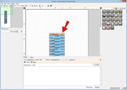

  • Start Visuino as shown in the first picture Click on the "Tools" button on the Arduino component (Picture 1) in Visuino When the dialog appears, select "ESP32" or "NODEMCU" Or any other ESP board that you use.
  • Connect pin MAC Address to Serial Pin [0] as on (Picture 2)
  • In Visuino, at the bottom click on the "Build" Tab, make sure the correct port is selected, then click on the "Compile/Build and Upload" button.
  • Then click on the "Serial" Tab and click on the button "Connect"

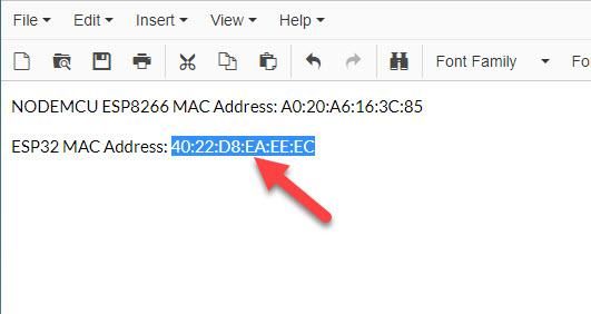

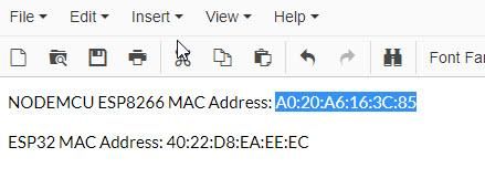

  • You should see the MAC Address as on (Picture 3), In case you do not see it, click the "Reset" button on the ESP Board
  • Copy the MAC Address to your Notepad as on (Picture 4)

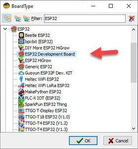

Start Visuino as shown in the first picture Click on the "Tools" button on the Arduino component (Picture 1) in Visuino When the dialog appears, select "ESP32" as shown on Picture 2
Step 6: For Sender ESP32 - in Visuino Add, Set & Connect Components

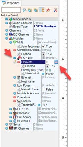

  • Select the "ESP32 Development Board" board and in the Properties window extend Modules>WiFi>ESP-NOW>Elements and click on the 3 dots Button

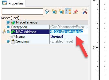

  • In the Elements window Drag "Device(Peer)" to the Left side and in the Properties window paste the MAC Address of the other Board in our case NODEMCU
  • Close the Elements Window

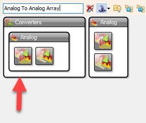

  • Add "Packet" component
  • Add "DHT11" component
  • Add "Analog To Analog Array" component

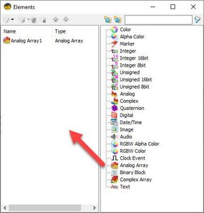

  • Double click on the "Packet1" and in the Elements window Drag "Analog Array" to the Left side

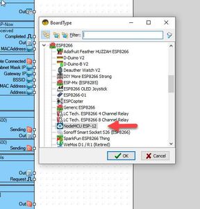

Step 7: Receiver NODEMCU : Start Visuino, and Select the NODEMCU Board Type
Start Visuino as shown in the first picture Click on the "Tools" button on the Arduino component (Picture 1) in Visuino When the dialog appears, select "NodeMCU ESP-12" as shown on Picture 2

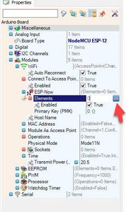

  • Select the "NodeMCU ESP-12" board and in the Properties window extend Modules>WiFi>ESP-NOW>Elements and click on the 3 dots Button
  • In the Elements window Drag "Device(Peer)" to the Left side and in the Properties window paste the MAC Address of the other Board in our case ESP32

  • Double click on the "UNPacket1" and in the Elements window Drag "Analog Array" to the Left side

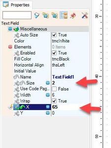

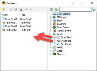

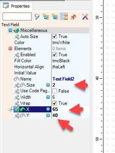

  • Double click on the "DisplayOLED1" and in the Elements window Drag "DrawText" to the Left side & in the Properties window set "Text" to TEMP and "Size" to 2
  • In the Elements window Drag "Text Field" to the Left side & in the Properties window set "Size" to 2, "X" to 65

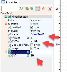

  • In the Elements window Drag "DrawText" to the Left side & in the Properties window set "Text" to HUM and "Size" to 2, "Y" to 40
  • In the Elements window Drag "Text Field" to the Left side & in the Properties window set "Size" to 2, "X" to 65 and "Y" to 40

If you power the ESP modules, you should start to see on the OLED Display the Temperature & Humidity received from the other ESP board.
