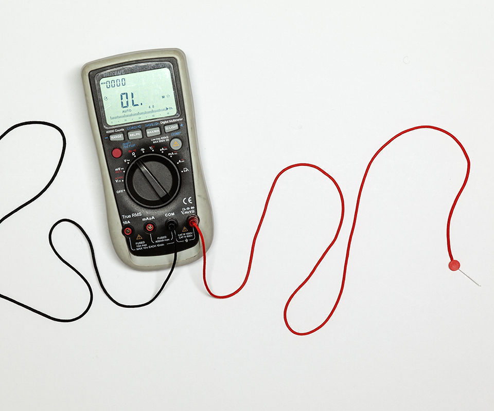

The Connectable Needlework Tools allow connecting a standard needlework tool like a seam ripper or crochet hook to the multimeter.
In eTextile work, this allows to observer the changes of electric qualities directly while working on the eTextile artefact. This instructable shows the making of a Connectable Seam Ripper. I use a standard seam ripper and a custom 3D printed handle to make the seam ripper connectable to a mini banana plug. You can use the handle also to mount another tip.

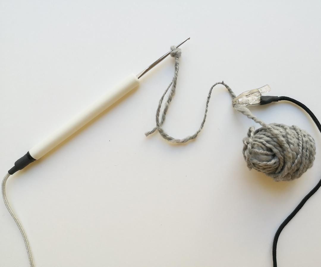

How to transform a standard metal crochet hook into a Connectable Crochet Hook is described here.

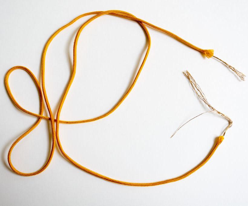

You can now connect the Connectable Seam Ripper e.g. to a multimeter via a Textile Cable with a Mini Banana Plug at the end. (You can get instructions on how to connect a Banana Plug here.)
