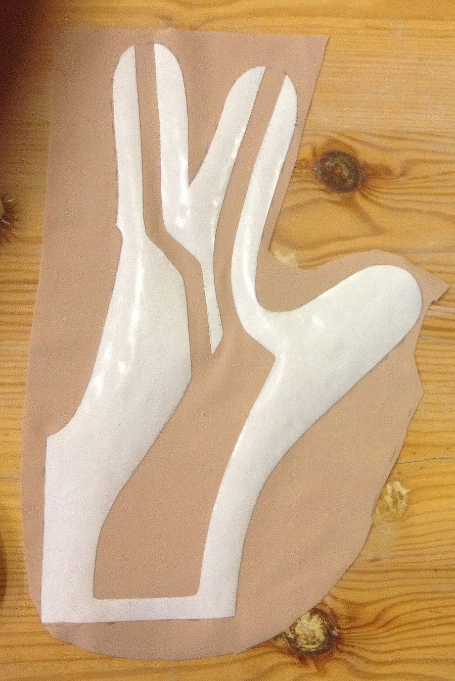

Step 3: Bonding the Circuit
This design uses layers super thin bonded fabric. it has channels missing where the circuit is placed. This isolates and protects the circuit. I do not bond the fabric where there is a circuit to minimise stiffness from too many layers.
Prepare and cut your bonding material. This pattern piece is the mirror image of the single pattern piece.
Bonding for the glove:
Place the bonding pattern piece onto the bonding material, glue side down, draw around it and and cut it out. This will be fused to the wrong side of the single glove pattern piece. In the finished glove it will sit underneath the mirrored glove pattern. I will make the circuit on the wrong side of the fabric and sandwich in underneath the mirrored upper glove.
Iron the bonding on to the fabric, lining it up to the drawing of the single pattern piece. Do not remove the backing paper yet!
