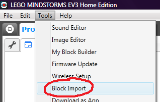

Start the LEGO MINDSTORMS EV3 software and create a new, empty project. Select the Tools menu and then Block Import.
  1. In the Block Import and Export dialog, select Browse.
  2. Find the file coloursensorRGB-v1.00.ev3b on your computer and Open it.
  3. Select coloursensorRGB-v1.00.ev3b from Select Blocks to Import and then select Import.
  4. To complete the installation, close the dialogues and exit from LEGO MINDSTORMS EV3 software.

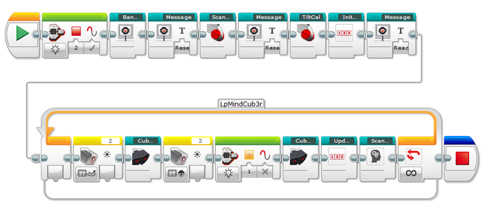

  3. Start the LEGO MINDSTORMS EV3 software and select the File menu then Open Project.
  4. Find the MindCub3r-v1p4.ev3 project file and Open it.
  5. Download the MindCub3r program to the EV3 (but do not runit yet).
  6. Select the Tools menu and then Memory Browser.
  7. Select Brick (or SD Card if there is a micro-SD card in the EV3) and find and select MindCub3r-v1p4 in the Projects folder and then select Download.
  8. Find the folder on the computer where the files were extracted from MindCub3r-v1p4.zip. Select mc3solver-v1p4.rtf and Open to download this program to the EV3.
  9. Select Download again from the Memory Browser dialog.
  10. Find the folder on the computer where the files were extracted from MindCub3r-v1p4.zip. Select InstallMC3-v1p4.rbf and Open to download this file to the EV3.
  11. Close the Memory Browser dialogue.
