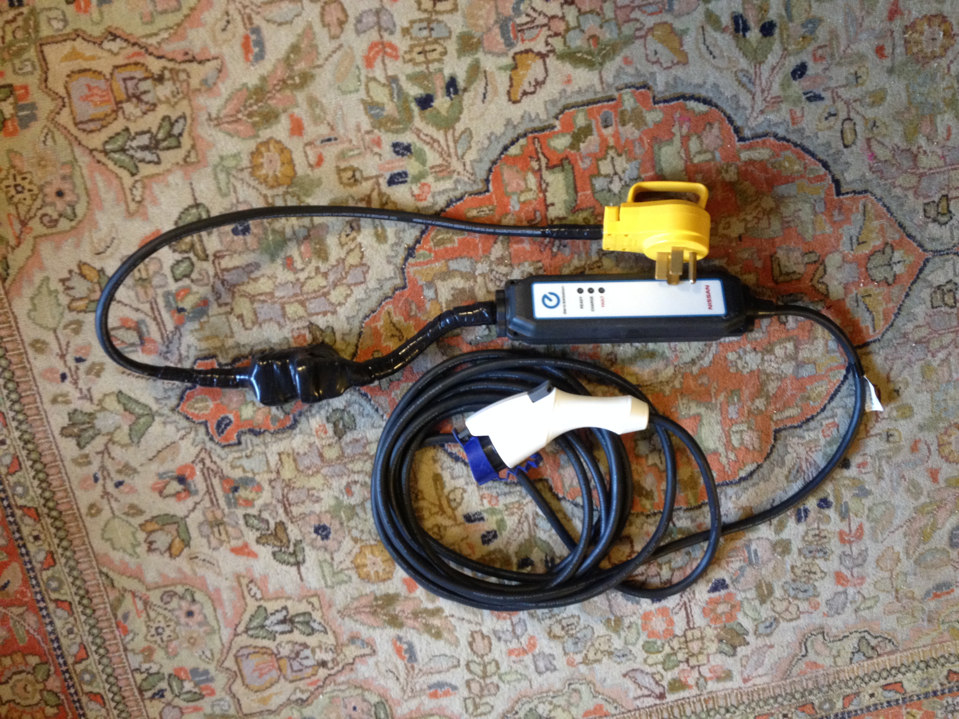

Introduction: (1.0)EVSE: CONVERTING a LEVEL 1 (12AMP) TO a LEVEL 2 (12 AMP) (Take a Look at 2.0)
This design is a little awkward to use, but my intent was to make a small, simple, portable level 2 charger out of a level 1 charger for the occasional use on the road. I have made a number of designs which are more user friendly but are not as electronically simple. And I will be posting some of them soon. In fact another one is up take a look at the other one that I posted, it is a better design, the 2.0. So on to the warning.

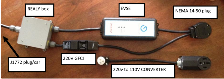

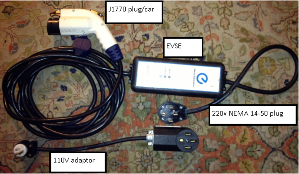

Connect the NEMA 14-50(NEMA 14-50 because it's the 220v plug that campgrounds uses, but any 220v plug rated at 15 amp or better plug will work) to a 220v GFIC. (Note: I removed the extra prong from the 220v plug because it it's not doing anything in this circuit) It will look under wired but remember you are only pulling 12 amps. I used the rubber grommet from a tension relief so that the plug would grab the small cord.
Step 3: Connecting It,,,
Connect GFIC into top of waterproof out box, a with tension relief. Cut the EVSE cable about a foot after the control box. Connect EVSE box out cord into the top of waterproof out box, a with tension relief. Connect J1772 cable into bottom of waterproof out box, a with tension relief.
Connect blue(control) wire to blue wire (use meter to make sure blue wire is connected to pin #4 on J1772) Connect all of the grounds tougher and ground the box and switch. (Or you could use a PVC box with waterproof switch and PVC tension relief then you simply need to Connect all of the grounds tougher.)
Step 4: And Yet, More Connecting,,,
Connect black and white wires from J1772 to the center prongs (Common). Connect black and white wires from the 220v out side of the GFCI to one end of the switch. All of the black wires should be on the one side of the switch and all of the white wires should be on the other side of the switch.
Connect black and white wires from the 110v out of the EVSE to one end of the switch. All of the black wires should be on the one side of the switch and all of the white wires should be on the other side of the switch.
Step 5: Marking Your Switch!
Mark the outside of the box so you know which side is 110v and which side is 220v.
Step 6: To Operate: 110v Mode.
For 110v operation, throw the switch to the 110v side and uses as you always have.
Step 7: To Operate: 220v Mode.
For 220v operation put the switch in the neutral center off position and plug in both the 110v and the 220v plugs into the wall outlets. Then plug the J1772 plug into the car and wait for the “charge” light on the EVSE to come on, at this point throw the switch to the 220v position. It gives you a 5 second window to throw the switch (do not trip and fall running to the switch this is plenty of time to get to the switch and throw it), if you fail to throw the switch in this time frame you simply need return the switch to the off position, unplug the J1772 from the car and plug back in to the car wait for the “charge” light to come on and throw the switch back to 220v position again.(If you turn it on and then plug it in you will be handling a 220V extension Cords. This is more dangerous than an 110V extension Cords, so don’t do it.) (Boaters and campers do it seam to do it without any problem but that’s beside the point.) Nothing bad has happened. You will however see a yellow warning light “!” on your dash the next time you start your car. This is to let you know that there was a problem with the last charge. To get this warning light to turn off, you turn off your car and turn it back on and the light will be off
