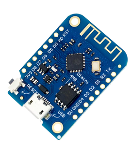

Programing the D1 Mini
  1. Create a new device in your ESPHome.
  2. Past the code attached, review the config and adjust according to your ESPHome configuration.
  3. Connect the ESPModule to the computer and program it.
  4. Check that your device is accessible on your network by pressing the Visit button .

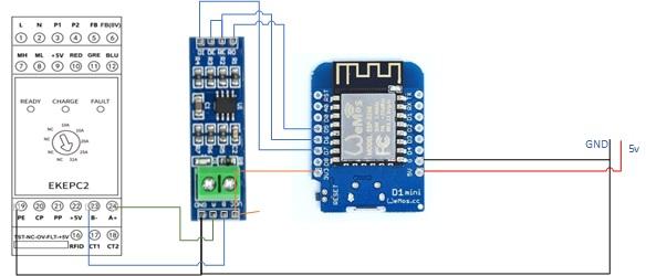

Step 2:
Connect the parts acording to the diagram.

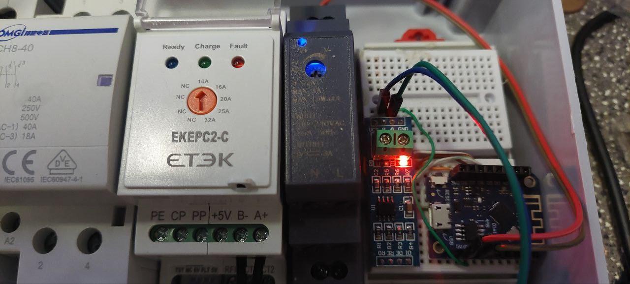

Step 3:
Supply the 5V to the D1 Mini and check that the device is visible in your wifi network. The webpage of the device should appear with all the values that depend of the ETEK show as NA.
Step 4:
Supplying power to the controller.
  1. If you have no experience with mains power, please do not proceed. Contact a professional electrician for advice / help !
  2. Connect a cable with a plug to the ETEK controller.
  3. Connect the plug to the socket. After this moment there is live power in the controller, please take the care to not get electrocuted.
  4. The controller should light up and do the initialization.
  5. After the initialization, the connection between the D1 and the ETEK should work.
  6. Check that the values in the webpage changed.

  1. By default, the ETEK arrives modbus_controller ID configured as 255. I've changed it to 5. If you have problems communicating with the controller, please contact me, so we can see if there is anything we need to change in this intructions.I'm trying to get a set of instruction on how to do this.

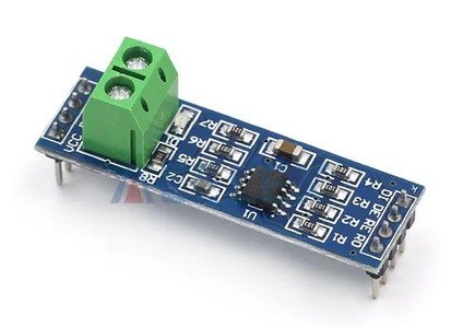

  2. The rs485 to rs232 converter tends to overheat when it’s supplied with 5 V. Because of this I’m borrowing 3V from the D1. Don’t know if it’s a good idea in long terms.
  3. I did not connect the PE (Power Earth) from the ETEK controller to the RS485 and did not place a resistor on the RS485 line. For me its working but it could be an issue.
  4. There is some confusion on the baud rate of the ETEK 9600 its working fine for me.
  5. The controller is supplying the car without any problems I'm able to get the state of the controller and remotely start stop it without any issues.
