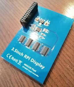

Step 1: Parts Required
  • Raspberry PI zero w
  • Servo SG90 (x4)
  • Servo MG995 – standard (x2)
  • PCA9685 16-Channel Servo Driver
  • USB Sound card
  • Microphone
  • Speaker
  • Male and female pin header connectors
  • GPIO screen for PI 3.5"

Step 5: Electronic Wiring
Connecting the PI to the GPIO screen.
Your PI will be located in the bottom of the robot and the screen connector is in the top of the head. So you can use 30 cm male/female dupont cable to connect it together.
The cables will go from the GPIO screen connector (pic 1) to the hole in the neck of the robot (pic 2), then it will cross the 2 horizontal discs separating head and body (pic 3).
For the wiring, check the numbers in the picture of pi zero pinout. On the screen side, the number are not written, but it is pretty obvious: if you connect the screen to the PI directly, pin1 -> pin1, pin2 -> pin2, etc...
The wiring is in the attache excel tab.
