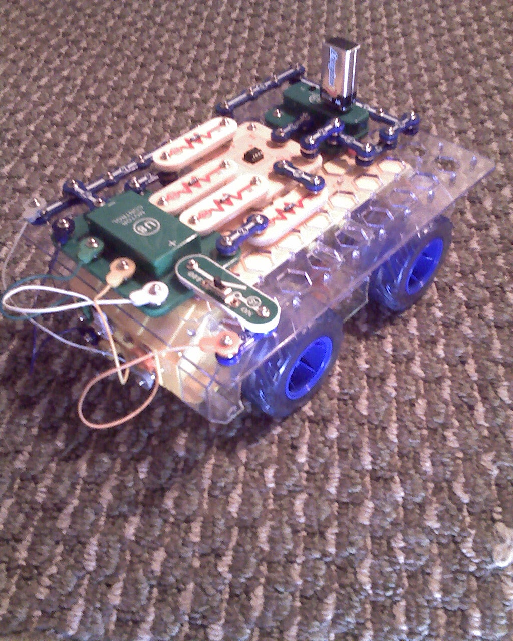

To build the programmable Snap Circuits robot, I used parts from three different sets, the Snap Circuits Motion Detector, Snap Circuits Rover, and Snap Circuits Micro. Elenco does not currently have a Snap Circuits programmable robot product. I find this surprising since Elenco has developed the Snap Circuits Rover, which is a remote controlled rover and the Snap Circuits Micro that teaches you how program the PICAXE microcontroller and how to build circuits for the PICAXE, but Elenco has yet to develop a product that combines the PICAXE with the Snap Circuits Rover.
I designed the robot to be easy to build completely out of Snap Circuits parts and easy to program to inspire folks from 8 to 80 to get interested in robotics.

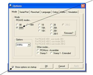

Step 2: Installing the PICAXE Programming Editor (continued)
Insert the Snap Circuits USB Programming Cable into an empty USB port on your computer. Click on the PICAXE Programming Editor icon on your desktop to open the editor.
Step 3: Installing the PICAXE Programming Editor (continued)
The Options dialog will automatically open (if the “Show options on startup” check box is checked). If it does not, go to View > Options. On the Mode tab, select 08M--this is your PICAXE microcontroller.

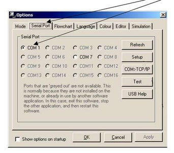

Step 4:
Click on the Serial Port tab and select the COM port where your USB Programming Cable is connected. Click the Ok button to go to the programming editor. In the Programming editor click File and then click New Flowchart to start entering your flowchart.

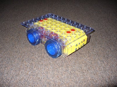

Step 7: Snap Circuits Rover
Now that you have installed the PICAXE Programming Editor and learned how to write a simple program, its time to starte building your robot. There are three basic parts that you need to build a robot: a power source, a brain (the PICAXE of course) and a means of locomotion.
The Snap Circuits Rover is one example of locomotion. It has advantages and disadvantages.
Advantages:
It is a ready-made vehicle. In other words, you don't have to build a vehilce--it is already built for you.
It has two motors, one on the right side and one on the left side. Each motor is connected to the front and rear wheels by a series of geers (the geering was added in to slow the Rover down rather than a need for extra torque) so that the right motor turns the right front and rear wheels, and the left motor turns the the left front and rear wheels. In the first picture You can see the front of the rover as well as the gears that connect the left side wheels to the left side motor.
It is designed to have the Snap Circuits base plate connected directly to it. It is also designed so that power and motor control are easily connected with Snap Circuits jumper wires. In the second picture you can see the base plate attached. You can also see the snaps on the rear of the rover. The third picture explains the function of each snap.
It has a battery compartment for six AA batteries to power the motors with 9 volts.
Disanvantages:
It is not designed to have attachments such a robotic grabber arm attached to it.
You must be careful to design your circuit so that you do not accidently pass the 9 volts from the rover's battery pack through the PICAXE microcontroller since this will most likely damage the PICAXE.

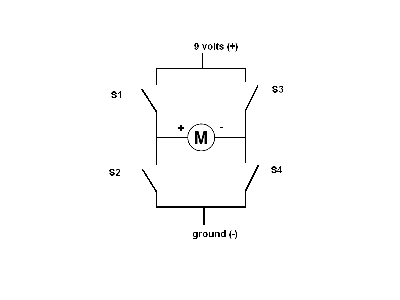

Step 9: The H-bridge
The first picture is a simplified H-bridge. The motor in the center is connected to 9 volts of power and ground by four switches (S1, S2, S3, and S4). With all four switches off, the motor will not get any power and the motor will not turn. The switches can be turned on in pairs: S1 and S4 or S3 and S2 to allow current to pass from the 9 volt batteries through the motor to negative or ground.
Now take a look at the second picture.
If you close switches S1 and S4, current will flow through the motor and it will turn in one direction.
If you close switches S3 and S2, current will flow through the motor and it will turn in the opposite direction.
The H-bridge is a very simple circuit. Unfortunately it would be impractical to use manual switches to drive a motor. Several companies make H-bridge integrated circuits (ICs) that are easy to use by simply applying power to a particular pin also called "setting the pin high" to drive the motor in one direction. Cutting the power to that pin and applying power to another pin will drive the motor in the opposite direction. The circuitry inside the H-bridge ICs is somewhat complicated, so most folks will choose to use an H-bridge IC rather than building the circuit themselves.
The third picture is the Snap Circuits Motor Control IC, or H-bridge. At the top of the figure you can see the electronic schematic of the Motor Control block. On the lower left you can see a picture of the block. The lower center shows the function of each snap for the block and on the lower right is a description of what each snap does.
Step 10: Build the Robot Circuit
Build the circuit as shown in the diagram. You can also look at the pictures for a step by step build.  Here are the Snap Circuits parts I used:

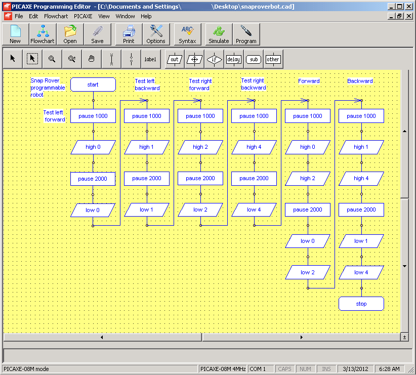

Step 11: Program the Robot
To create a new flowchart, click File and then click New Flowchart. Use my example flowchart to make your own flowchart.
I’ve divided up each function into columns to make the flowchart easier to read. In the first column under “start” are the commands to test the robot’s left forward motor. This will cause the robot to turn right. Under the label “Test left backward” are the commands to turn the robot’s left motor backwards. This will cause the robot to turn left. The next four columns are the commands to test the right motor turning forward and backward, then turn both left and right motors forward (robot rolls forward), and finally turns both motors backwards (robot rolls backwards).
You can also convert the flowchart into BASIC program code. Click Flowchart and then click Convert Flowchart to BASIC. The following is what the code will look like in BASIC (I added the comments in the code to describe what the code does):
